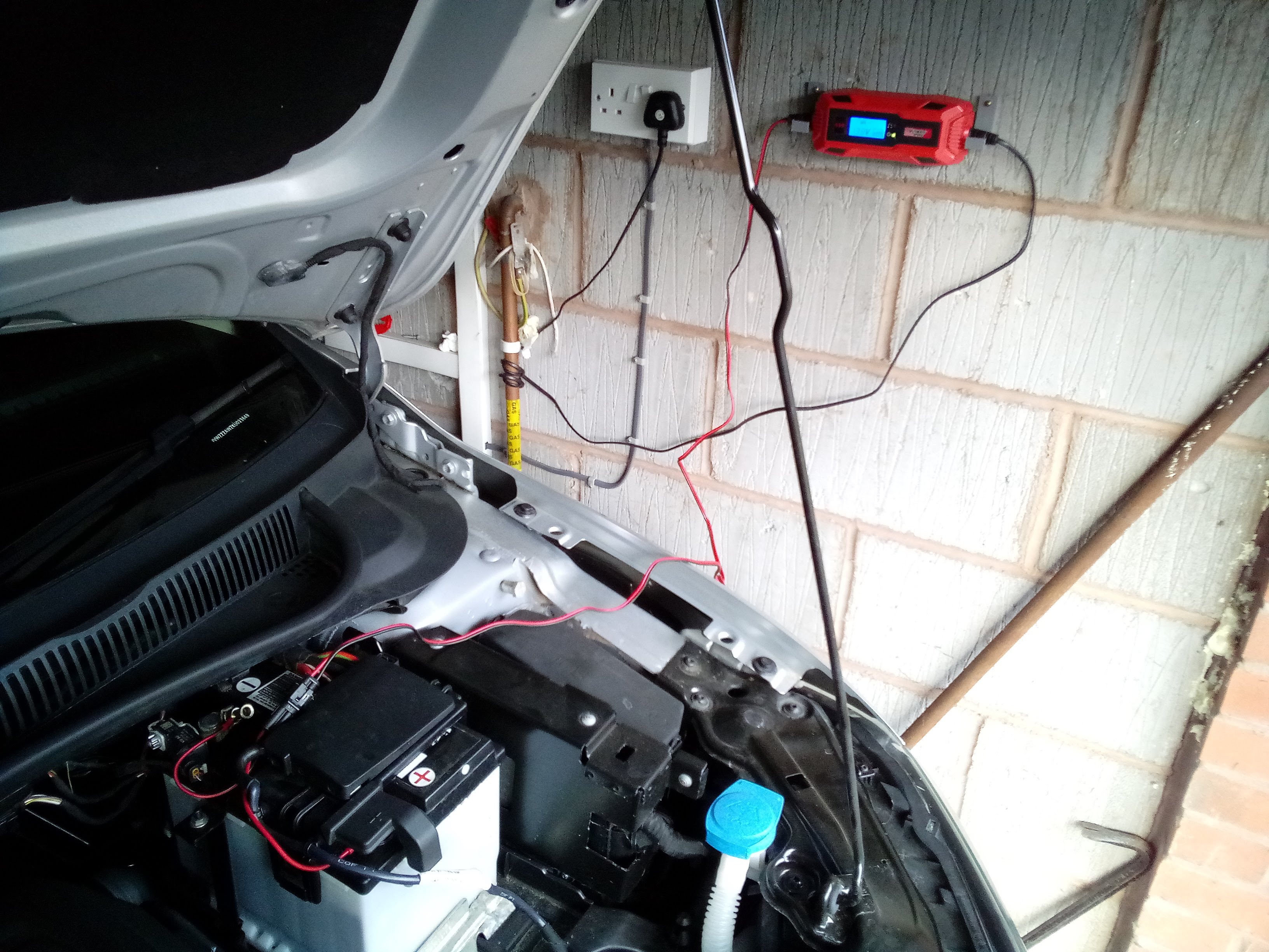

I have always hated the chore a putting the battery charger on.. (I only found recently that it is more necessary if you don't use your vehicle frequently).. With my car and situation, and the way i position the car in it; reversed in - the mains socket is at the back of the garage and I have to get the coiled extension out for the charger .. the battery is on the other side of the car.. wires all over the place to trip over, no switch on the extension so can't leave the charger plugged in the extension whilst connecting the battery connections;

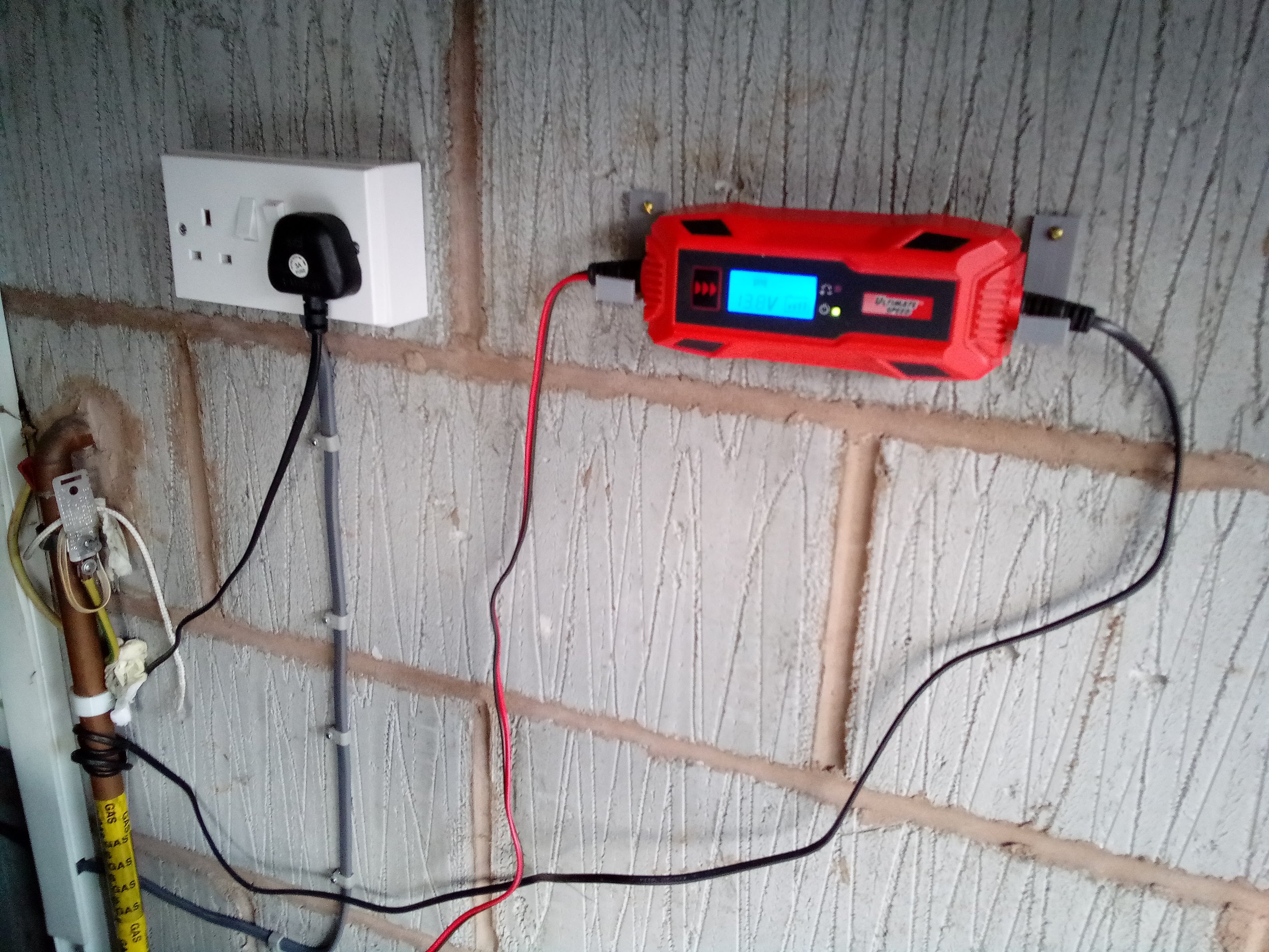

I got rid of some of the battery chore by fitting a remote plug-in connector on the charger and left that fitted to the battery... so I bit the bullet and planned to put in a double gang (switched) socket towards the front of the garage and on the righthand side, on a surface mounted pattress and printed off some brackets for the charger body to keep the charger (which has no mounting points) higher up with its display at eye level and easily switched on or off at the mains switch.
Now all I have to do is open the bonnet, plug in the quick connector and switch the charger on.. I'd really have liked to have had an external socket in the car body to just plug the charger into.. but i can't see or know of anything suitable/viable cost-wise.
At least I'm more inclined to connect up..

I hope that I'm not seeing that installation correctly, but it does look to me that you are connecting the -VE to the battery -VE post - that wire should be changed to go to the service jump point or another close body earth bond point. VW will or should have made that clear somewhere.

RUM4MO wrote: Wed Sep 08, 2021 11:16 pm I hope that I'm not seeing that installation correctly, but it does look to me that you are connecting the -VE to the battery -VE post - that wire should be changed to go to the service jump point or another close body earth bond point. VW will or should have made that clear somewhere.
I agree. The reason for this is, you're charging around the intelligent battery monitor, the 2-wire plug on your battery negative terminal.
It's better to put the minus somewhere 'downstream' of the negative battery strap. The positive terminal is perfectly fine where it is.

I had bought an accurate volt meter and connected permanently hence I know running voltages; my standing voltages were low. 11.8 which suggested very low charge... My usage is very low due to illness and I had learned.. from this forum.. that a battery standing around with low a charge is no good for a battery so I wanted to make connecting it up easier. My batteries didn't last very long in my previous Polo; but I didn't know about this stuff and was abusing my battery unknowingly.
Charging V is good at 14.5. Over the last two weeks I have found that leaving the battery with this smart charger had improved the standing charge to 12.3v so far.. Just for leaving it connected. The charging when driving stays less at 14.5v so much more now. Seems to indicate a better state of battery. Someone else had the car for over two years before me. Who knows how long it was standing unused?

I already did as you suggested and fitted it under the earth point.. It is a very long thread under that nut!.
I also found that my waterproof connectors did not stand the test of time.. even though I have done a lot of successful crimping of connectors in the past... the cable fell out. Don't think you can get the pins out of the casing once pushed in though.
In the end I sent for some pre-wired SAE connectors.. these are beefy polarised connectors with protective caps and can take a lot of amps if needed

it wasn't a waste of effort wiring up a double gang socket.. I now have more points for electrical tools to be connected at the same time; router, jigsaw etc. It cost me about £12 in 2.5mm twin and earth and £3 for the patress and cable clips.. and an hour of time.
