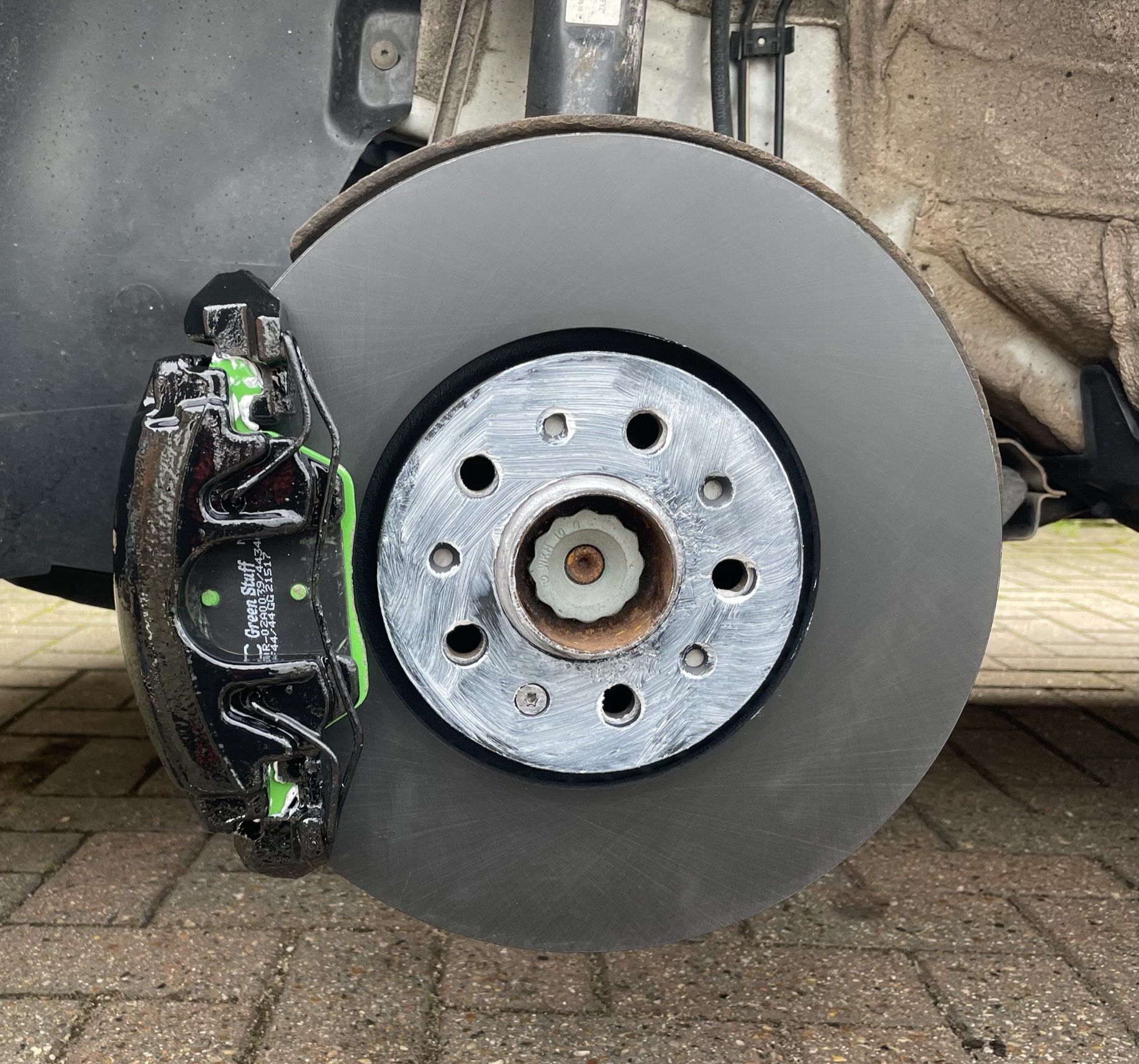

Had a chance to change the discs and pads and give the callipers a quick quote. Very happy with how they have turned out.
Went with EBC OEM discs with greenstuff pads in the end. I’ve had the pads before and liked the performance. I used hammerite in the end for the calliper as the calliper paint was out of stock. I don’t intend on doing any track days/ heavy braking so this should be fine
