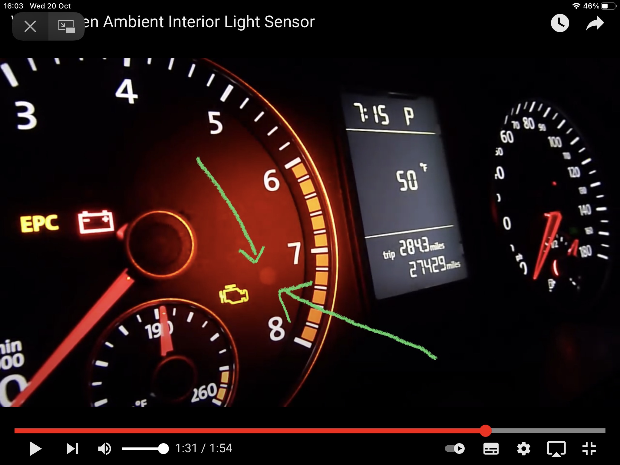

In the previous generation Polo the sensor was integrated into the instrument cluster. I’m assuming it’s also in the instrument cluster on the current Polo - sorry, I can’t check in my car as it doesn’t have the analogue instrument cluster.
In this YouTube video of a VW instrument cluster, it’s near the 7 on the rev counter;
https://www.youtube.com/watch?v=diX0XHYx5AA
I’ve taken a screen shot at 1min 31sec of the video and you can just see it in the area where the green arrows that I’ve added are pointing to;

Posts: 3847
Re: Display dimming randomly
grazuncle2 wrote: Wed Oct 20, 2021 4:16 pm Fantastic!
Be aware that it’s not a current model Polo in the YouTube video as the video is from 2012 which predates the model of Polo you have. So the light sensor in your car may be in a different position.
