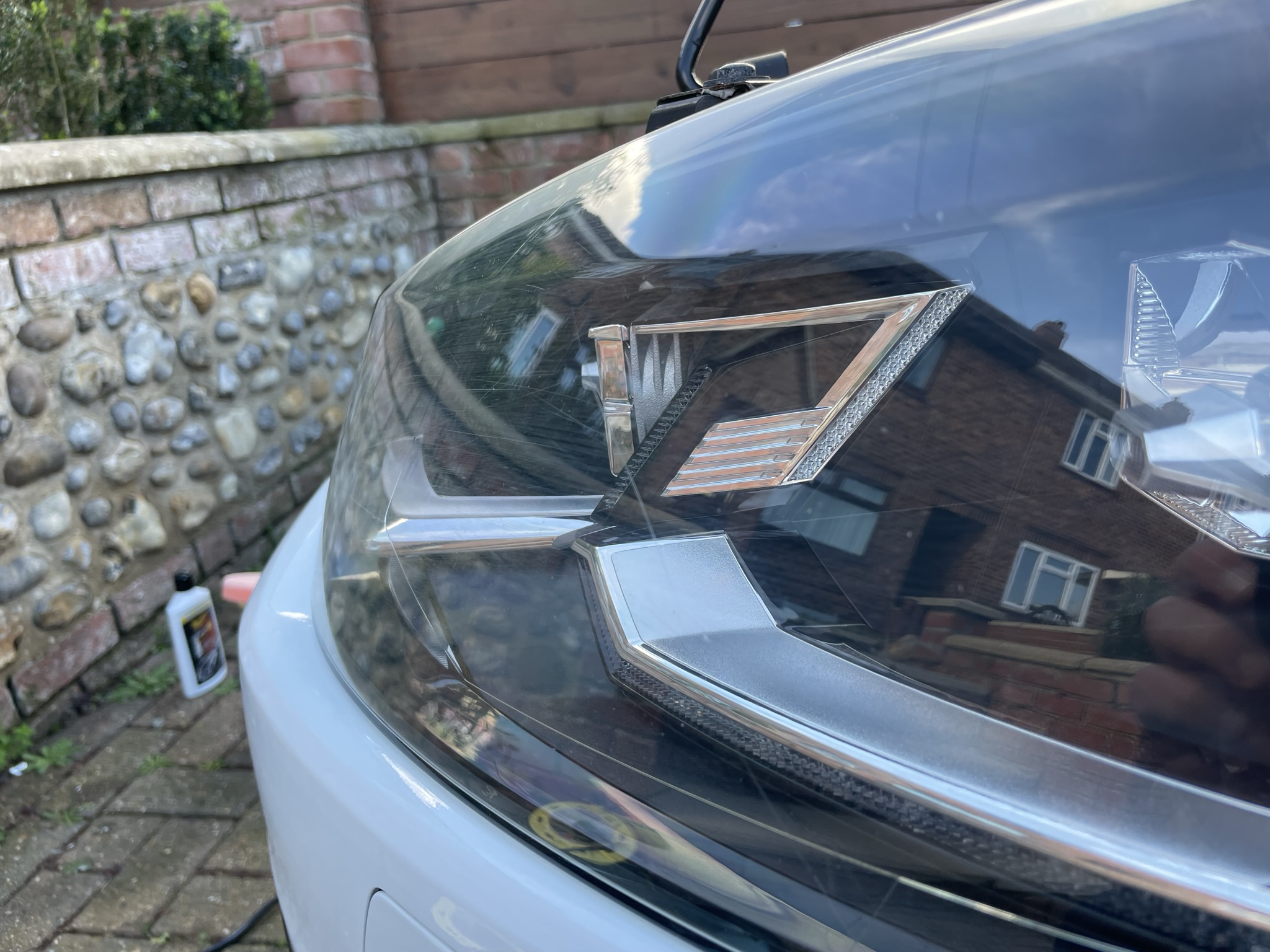

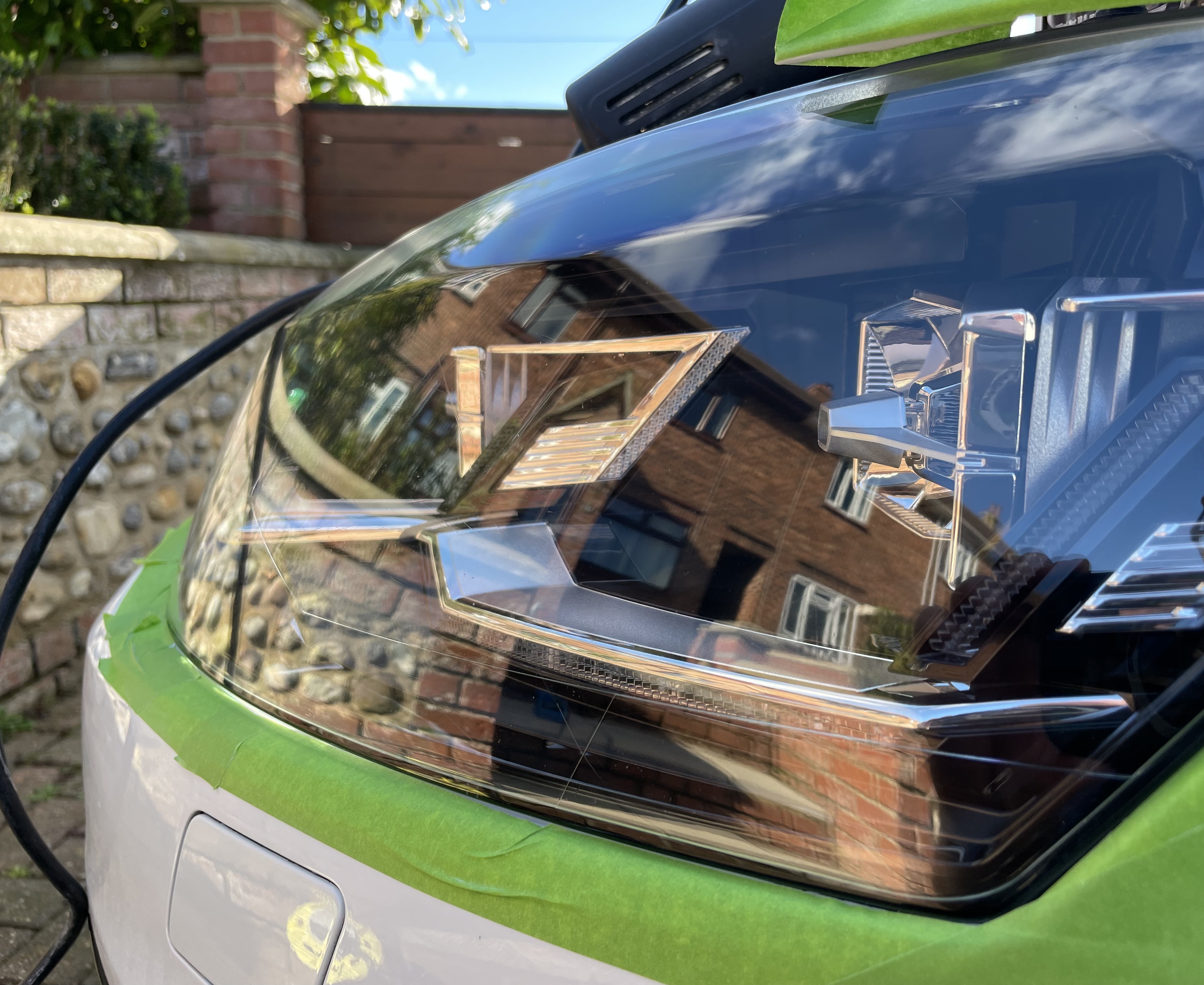

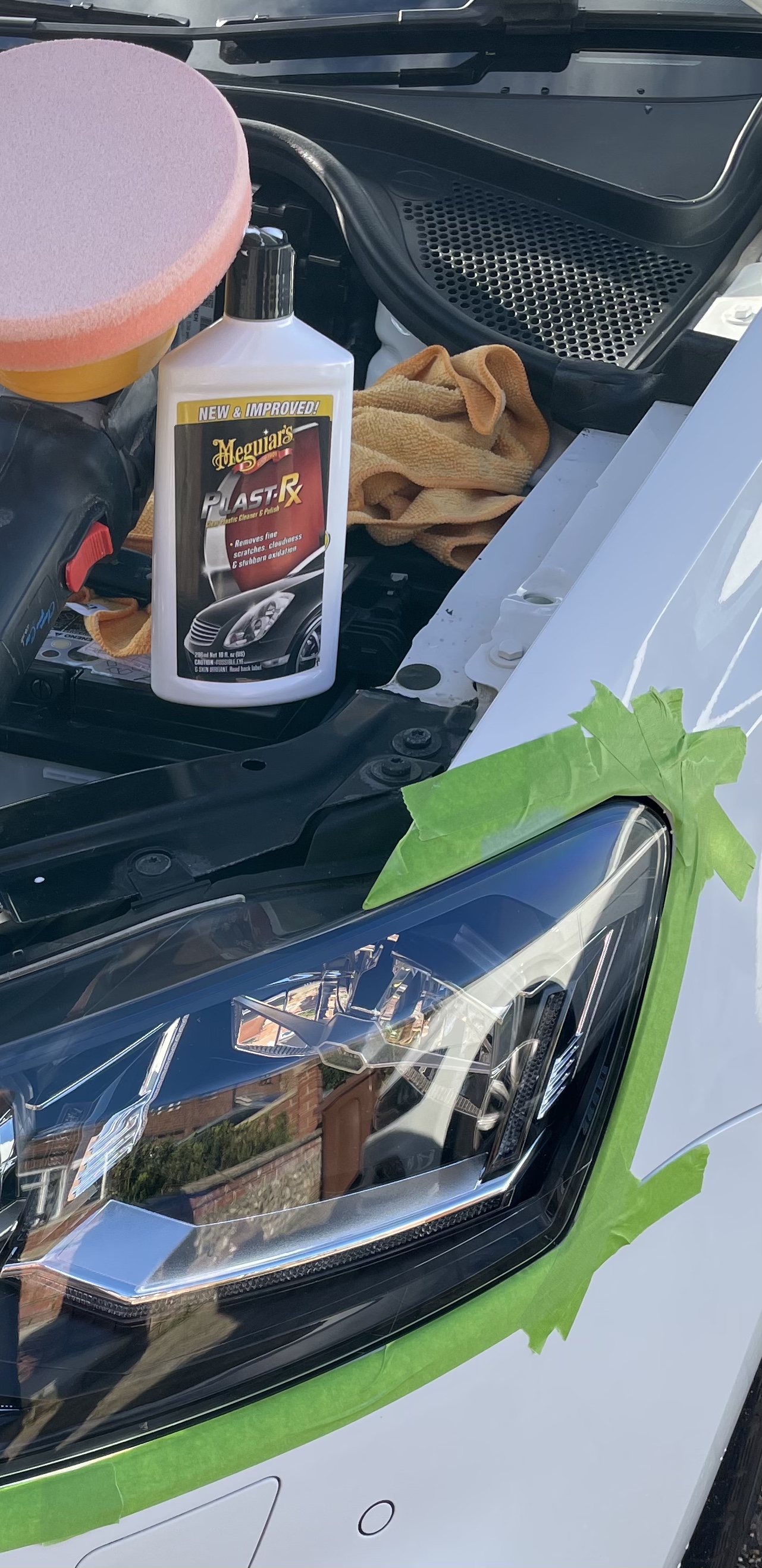

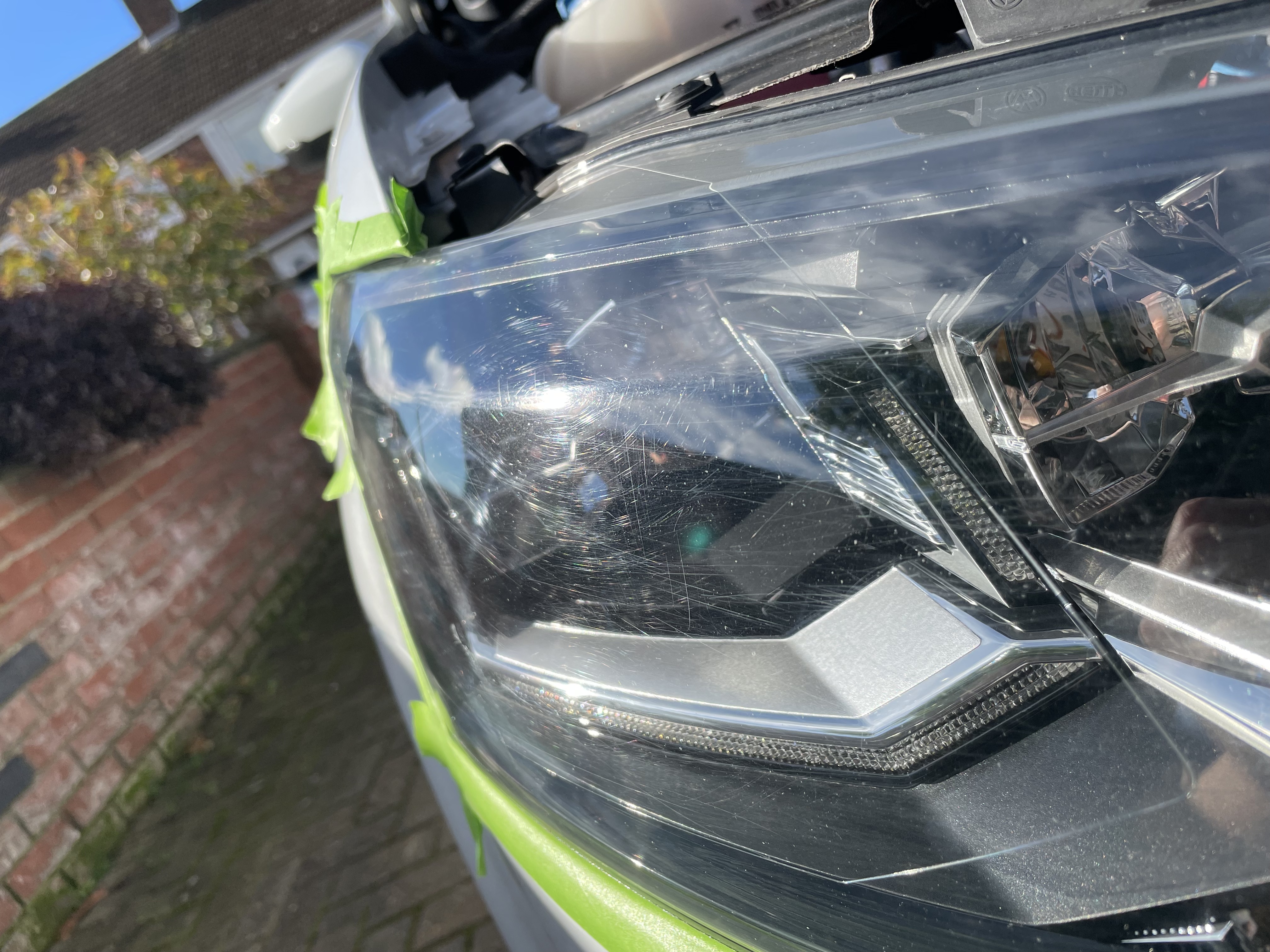

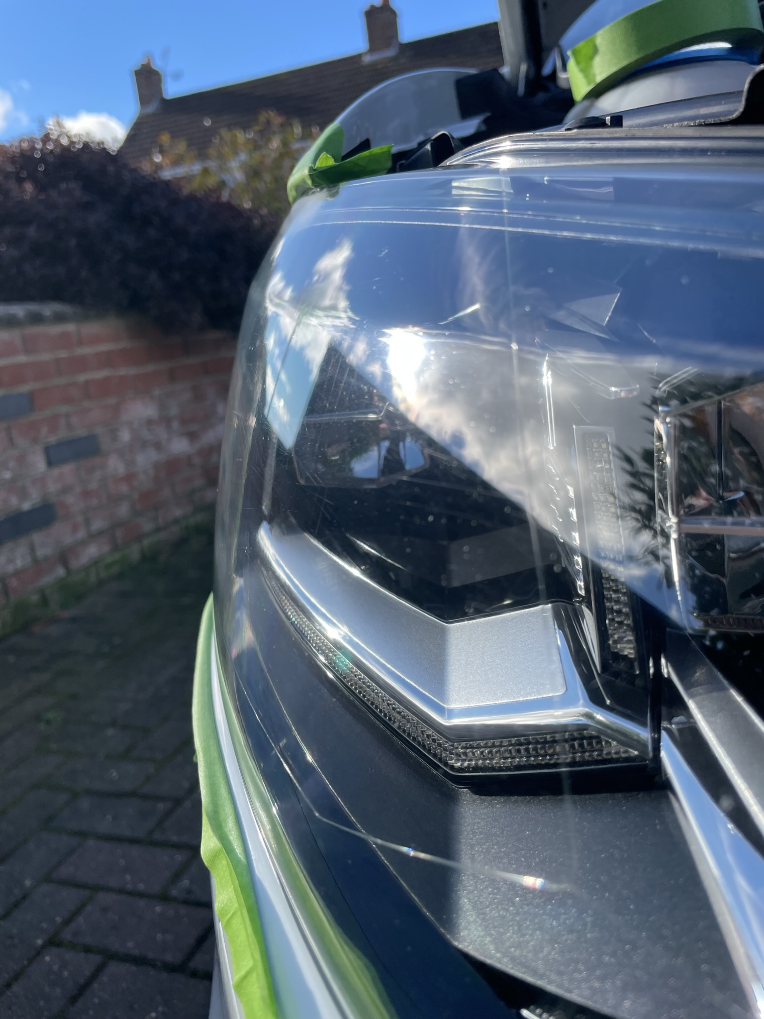

My headlights had quite a few scratches and swirl marks (the passenger side also had one quite deep scratch) so following a recommendation from sam7wright I tried Meguiars Plast-rx polish with my DA polisher. Really pleased with the results and only took a few passes with the DA polisher.
Before
After

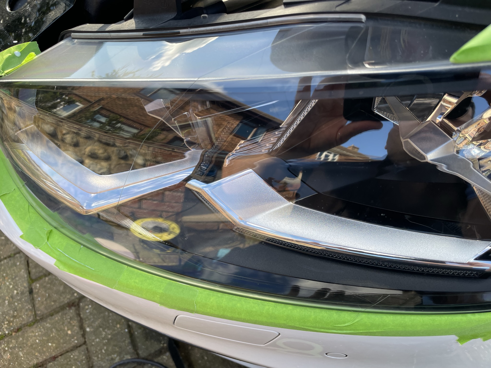

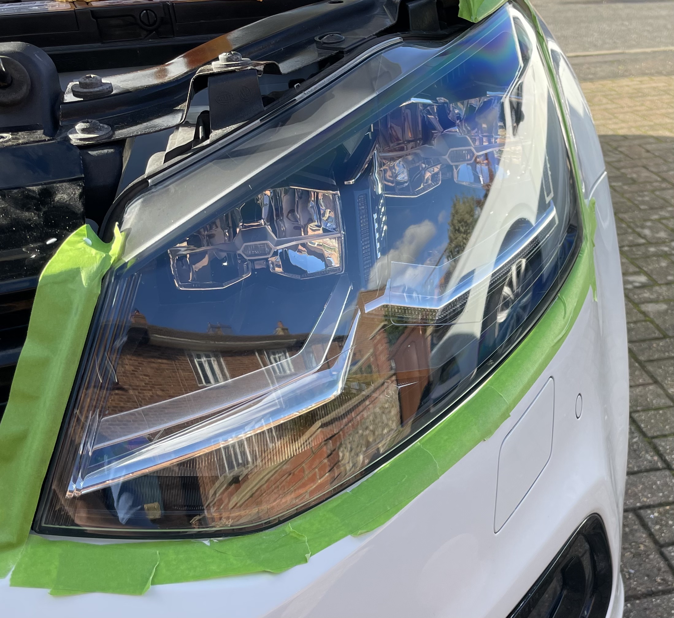

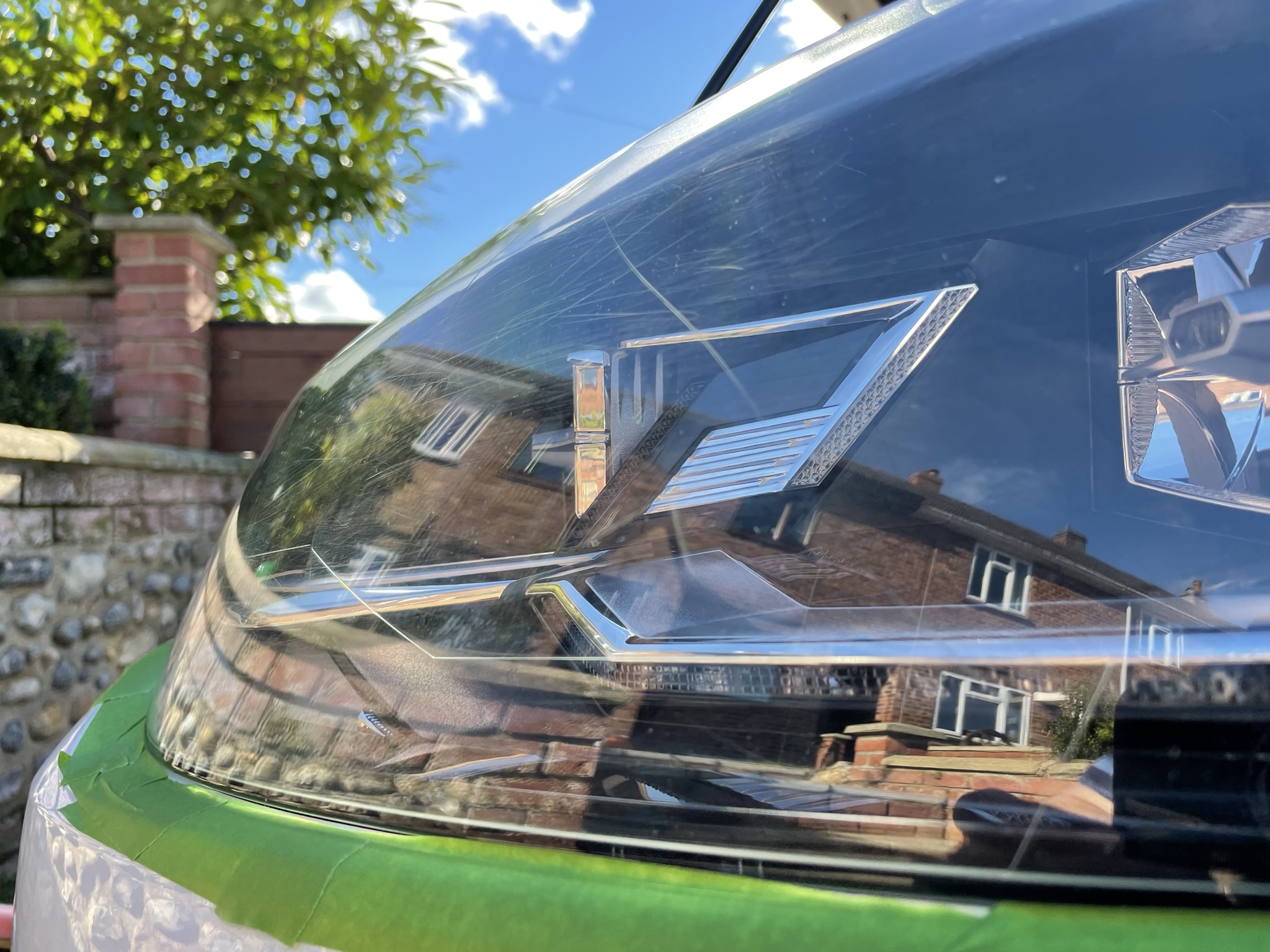

Driver side before
After
