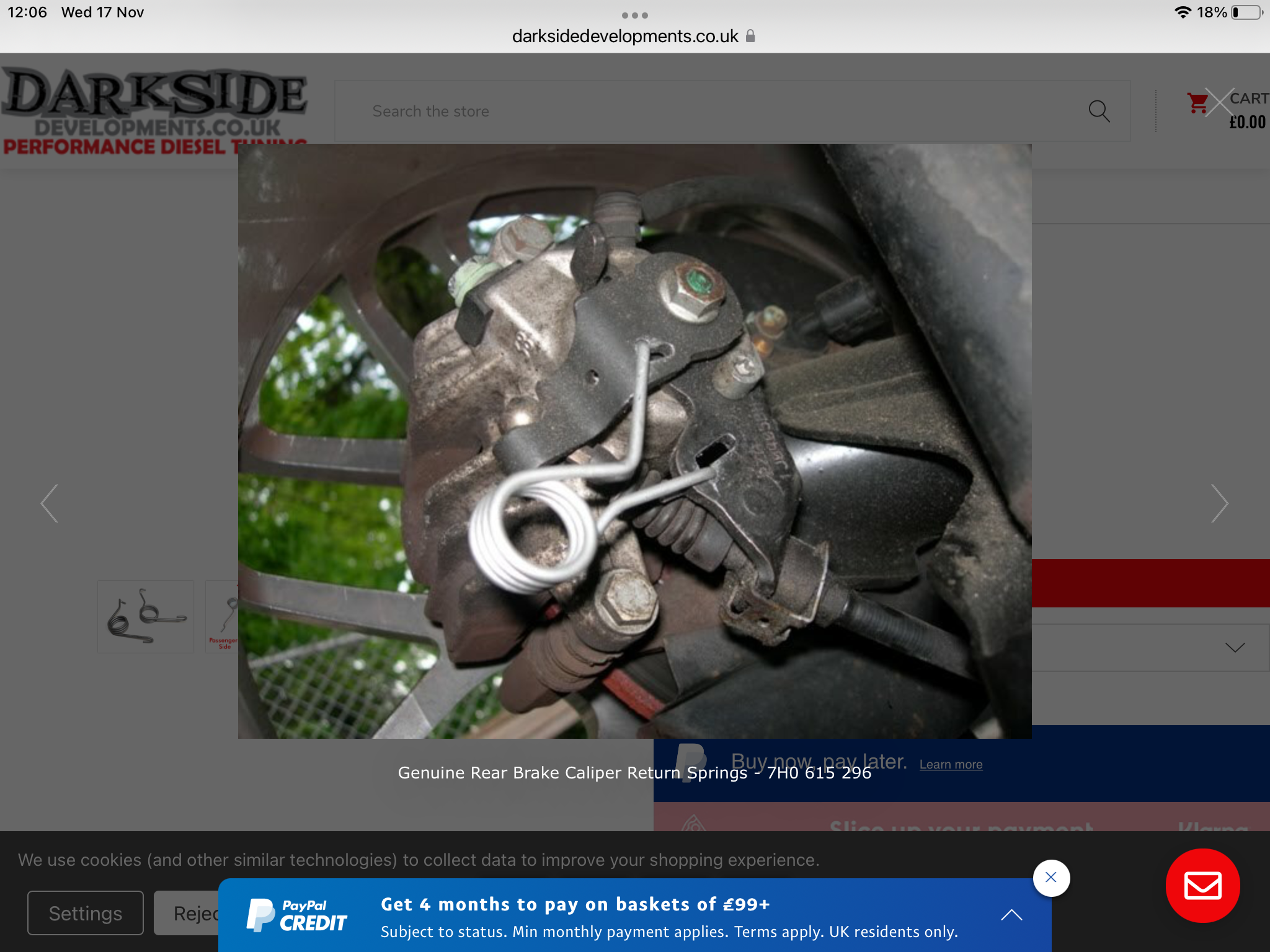

I followed RUMs lead and fitted the external return springs a couple of years back, and have had no problems. I bought them from an eBay supplier for about a fiver for the pair. Fitting was very easy, needing no tools. I didn’t even need to raise the car. I found a photo on the web which shows where the spring fits:

Nice one! Come the Spring (ugh, sorry about the pun), I'll have to take a look at the rear calipers on my Polo. When I've operated on and around them before, I'm pretty sure I never noticed any return springs.
One observation, though: in the pic you've posted, it looks as though the coil of the spring should be sitting on a cylindrical boss of some sort, providing anchorage for the spring. (Otherwise, there's a possibility of the spring flipping out of the levers, isn't there?). But obviously there's no boss seen in that pic.
RUM4MO, are these exactly like the ones you fitted and, if so, did you test to see whether the spring could come adrift easily by, say, you putting finger-pressure to the base of the coil and generally waggling it around?

Veteran, she, that picture shows the spring fitted to the wrong side I'd say, the cranked arm is there to clear the cap headed screw and so the loop faces the front on both sides, I'll confirm that tomorrow, I was just about to congratulate Mikeso51 for posting that and saving me getting under the Polo, but I'll save that until I've looked under the Polo tomorrow.

There are 2 pictures of rear callipers on the darkside website, the second one is more representative of how these springs, either the 7M0 or 7H0 versions fit.
https://www.darksidedevelopments.co.uk/ ... 5-296.html
Edit:- also the pictures of the springs actually show the 2 versions if you look closely at the one end in both pictures, one version has a bent over end at both ends of each spring, the other version has a sort of dogleg at one end of both springs.

Thanks for the links to the return springs, that's really informative. I can fit them when I'm back home at the weekend. With these fitted I'll have guns like the hulk!
