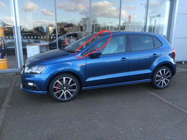

Interestingly, not all Polos had these fitted. Here’s my previous car (2016 6c Polo GTI) when it was brand new and it didn’t have them;

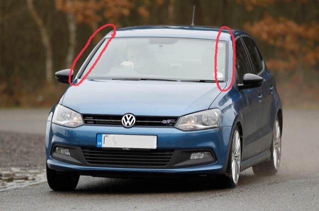

Here’s a 6r Polo Blue GT with them fitted;

Thank you very much and indeed those are the plastic moldings of the BlueGT. I will take note of the reference and stop by the dealer to ask them. Again, I appreciate your information.
