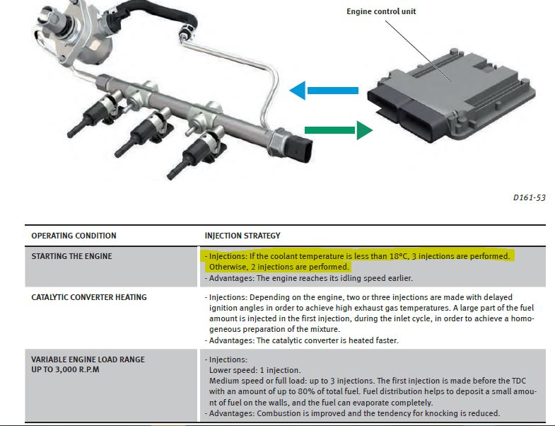

I have a EA211 1.6 MPi naturally aspirated 4 cylinder petrol engine in my Polo, it also idle roughly within the first minute of starting the engine (When coolant temperature is below 18C), this is more noticeable in winter (I am in South Africa, where it is not as cold as UK). But once the coolant is at normal operating temperature (90C), the rough idling shouldn't be happening.
According to the SEAT document - "EA211 AND EA888 FAMILY ENGINES SELF STUDY PROGRAMME No. 161", during idling the EA211 series petrol engine's injection system will inject 3 times when the coolant temperature is below 18C and only 2 times when coolant temperature is above 18C, I guess the initial rough idling we experience comes from the 3 x injection mode (coolant temperature below 18C):
EA211 - Injection.JPG (79.8 KiB) Viewed 94339 times

ho8882000 wrote: Fri Dec 24, 2021 8:48 am
6666 wrote: Sun Dec 19, 2021 5:43 pm Hey guys My Polo 95 TSI has been idling around 950-1000 when warmed up since October ish? I don't remember exactly what it idled at before and I was just wondering if this is normal.? Outside temp is about 8 degrees
I say this because when at a traffic light or so I can really feel vibrations through the pedals/wheels/side handle that I'm not sure if that's normal or not. it's really not heavy vibrations but not unnoticeable either.
Also the engine at idle sounds really rattly ever since I bought it but I've never owned a 3cyl before so I'm not sure if that's what they sound like
sorry this my second car I want to make sure I'm not breaking it :cry: cheers lads
cold start idle is around 1600rpm but it quickly comes down to 1000, this is more noticeable at traffic lights and stops when the engine is at 90
