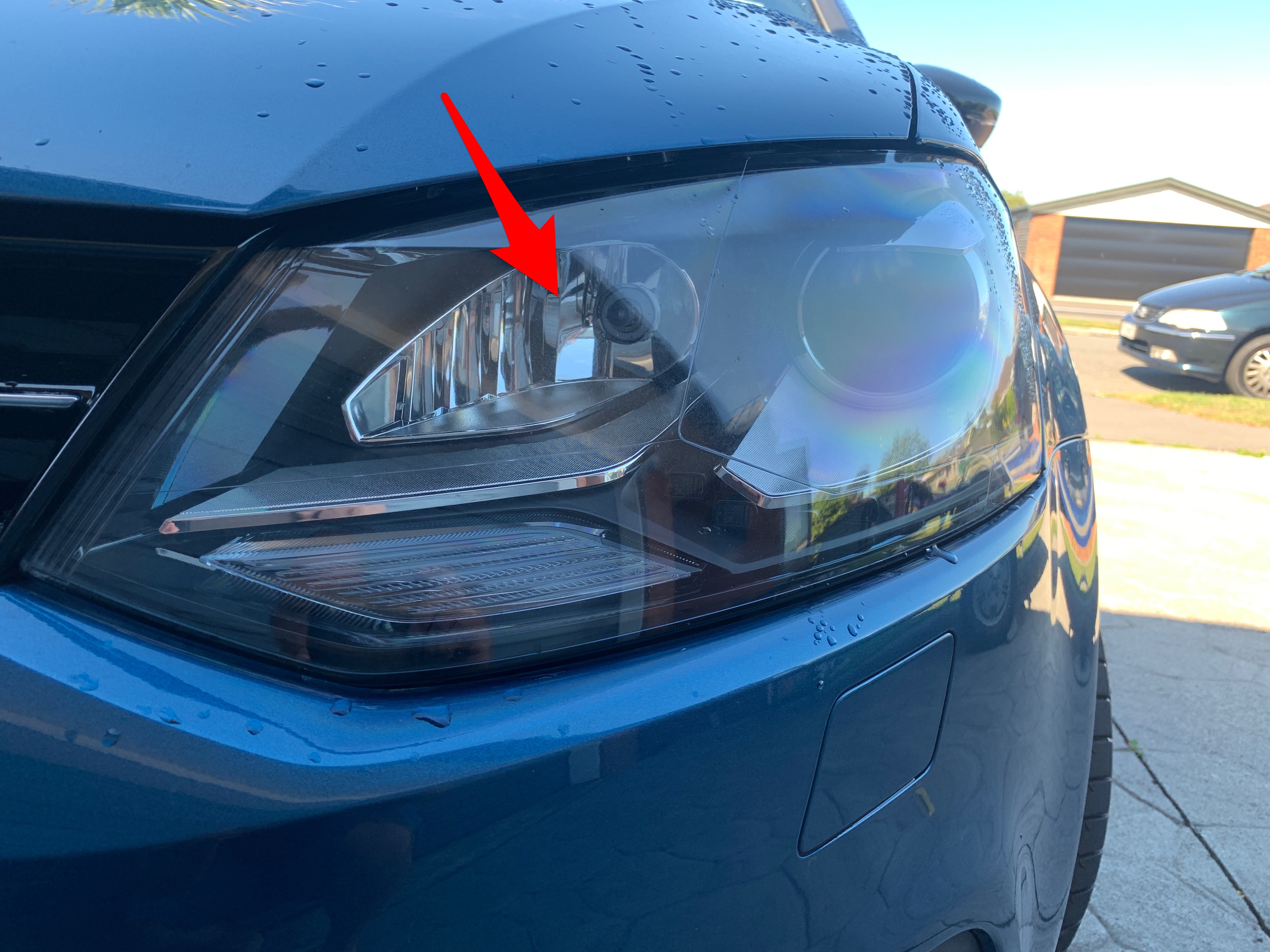

The picture attached shows the ones I’m talking about
Re: Polo Gt blue motion 2013
That is not a fog light but a static cornering light. It will light up when your low beams are on and you turn the wheel at low speed.

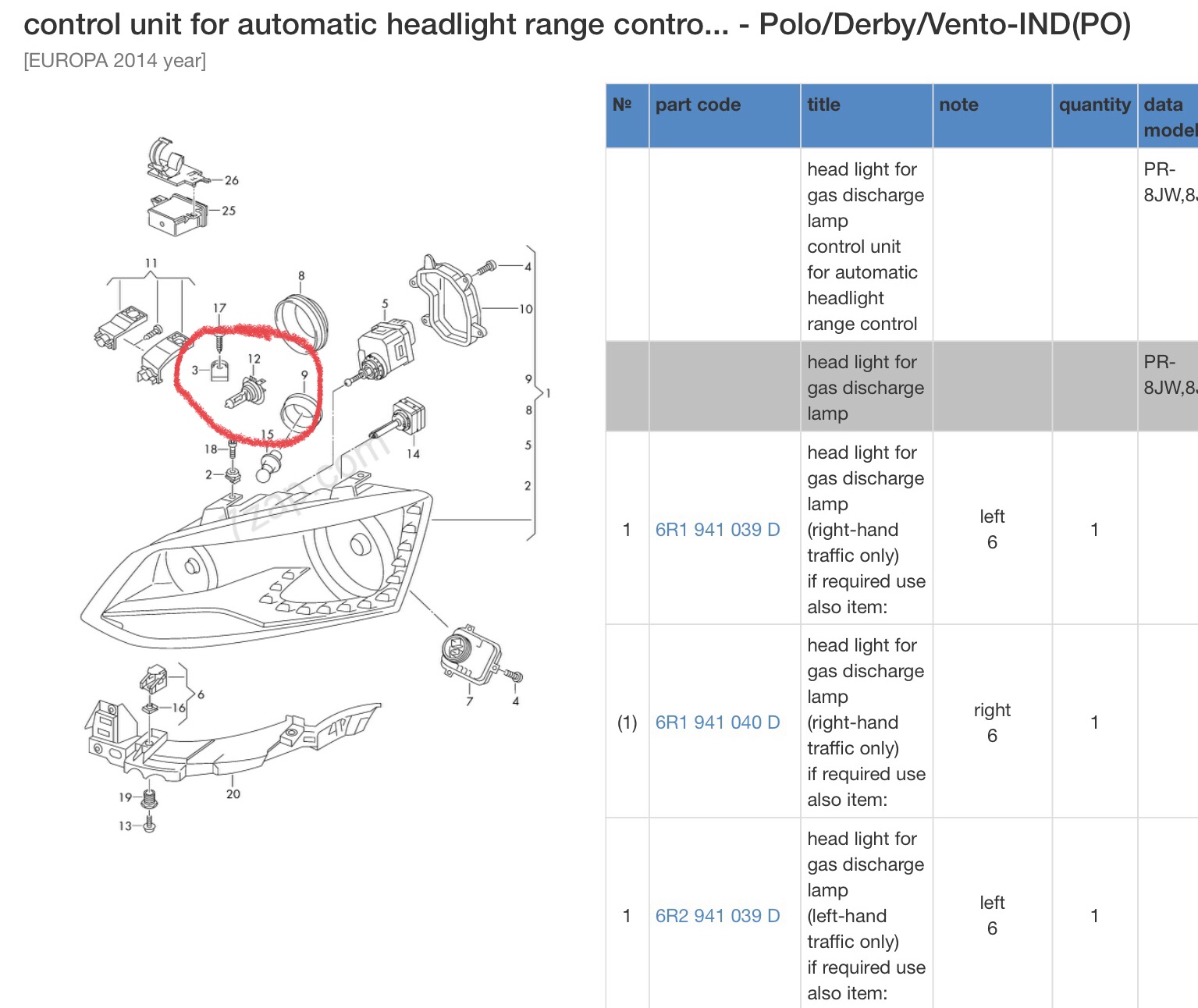

If your car had front fog lamps, they’d be in the lower outer front grille sections - circled in red below;

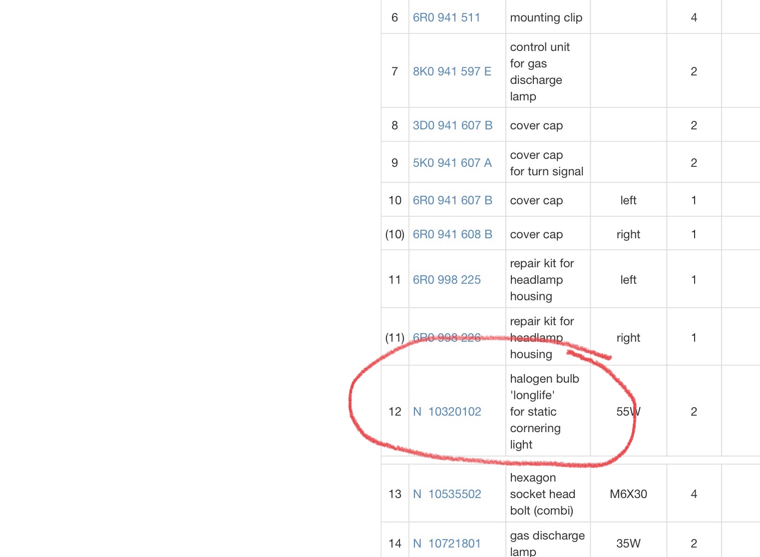

The inner section of the bi-xenon headlamp unit on the Polo Blue GT houses the static cornering lamp - part number 12 on the diagram below. It illuminates when the car is travelling below a certain speed (sorry, don’t know what the speed is) and the car is cornering - the purpose being to provide additional illumination while performing manoeuvres such as turning into or out of junctions.
