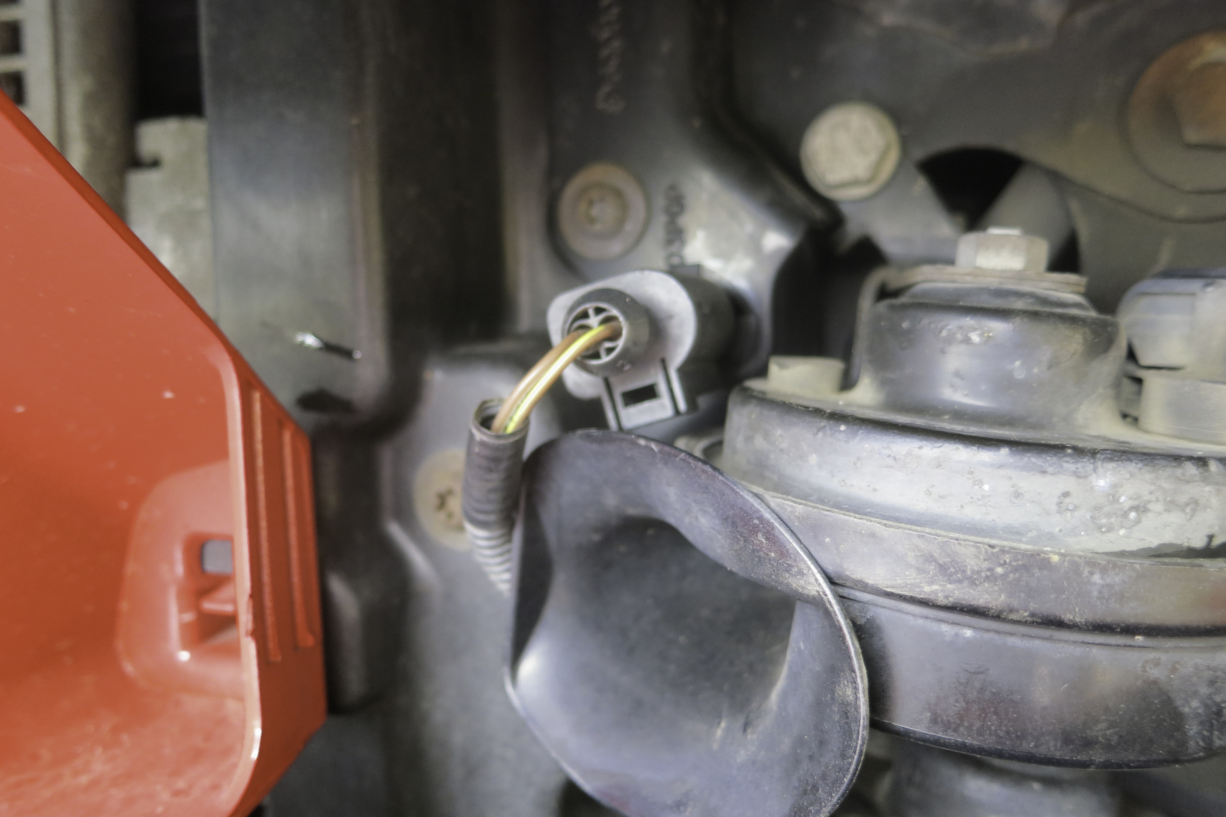

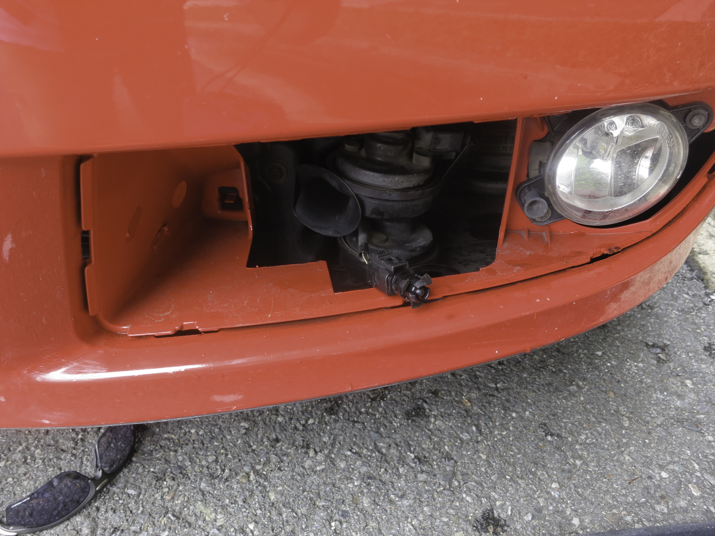

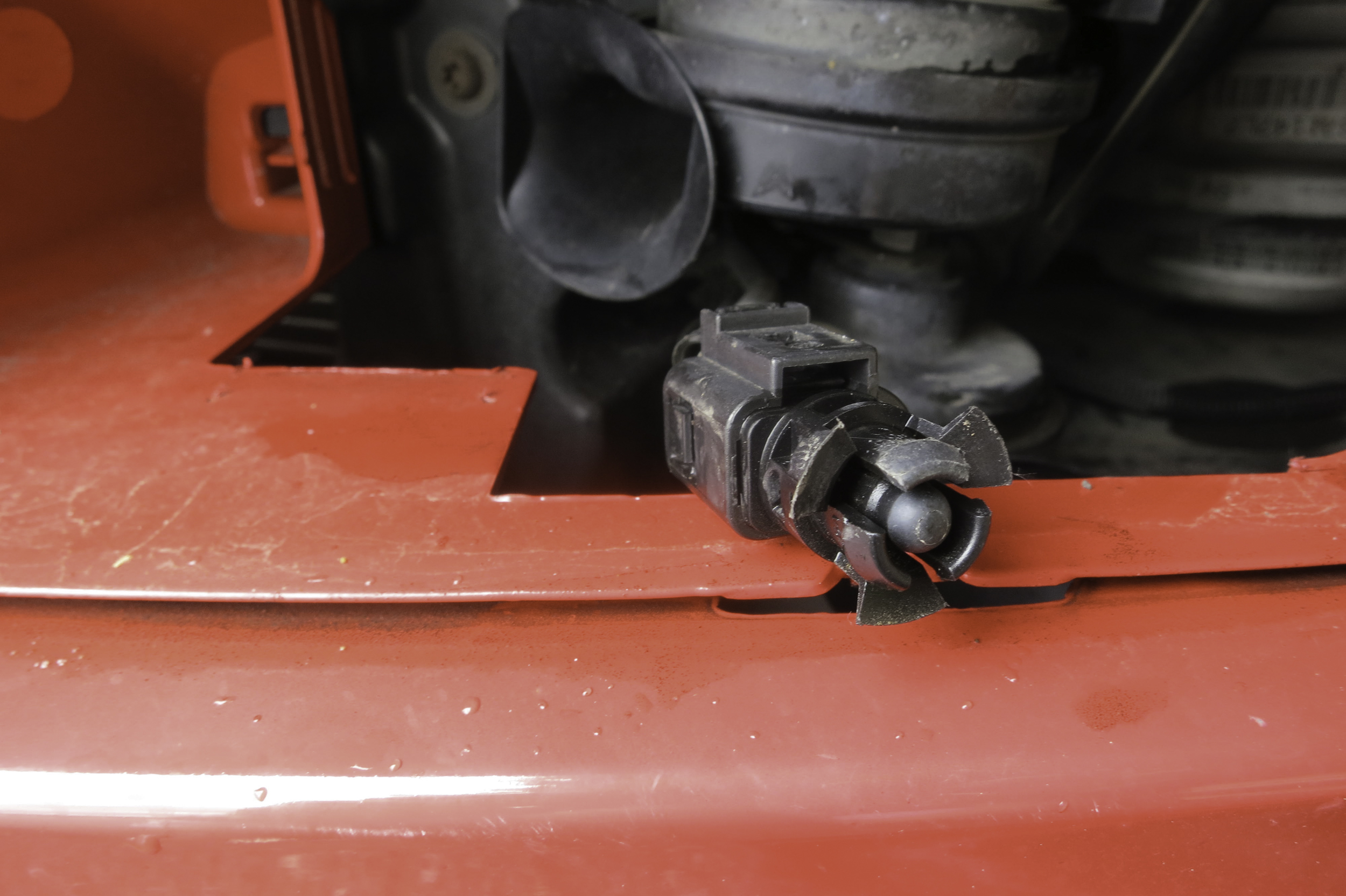

Guys anybody know where the ambient temp sensor location is? I can't seem to find it on the replacement radiator support.
Pictures would be very helpful please?

In our GTi it fits behind the passenger side fog lamp.
Will send image later today.

Sorry - was waiting for a break in the rain.
The sender can face forward or backwards, and clips into an oval hole beside the horn. From the front, you can only mount it backwards. If you have the airdam off (and bumper too), you can access the nook to aim it forwards. Dunno which is better.

POLOZ
Posts: 704
Joined: Fri May 09, 2008 6:20 pm
Re: Rebuilding a CAT N 9N3 Polo
Post by POLOZ »
ValleyForge wrote: Wed Feb 23, 2022 3:42 am Sorry - was waiting for a break in the rain.
Thank you so much for help. You've been a great help!!!!
