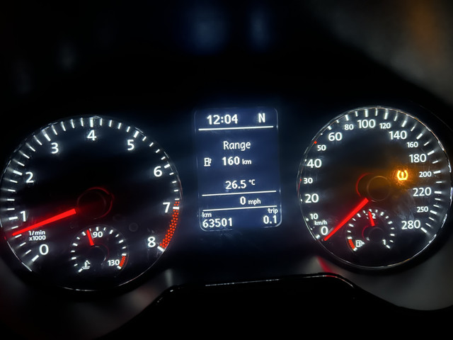

4. RLS and Autodimming mirror - done, added few pictures below. All the expected features works flawless with BCM high 87AD (Auto wipers, Auto dimming, Rain closing, though it is unexpected with the trails I made in my Vento )
5. Indirect TPMS - installation done and coded. But it is not working as expected. I have rechecked the continuity but pressing SET button does nothing. Cluster doesn't illuminate the tyre pressure low SMD or cluster itself is not supporting. Ciclo / Patil - need your support here. PFB the latest scan report.
6. Side parking lights with BCM High - done
7. DRL - done, T17/3 to external DRL's behind the grill
8. Tweeters in A pillar - done

Post by patil »
sshakthi123 wrote: Sun May 15, 2022 12:50 pm
Should have been a easy job for you, as you already did this on Vento. Share the details of your wiring connections done on Polo.
sshakthi123
Posts: 105
Joined: Sat Oct 27, 2018 5:55 am
Drives: Vento 1.5 TDI MT and Polo 6R 1.2 Tsi Dsg
Location: Coimbatore, India
Re: Polo 6R 1.2 GT Tsi RHD
Post by sshakthi123 »
Here is the wiring connection,
SET button T6
  • pin 3: illumination signal
  • pin 4: goes to pin 12 of ABS connector
  • pin 5: +15
  • pin 6: ground
PS: Sorry for the delay in responding.

Wiring scheme is correct. Recheck wiring again.
Coding is correct for addresses 03 & 17 according to recent scan posted.
Try resetting tpms warning display in basic settings of address 03 drop down menu.

Few more updates done recently,
1. Composition media installed
2. Indirect TPMS coding updates done and it provides only audio feedback and no display in the cluster. Possibly there is no SMD in position.
Latest auto scan here,
