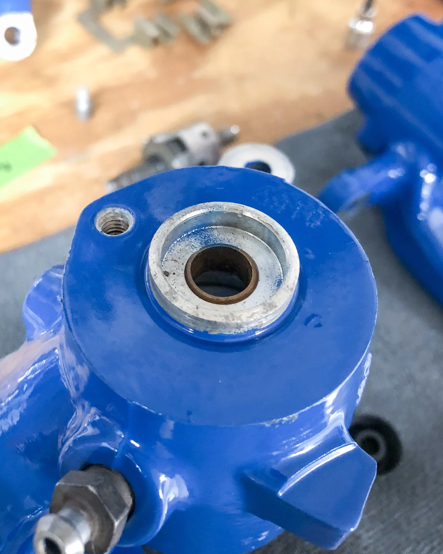

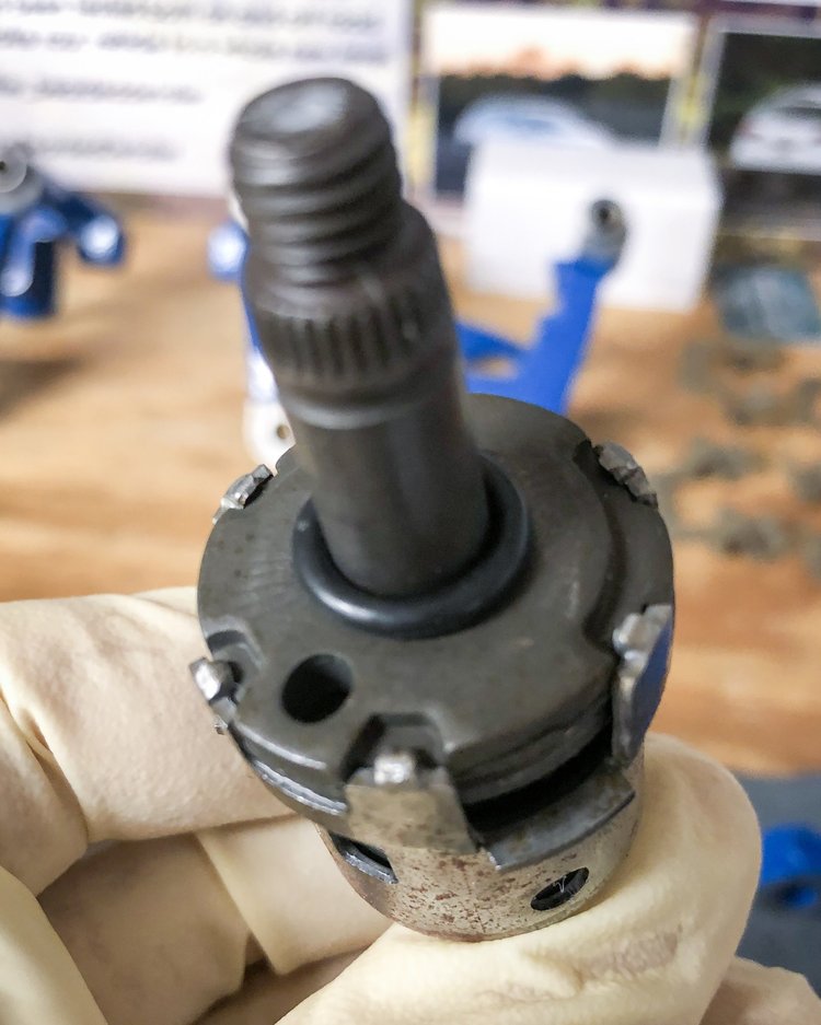

-rear disc brake
Note: Water intrusion from the handbrake mechanism into the calliper body, and heavy oxidation.
-If rusts forms on this shaft and cause pitting damage, it will leak. - The rubber gasket wont form a good seal. The rebuild kit with rubber parts costs as low as 8EUR ( preventive swap every 5 years should avoid pitting damage on the shaft.
