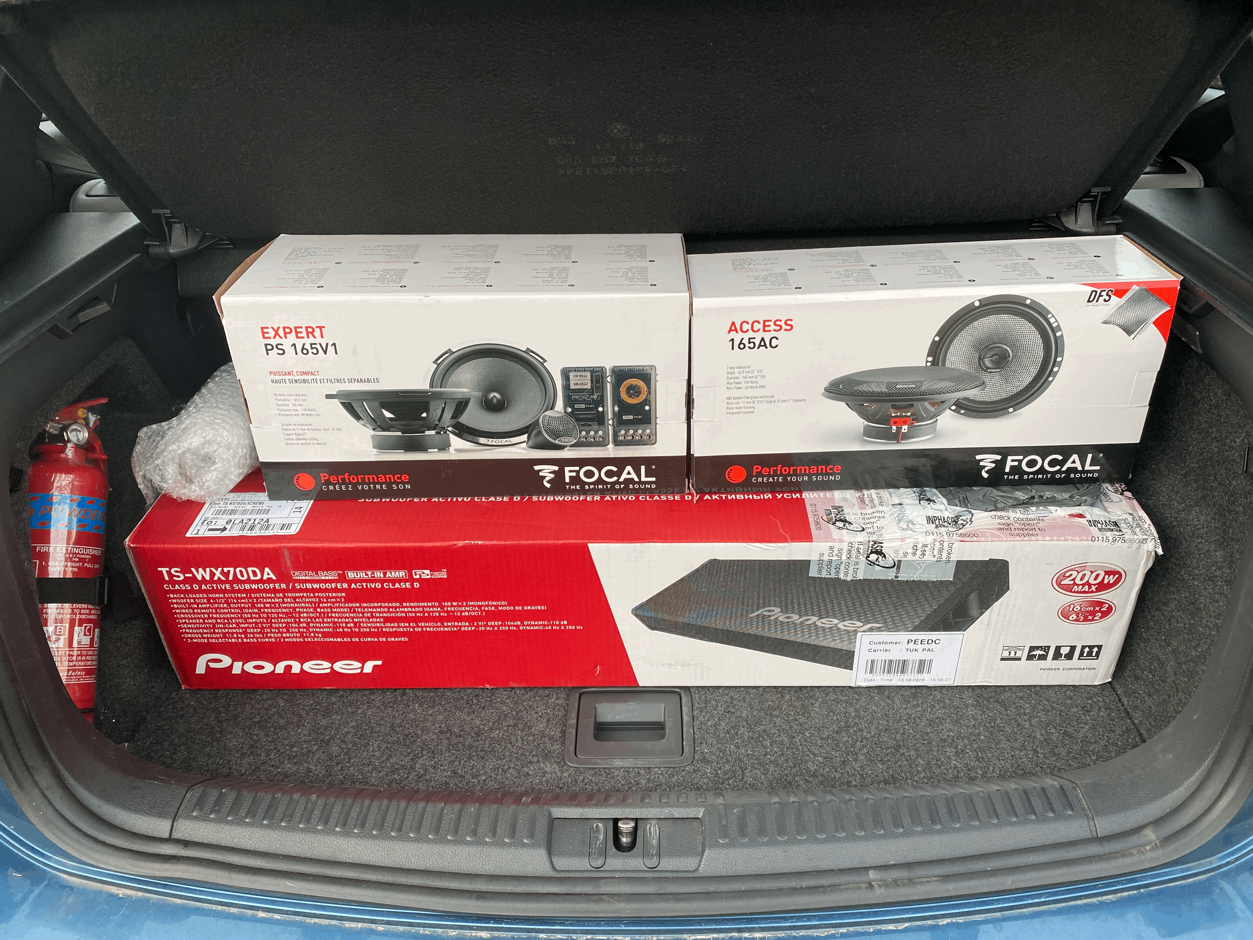

I got the Focal Expert PS 165V1 for the front and Access 165ac for the rear. Did you use the tweeters in the rear? For the amp/sub I got a Pioneer TS-WX7-DA and have in below the split level shelf. It ads quite a bit of bass, but I now need to sound deaden the door cards!
