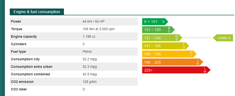

attached an image of the engine

Re: Polo 2012 wont start
Post by alexperkins »
The 1.2 3 cylinder is known for its timing chain issues. I'd suggest you get this checked as a matter of urgency, and avoid trying to start it again till then
