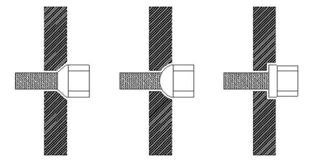

    If you’re considering aftermarket alloys, then the PCD must be 5x100, otherwise the bolt pattern of the wheels won’t align with the bolt holes in the car’s hub assemblies. Also, avoid anything too wide or with too aggressive an offset, otherwise you may experience clearance issues - either with with the wheel/tyre protruding out to far, or the inner face of the wheel/tyre fouling the suspension struts. There’s a very useful calculator on www.willtheyfit.com where if you input the details of the existing and new wheel / tyre set-up, then it’ll calculate the critical differences between the old and new set-up. Be aware that the vast majority of aftermarket wheels use wheel bolts with a tapered seat (VW wheel bolts for genuine VW alloys have a radius seat), so new wheel bolts would be required - see picture below so you can see the differences; tapered seat on the left image, radius seat in the middle. Also VW centre caps may not fit aftermarket alloys.
