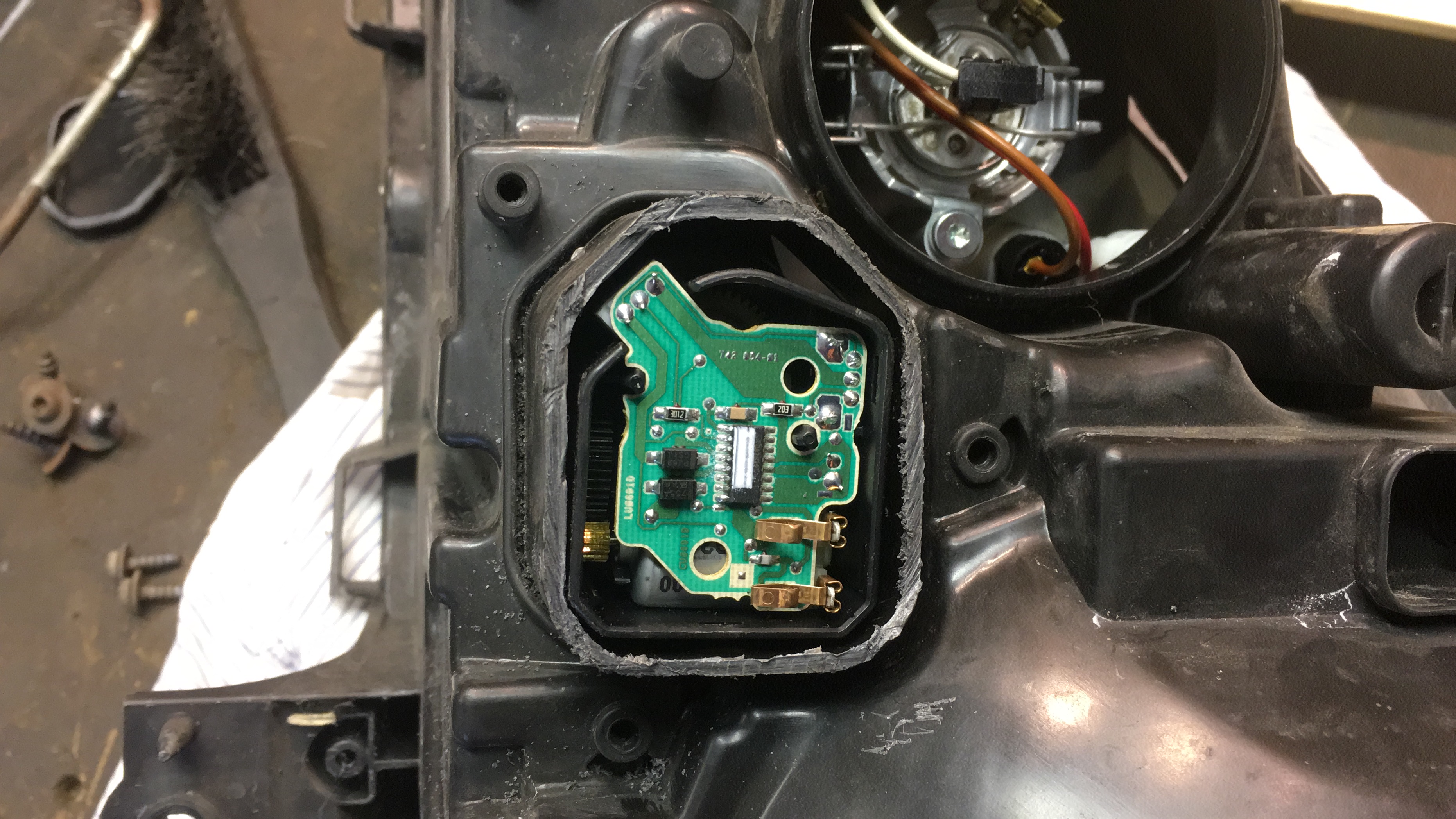

So today I bit the bullet and took the bumper off and pulled off the headlamp that sounds like it has a woodpecker stuck inside it!

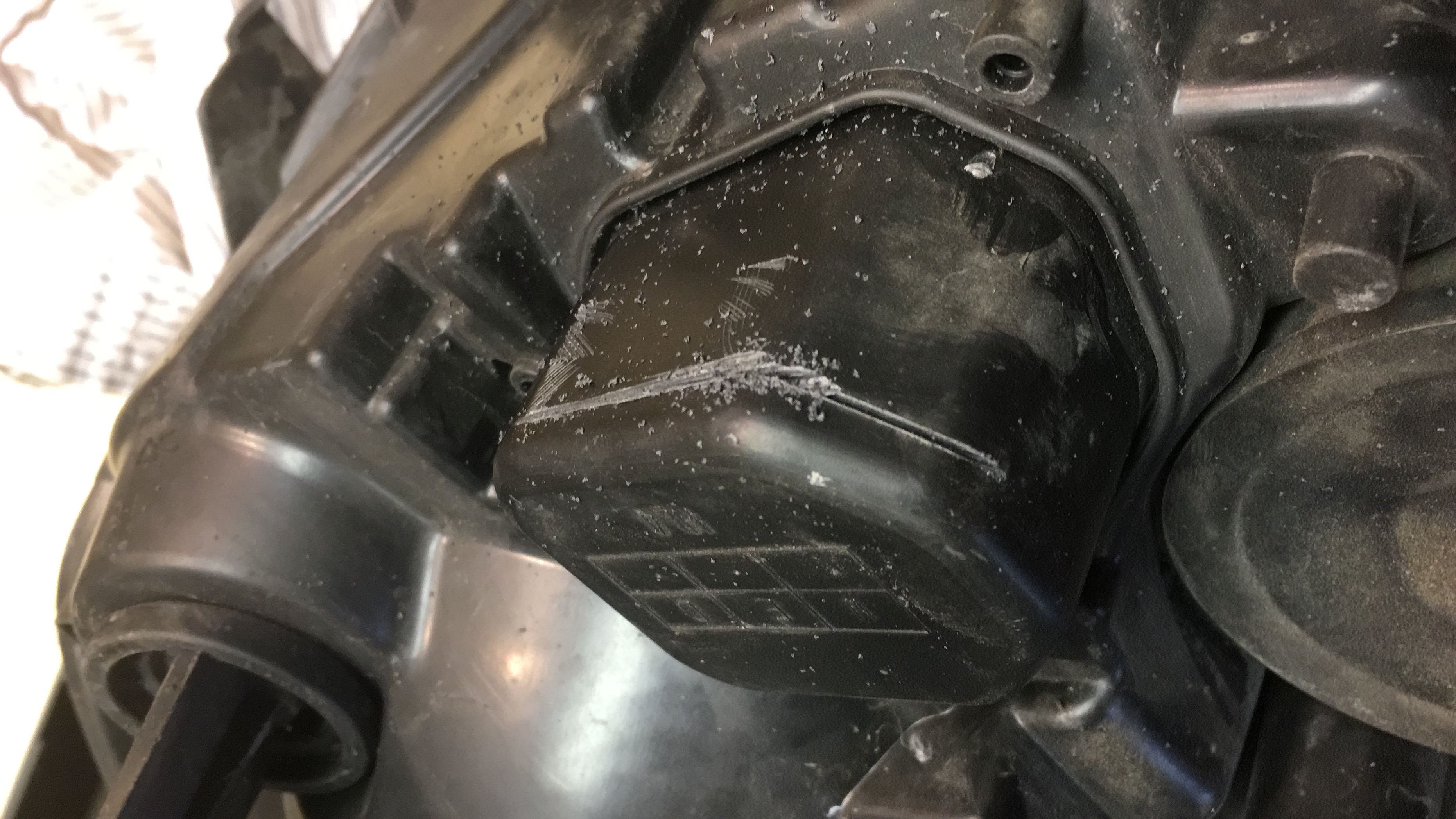

Mine are Hella units and a bit of research revealed the motors are sealed in the casing….great design!!! So I cut the casing open where the motor is but I couldn’t work out how it comes out, the motor spins freely so maybe it’s a fault with the electronics?

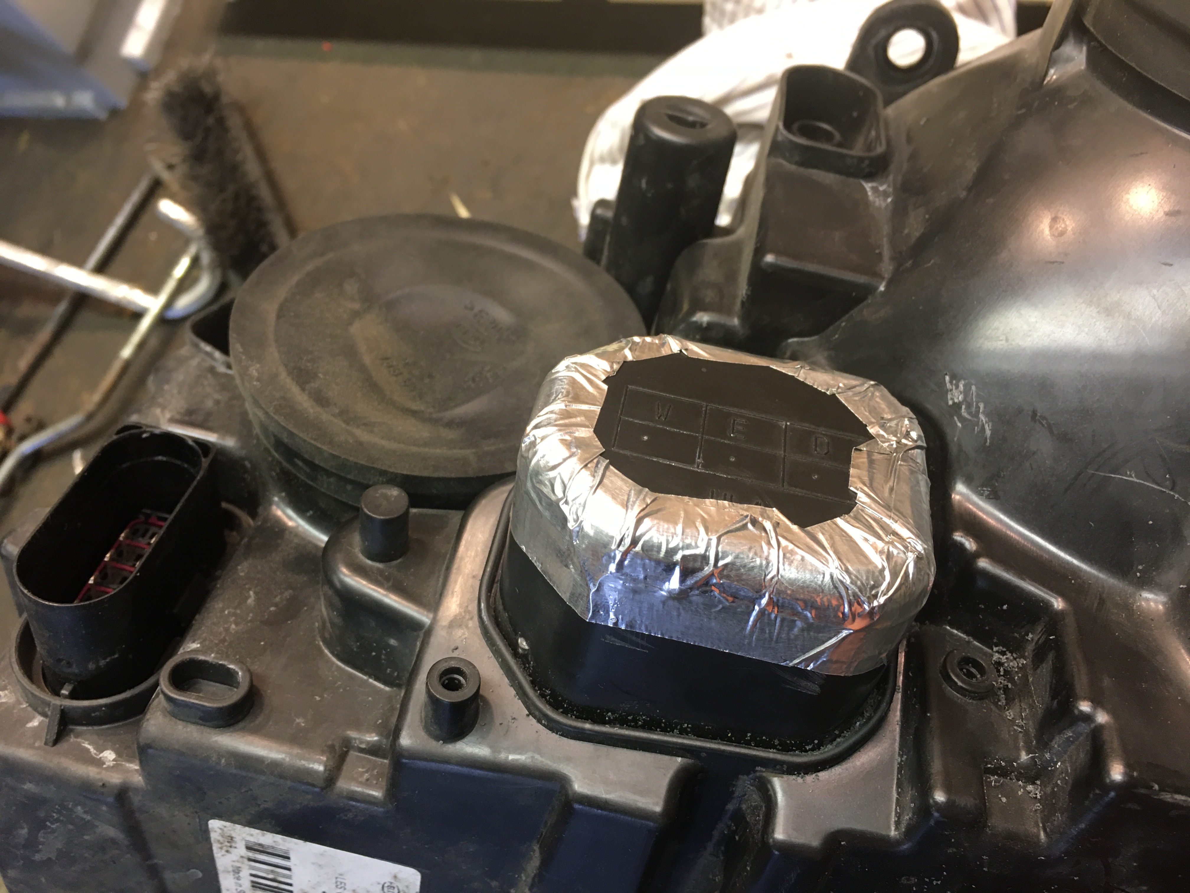

If anyone knows how to fix these units that would be great. I siliconed the case shut and put aluminium tape over the join.
Very frustrating morning!!!!
