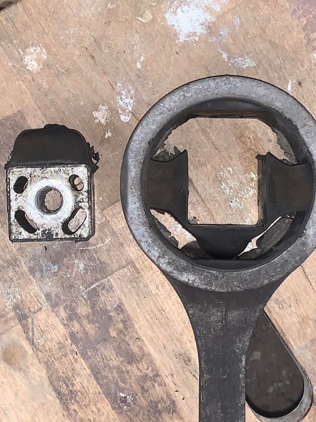

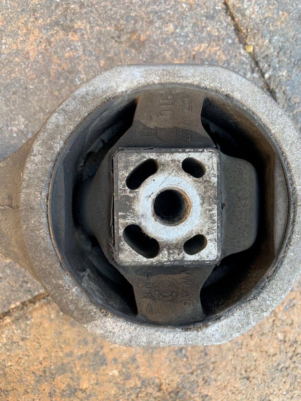

I get the jerking issue with the clutch completely engaged and just using the throttle to control my speed. I don't think I've ever experienced any jerking / bucking with partial clutch engagement.
With the 1.8TSI and MQ350 QQR gearbox, the minimum speed in 1st is 4mph and 2nd is 8mph.
If I'm crawling in 1st doing 5-7mph maintaining my speed, the bucking will start and continue until I either release the throttle or increase my speed. If I let the car continue to jerk and buck it'll eventually do it in a consistent rhythm which probably looks very odd the everyone around me
In 2nd crawling at 9-11mph, the same thing will happen just not as bad. It feels as though the car's throttle mapping is shutting the throttle very suddenly in order to maintain the car's speed but causes very sudden engine braking and the lower the gear the more pronounced it is.
It'll sometimes happen in 3rd but not as consistently and nowhere near as bad.
With the anti-stall in stop-start and low-speed city driving, it'll happily go up to and maintain 4mph if I set off with just the clutch but if I'm rolling at say 2mph and get near full clutch engagement it'll shoot up to 7mph with no throttle input.
Other than this strange low-speed behavior, the leaking thermostat housing (fixed under warranty thank f**k) and now a leaking valve cover that needs sorting which likes to occasionally make it smell like I'm sat behind a 2006 Renault Trafic with a knackered cat. This generation of Polo with the 1.8TSI has many more positives than the previous examples of Polos I've owned
Also regarding the dogbone mount. When that goes bad you'll get a lot of engine movement/shunting when downshifting accompanied by a muffled knock/thud. Pictures below of one from a 9n3.
- dogbone mount11.jpg (259.72 KiB) Viewed 4603 times
- dogbone mount22.jpg (262.52 KiB) Viewed 4603 times
