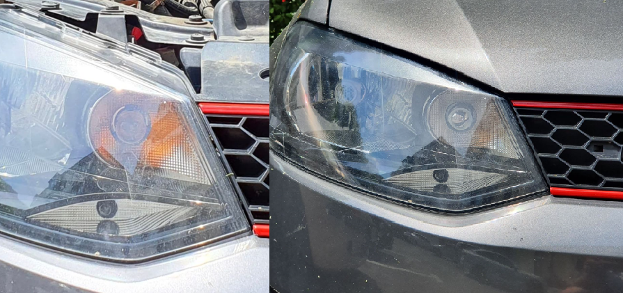

Is there such a thing? I have the H4 headlights and the signal bulb reflects into the plastics and makes half the headlight yellow, looks kinda weird imo.

Just installed the Philips Silver Vision and I would say the difference is pretty major. There is still some orange being reflected. I would say the bulbs are 95% chrome and 5% orange.
Tbh I think the little orange that is reflected in the housing is only visible when viewing it from straight on and from any other angle it's perfectly chrome.
As you can see from the picture, they are very nice and I can recommend them for who wants to get rid of the orange reflections.

Looks good :D
No more "fried egg".
