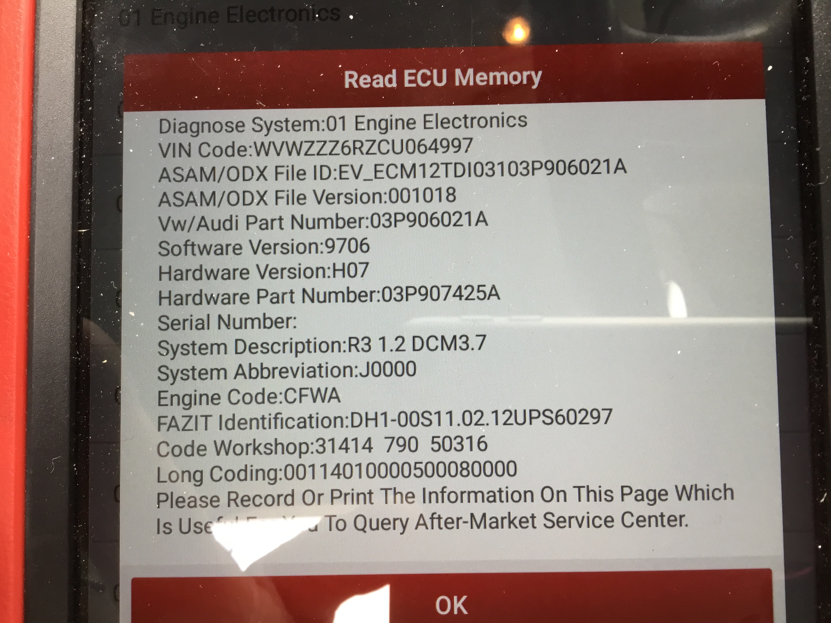

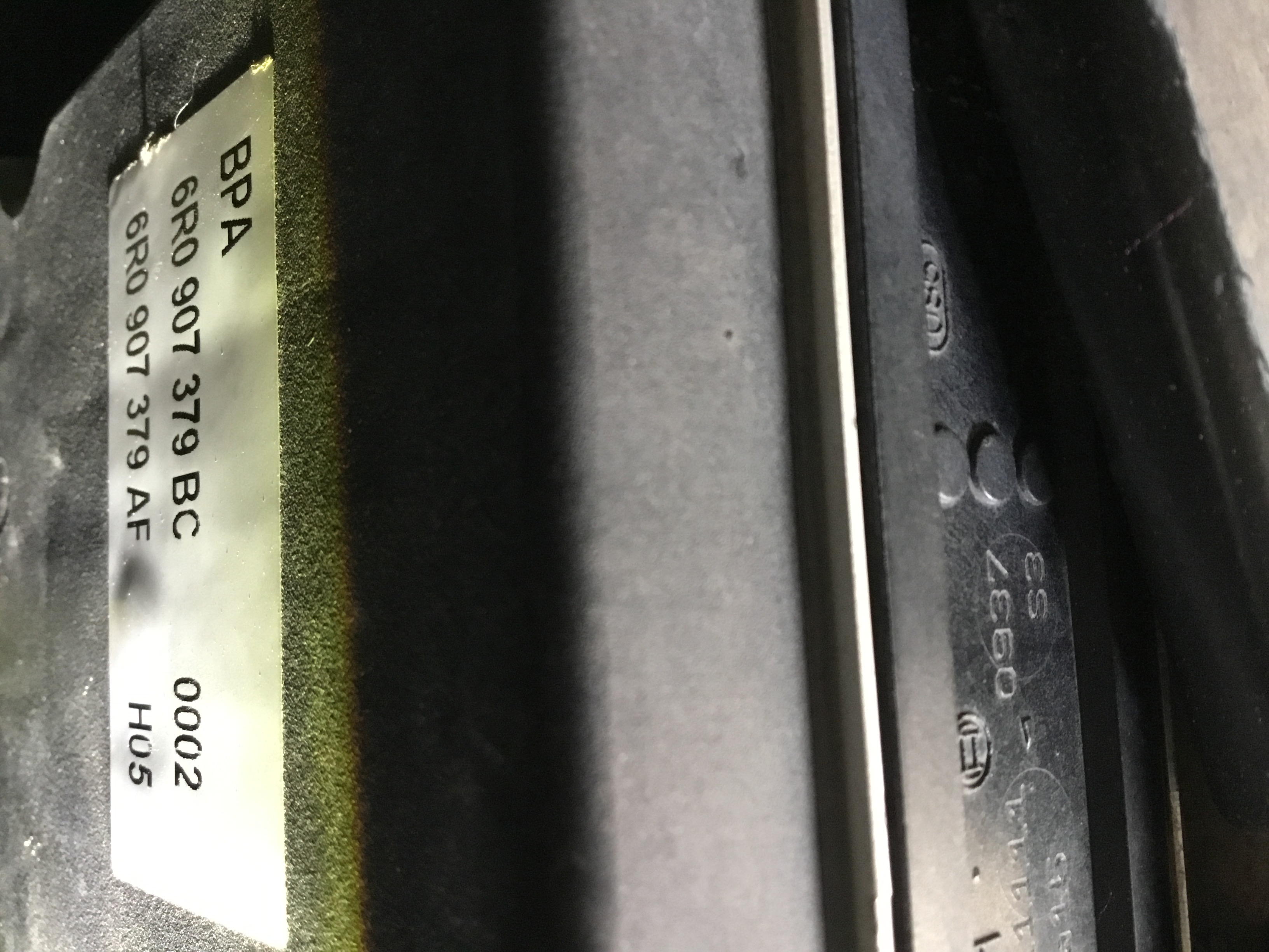

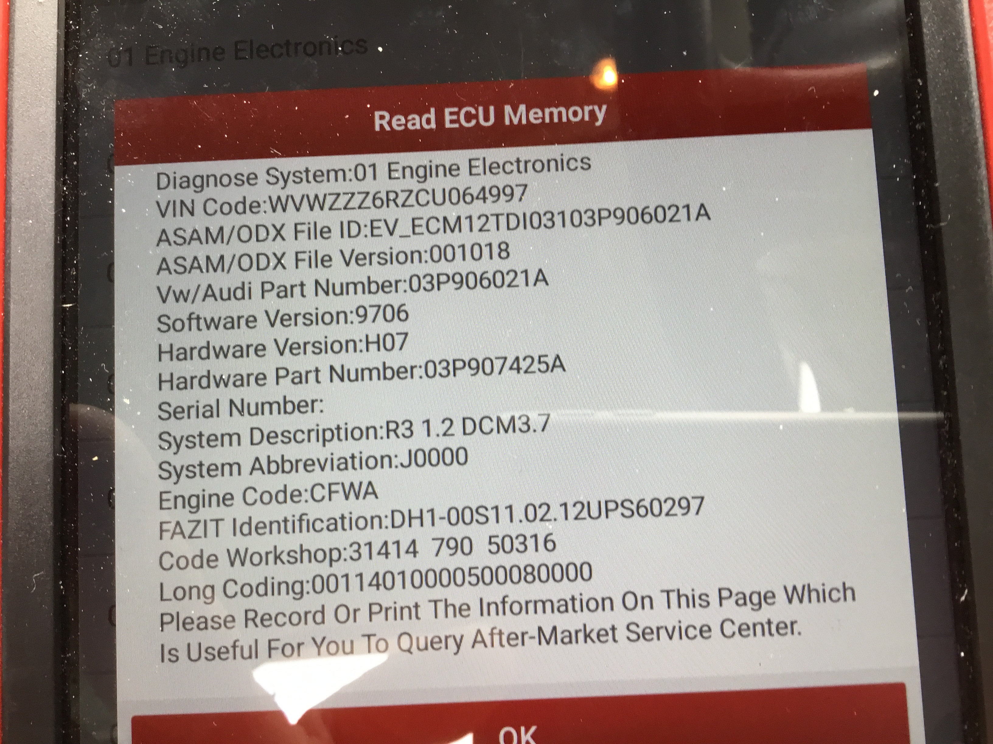

I can probably have a go at calculating your coding, you can try the coding on your ABS module and if it takes, you might need to do a basic setting of all the sensor of the ESP system, if present.
And I need the VIN that is stored in the new clocks and engine control unit as well as the physical VIN.
Costs will be €50, no cure no pay.

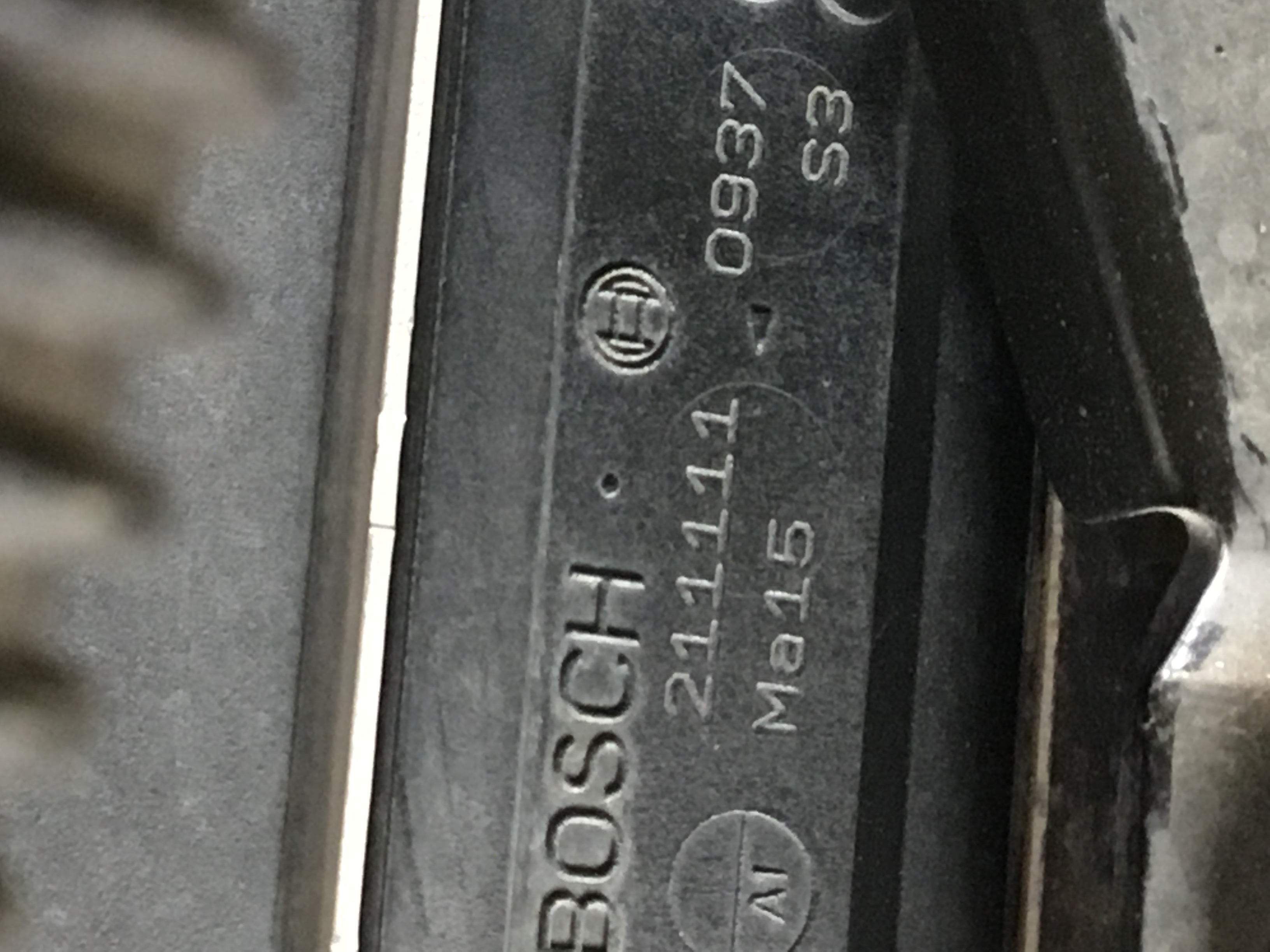

Morning. I’ve got some data for you. Hopefully this helps

Forgot to add this
- 0482C229-05B7-4A62-98DC-B408AB48767C.jpeg (3.55 MiB) Viewed 3245 times

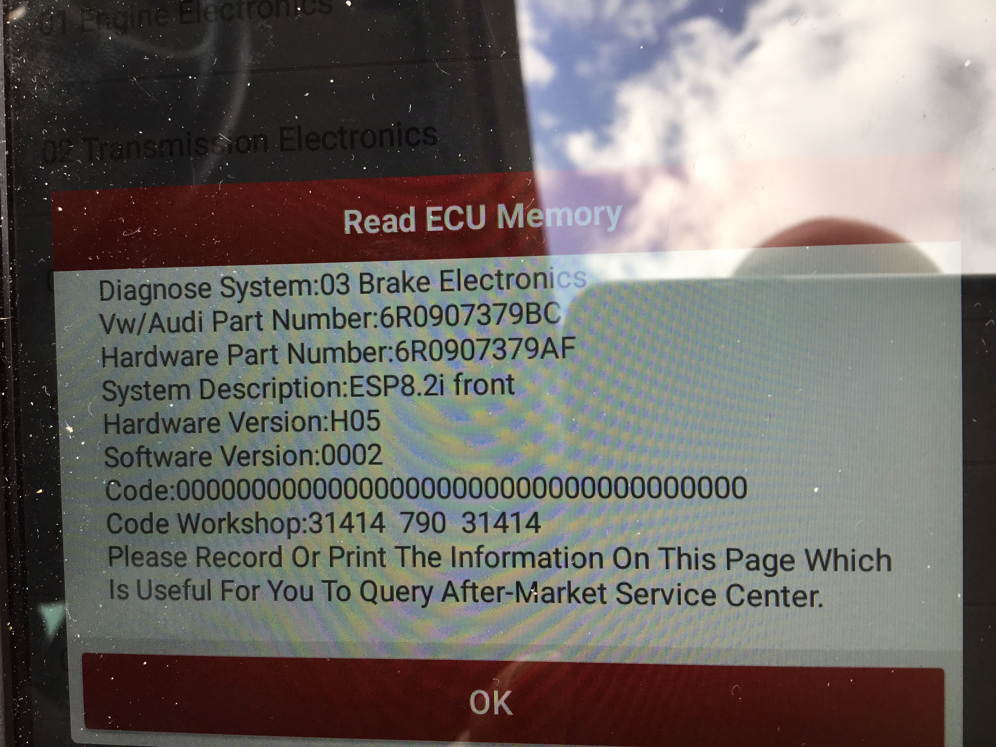

Hi just tried and it’s not working. Comes up with. Function cancelled critical condition not met [NRC $22)

Hi again. I’ve just imputed that code and it’s been accepted. But traction control light is still on. And I have no hill assist working I’ve tried to do a steering angle reset but comes up with no communication

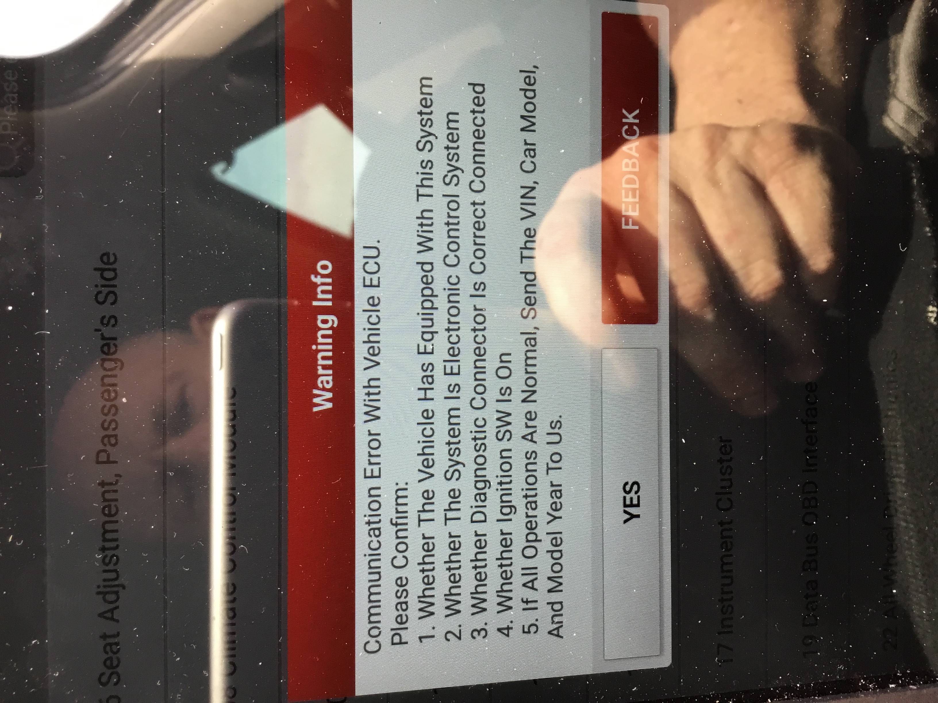

Did ypu try basic settings for the slip ring?
patil
- Posts: 577
Re: ABS coding.
The steering angle basic settings should be done with engine running and steering wheel at centre.

When I try to go into steering angle sensor settings it comes up with no communication :

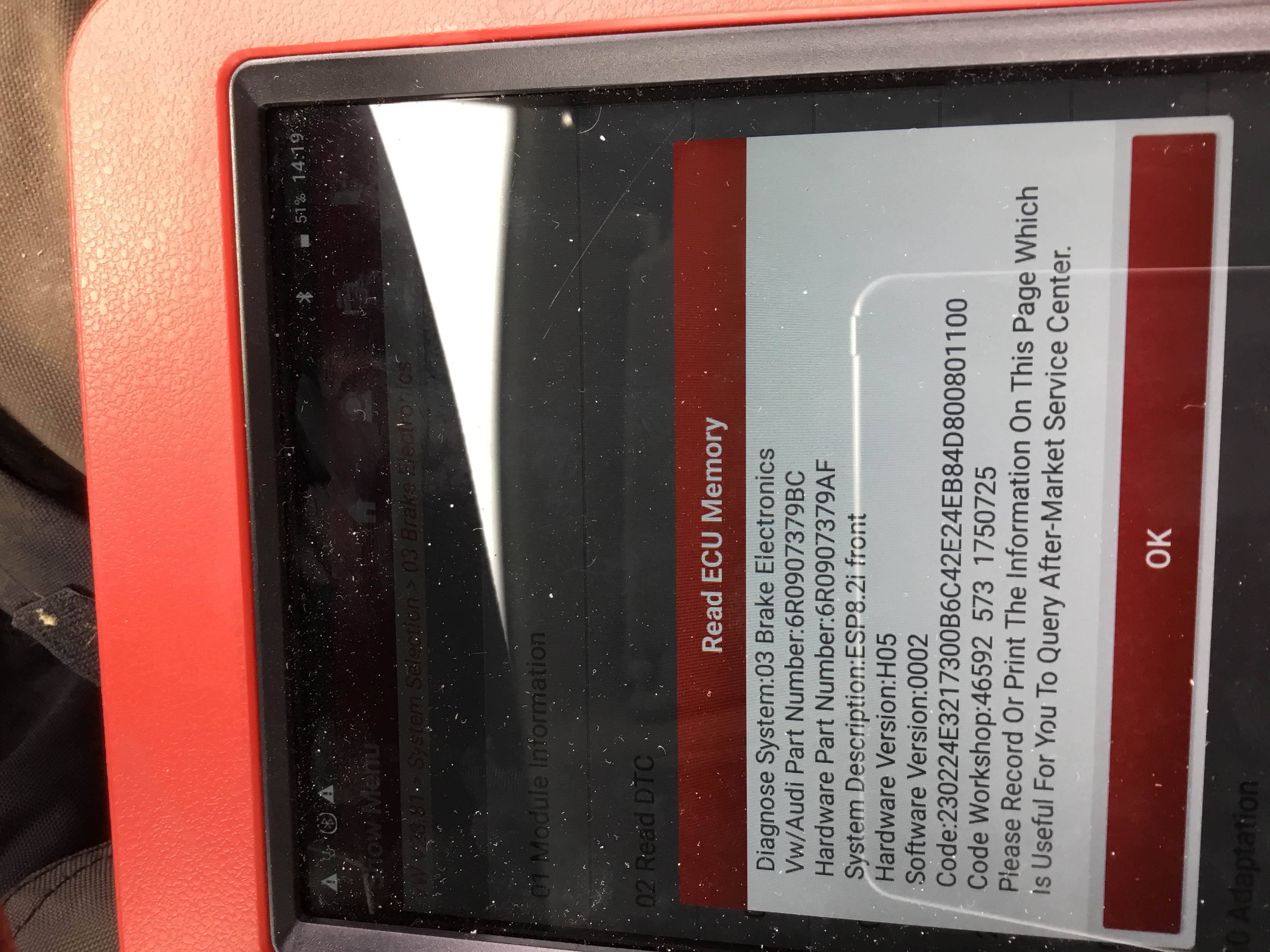

Re: ABS coding.
All info on brake module ecu show as follows.
