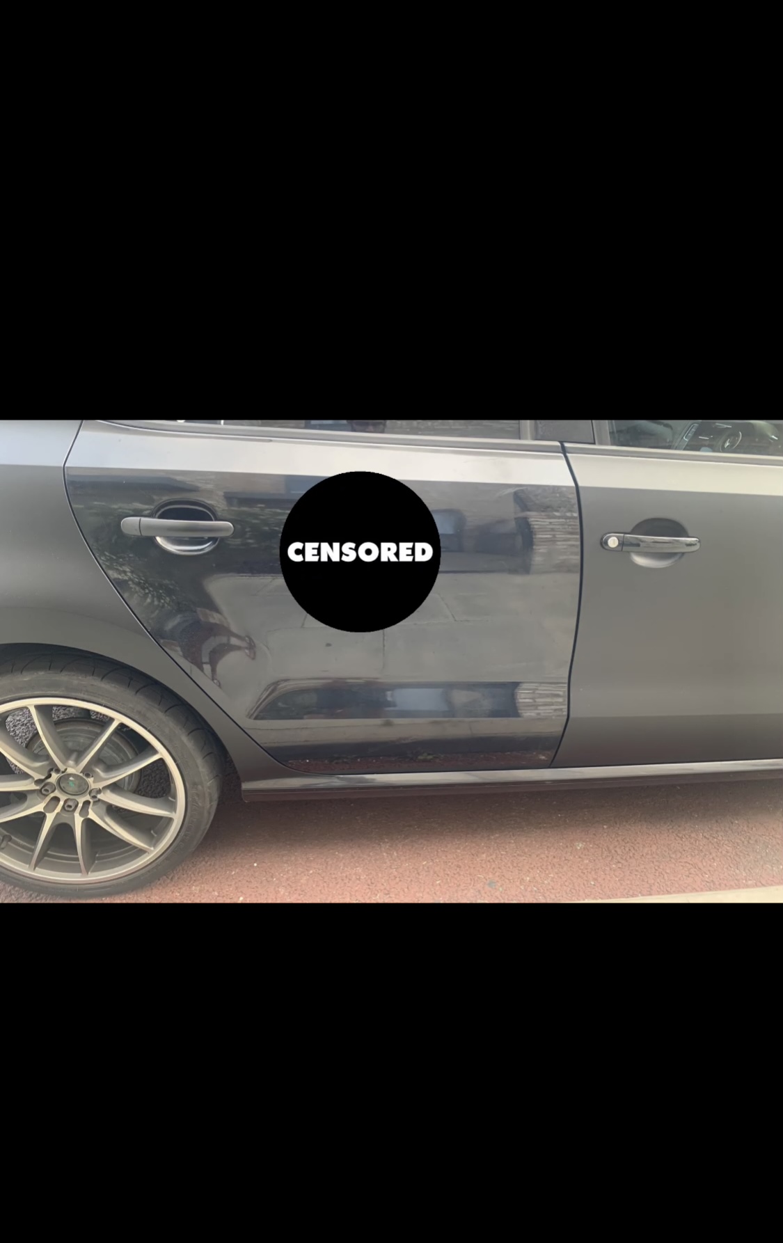

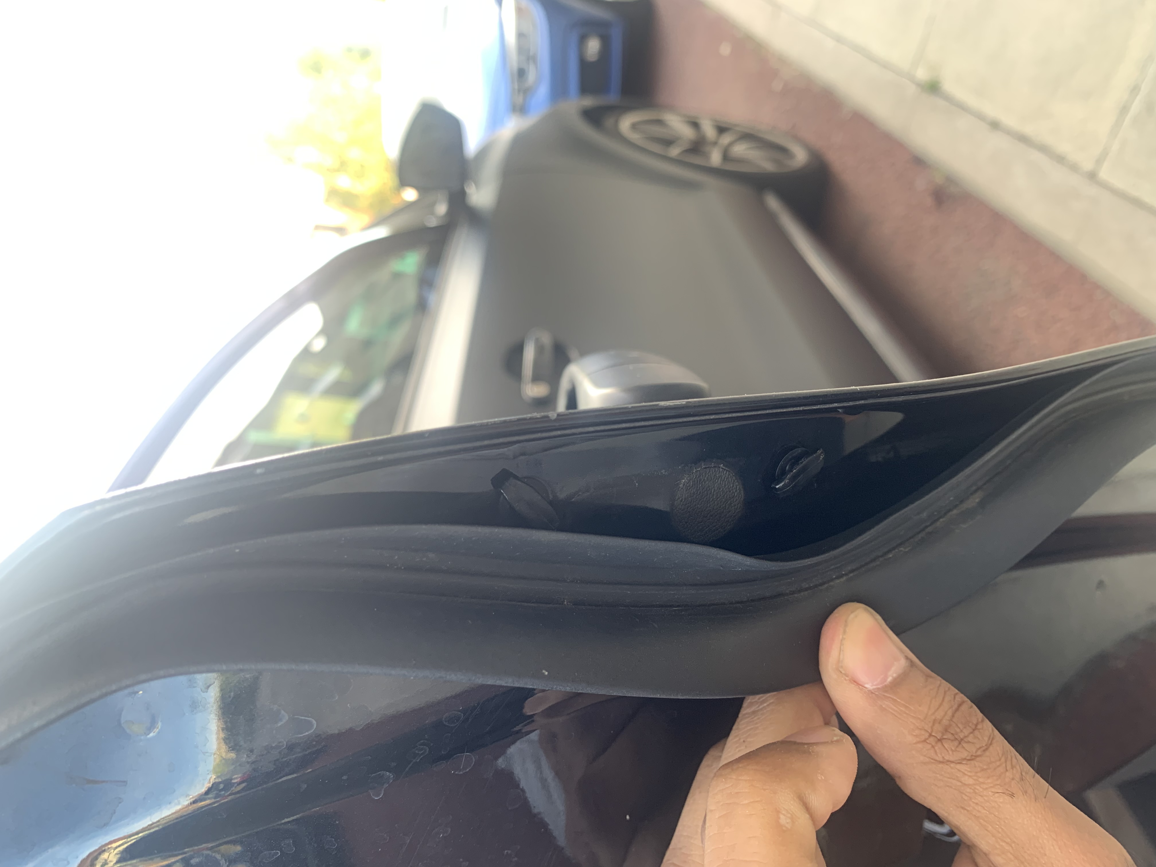

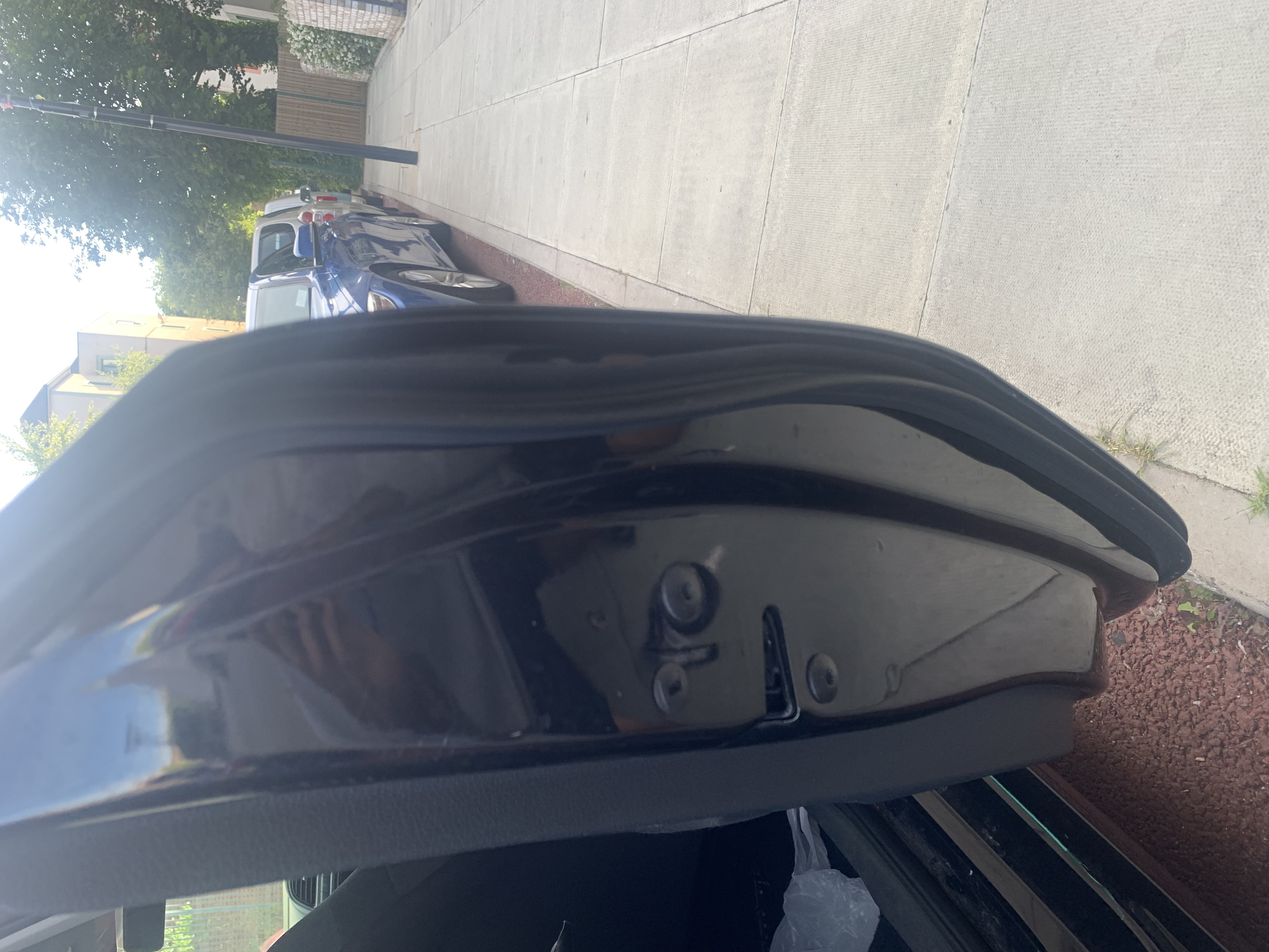

Have looked far and wide across the internet and cannot find any information on how to remove the rear door handle on a Polo 6R 2011.
All sources suggest theres a hole under the weather strip parallel to the door handle where you can stick in the handle removal tool and pull back however my door does not have said hole. I have attached a picture of what mines looks like instead.

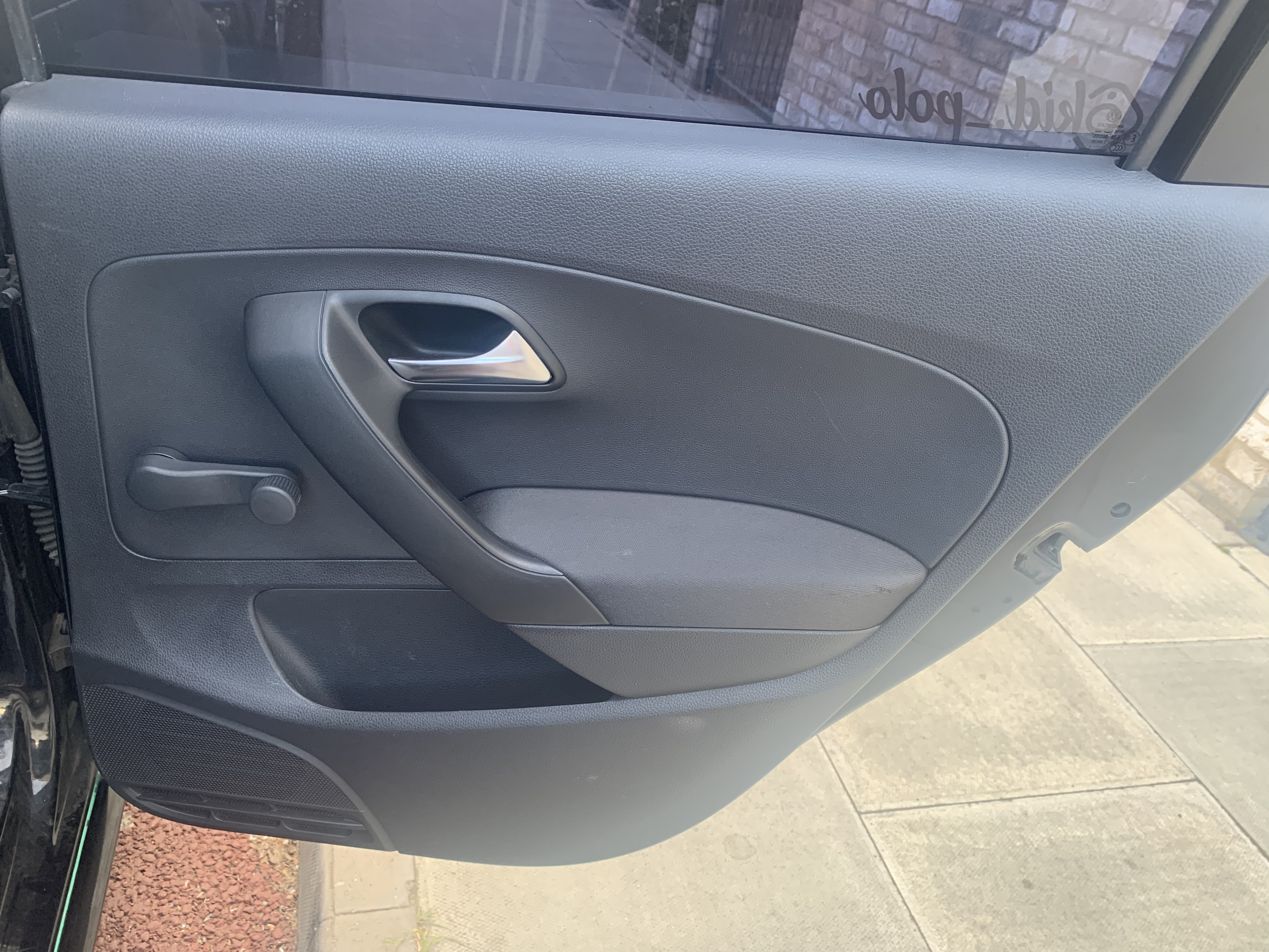

I’ve attached a picture of what my door looks like as well the door card. Please help asap if you have any idea.
Thank you

Just remove the sticker from the hole and all unnecessary question marks from your post please.

Have you removed the sticker and seen this work yourself? It doesn’t seem like a sticker that wants to / should be removed.
I’ve tried prying at it and doesn’t seem to budge. Will continue trying to force it off if you’re confident it’s the correct method

Yes I am sure it is the hole under the rubber

Have tried to continue to pry it off but the sticker doesn’t seem to move.
Will try again and update the thread tomorrow when I have a heat gun which will hopefully help.
Also by any chance have you got a part number / link / part name for a replacement sticker as I want it to return to how it was.

Thank you I appreciate all your help on this matter. How did you manage to get the sticker off? Did you also have difficulty with it in that it’s extremely strongly bonded on.
Hoping someone can give me an official replacement part as this is a customers vehicle that’s being wrapped and need it to go back exactly as it was found.

Update: was not able to take the sticker/rubber off after much frustration will have to take a knife to it tomorrow it seems.
Can someone else please confirm if this is the correct passage to remove the door handle before I do so.

Looks as if it’s probably item no 12 on the diagram at the link below. If so, then it’s described as webbing adhesive tape - part no. D 437S40A1rashel54321 wrote: Mon Jun 27, 2022 10:24 pm I would call them just don’t know what exactly it’s called or how to explain it to them as there is no part number.
https://volkswagen.7zap.com/en/rdw/polo ... 39-839000/
