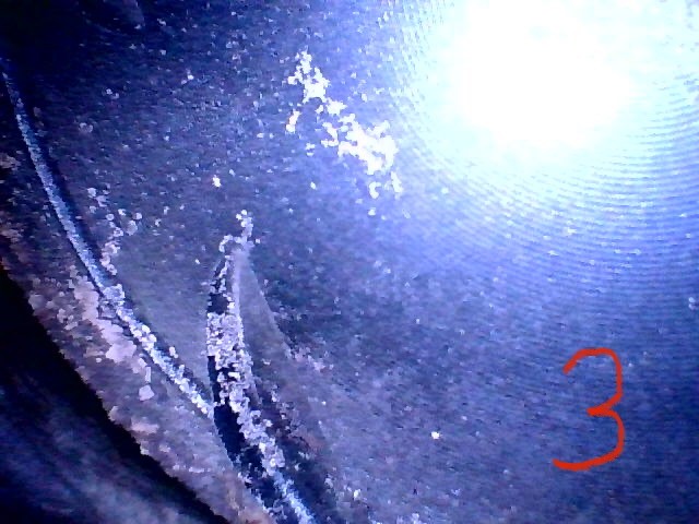

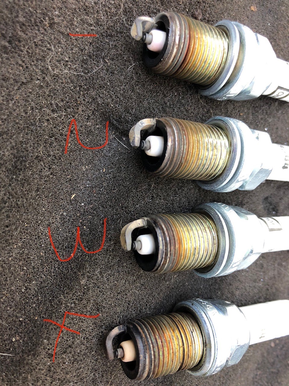

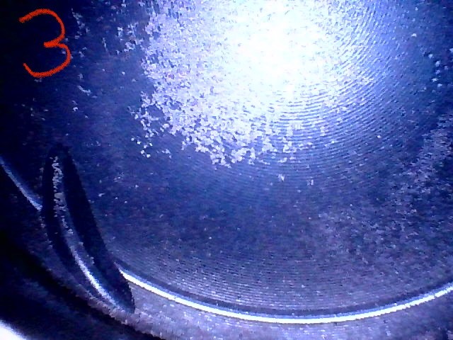

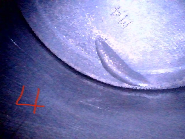

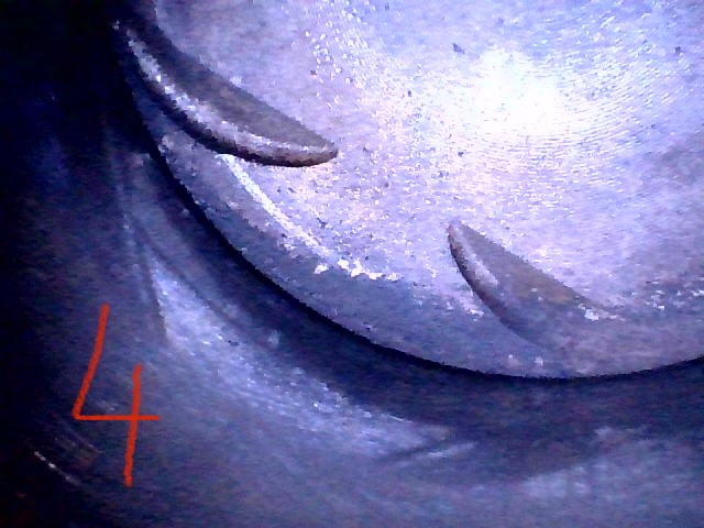

I checked the plugs, 3 are perfect. No.4 has slight dirt build up on the earth electrode and it is browner than the others. (see picture)
In the bores pistons 1 to 3 have a slight carbon build up, no.4 is clean (see pictures)
spark plugs.jpg (497.2 KiB) Viewed 24318 times
To me both of the above are indicators of water in the cylinder, the plumes of white smoke were also obvious but now it doesn't do it even when hot.
