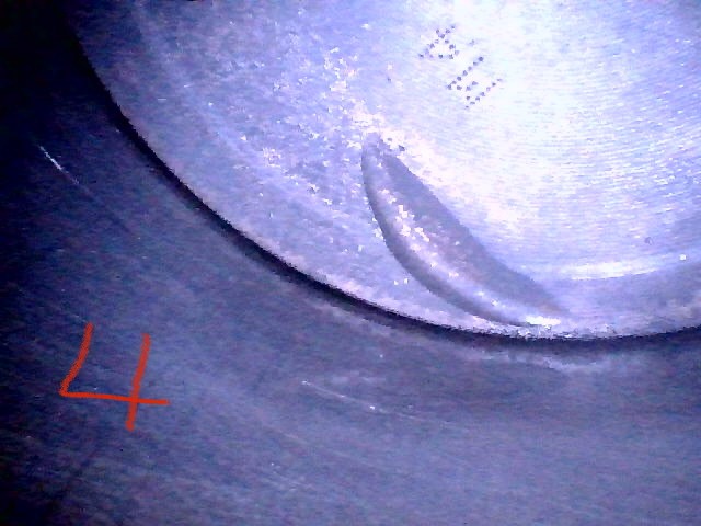

I checked the plugs, 3 are perfect. No.4 has slight dirt build up on the earth electrode and it is browner than the others. (see picture)
In the bores pistons 1 to 3 have a slight carbon build up, no.4 is clean (see pictures)
spark plugs.jpg (497.2 KiB) Viewed 24324 times
To me both of the above are indicators of water in the cylinder, the plumes of white smoke were also obvious but now it doesn't do it even when hot.
I haven't done enough miles to say if it is using water and the oil is still perfectly clean. It's 20 years old but only done 7,700 miles - that's not a typo.
So is that enough evidence that it's a head gasket? I could do a compression test but don't have anything to do a dye test. Any input is appreciated.
