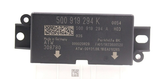

I am trying to retrofit the 8k OPS with auto detect module ( 5Q0919294K )

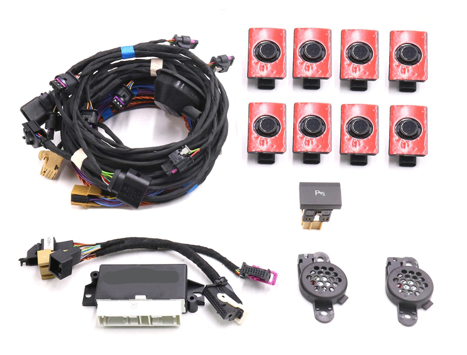

Whole kit I bought from Chinese seller
Screenshot 2022-07-23 144224.png (676.77 KiB) Viewed 14472 times

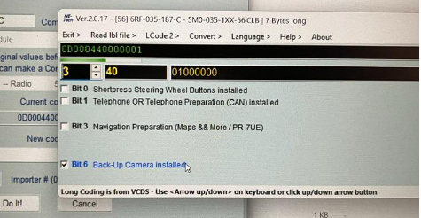

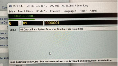

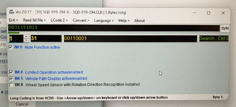

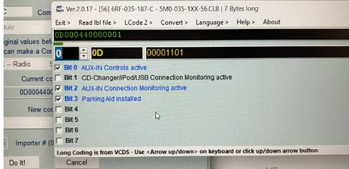

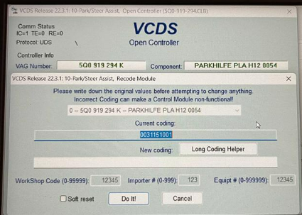

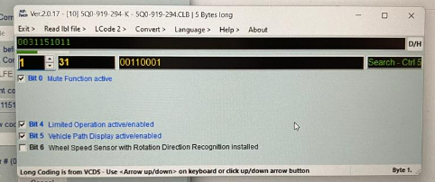

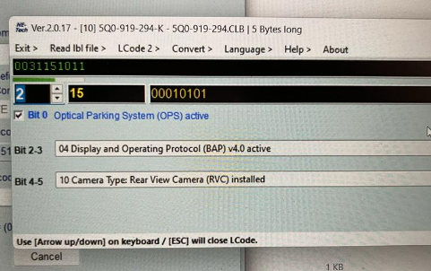

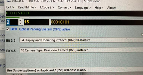

Screenshot 2022-07-23 144836.png (171.42 KiB) Viewed 14472 times
Screenshot 2022-07-23 144821.png (160.67 KiB) Viewed 14472 times
Screenshot 2022-07-23 144809.png (184.79 KiB) Viewed 14472 times
Screenshot 2022-07-23 144757.png (130.25 KiB) Viewed 14472 times
Screenshot 2022-07-23 144742.png (190.66 KiB) Viewed 14472 times
Screenshot 2022-07-23 144728.png (137.37 KiB) Viewed 14472 times
Screenshot 2022-07-23 144644.png (213.98 KiB) Viewed 14472 times
Screenshot 2022-07-23 144617.png (176.18 KiB) Viewed 14472 times
After all the efforts it did not work,
I started getting info and suggestions around, got to know that it won't work on non-ABS cars
ABS is mandatory.
Kindly suggest whether I should accept it and stop this installation or if there is another way.
