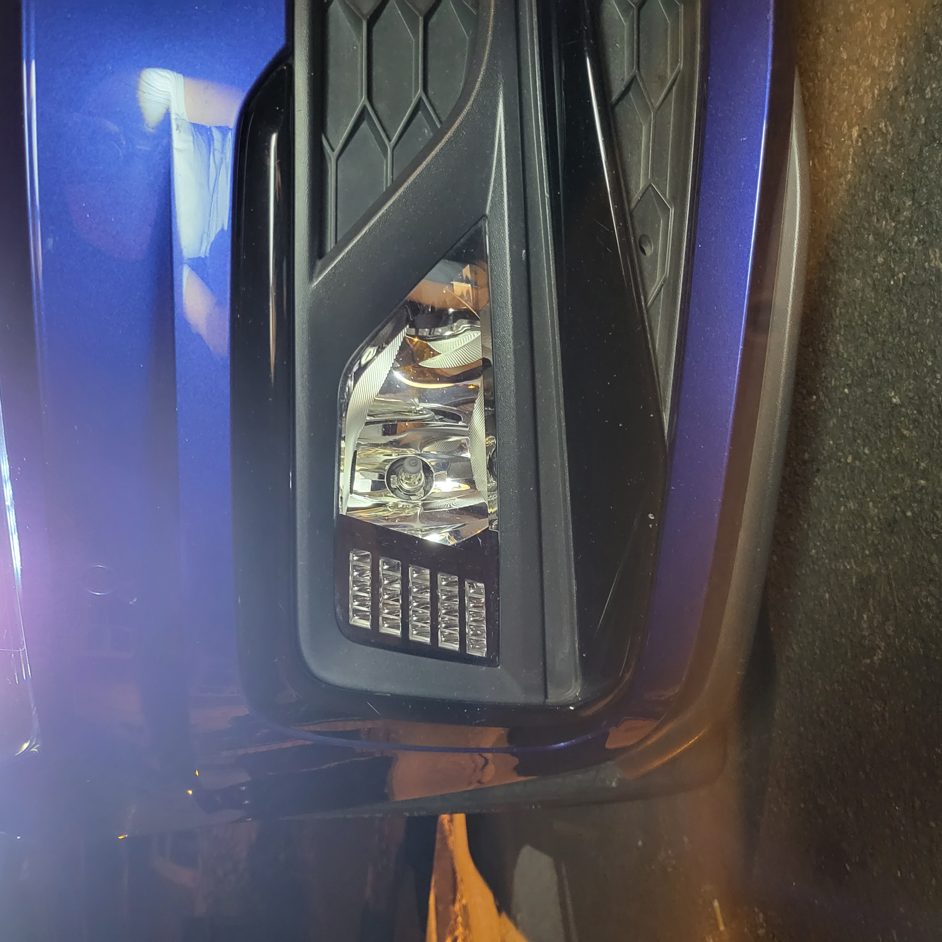

Firstly, Hi all.
Hoping i can get an answer to this question because its bugging me now.
I'm trying to activate the led fog light for my polo, there's the normal halogen bulb for the fog light but on the outer sides of them they have led dots lets call them. I've seen many non GTI polos that have them on but just wondering how they turn on.
Apreciate it, thanks.

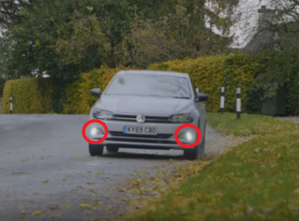

Welcome to UK-Polos Nasaa, I'm assuming that you will have LED headlights fitted to your GTI, if so the led DRLs you're referring to are just for show, your DRLs are built into the headlights.
You only get these lights with 'standard' non-led headlights.

@Nassa_97; The standard AW GTI model (and other AW Polo models) has halogen headlamps and as you’ve said, on AW Polos with halogen headlamps those outer sections do function as DRL’s. However, on the higher spec AW GTI+ model with LED headlamps and DRL’s integrated into the headlamp units (or other Polos where LED headlamps were spec’d by the first owner as an extra cost option) then those outer sections of the fog light / cornering light unit in the lower bumper aren’t operative. As far as I’m aware, they don’t contain any LED lighting units and aren’t wired up, so they’re purely cosmetic with no working functionality. I seem to remember there was someone on the forum a few years ago with one of the first AW GTI+ Polos who accessed the rear of that fog light / cornering light unit to check, as they were asking the same question as you, and it was just an empty void.
No doubt It would’ve been more cost effective (cheaper) for VW to fit the same fog light / cornering light / DRL lighting unit across the entire AW Polo range, rather than have a different specific unit for cars with LED headlamps.
