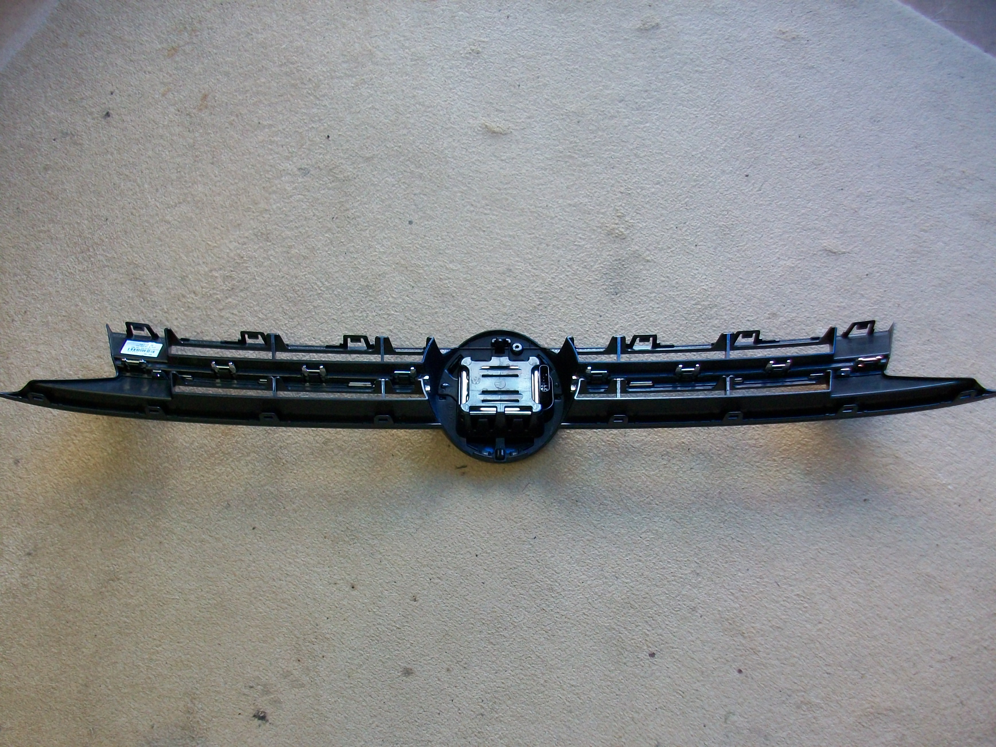

No I don't have Instagram, yes you need to detach the top of the grille from the body-coloured strip, you can release a couple of them by putting your fingers under the top rail of the grille, and I'm now thinking this is why the headlights might need to come out, I don't think you can reach the 2 end clips from the front of the grille, here's a picture of the back of the grille showing the clips.

If you look at my picture, you can see where you can get your fingers under to press the 4 innermost clips (press clips up and pull outwards), but you can't do this with the 2 end clips, so I think the headlight needs to come out. As I said earlier, it's a while since I lads did mine, and I can't just get to see my car right now.
