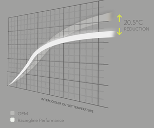

By the way, this graph seems weird since x-axis is indicated as intercooler outlet temp. but this should be y-axis as what we want to reduce.
I can't read which temp. is reduced by 20.5degC.
Polo GTI AW Performance Intercooler 2.0 TSI RacingLine.png (52.2 KiB) Viewed 2318 times
