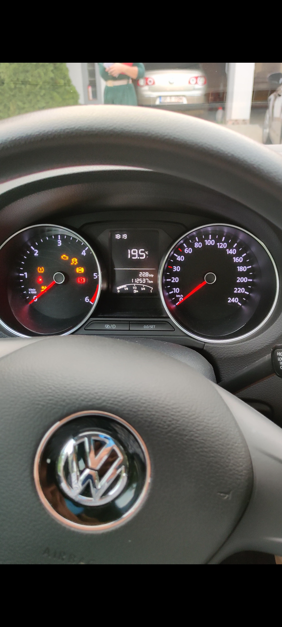

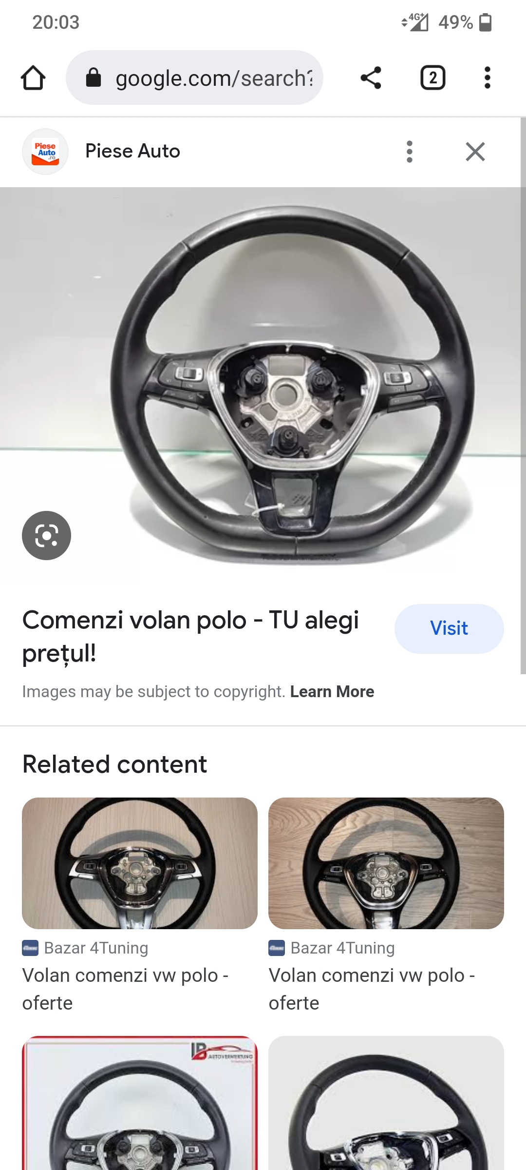

Hello! I have a question, i have a vw polo 2015. I want to activate some functions on my IC like(range, oil temperature, consumptioj) and I don't have the lever with button on the wiper. If i put this steering wheel, i can have this functions? Thank you!

This steering wheel is going to operate only if you have the correct BCM .
So you must check the BCM code. If your car has a BCM with code 6C0937089x or bigger number (6C0937090x) then it is OK, you can install a steering wheel with buttons.
If you car has a BCM with code 6C0937087x then you can't. You have to swap the BCM first with a new one , to program the BCM online and the to proceed with the steering wheel.
The is a easier way to have what you want; to swap the stalks from the steering column.
Take a look here:
viewtopic.php?t=76538
