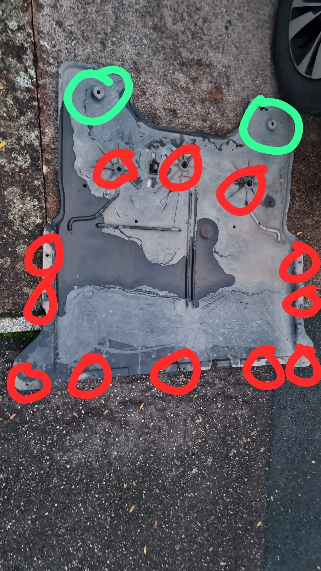

First picture
  • The red on the outside (x9) are all T25 Torx screws
  • The red on the inside (x3) are the T45 Torx screws

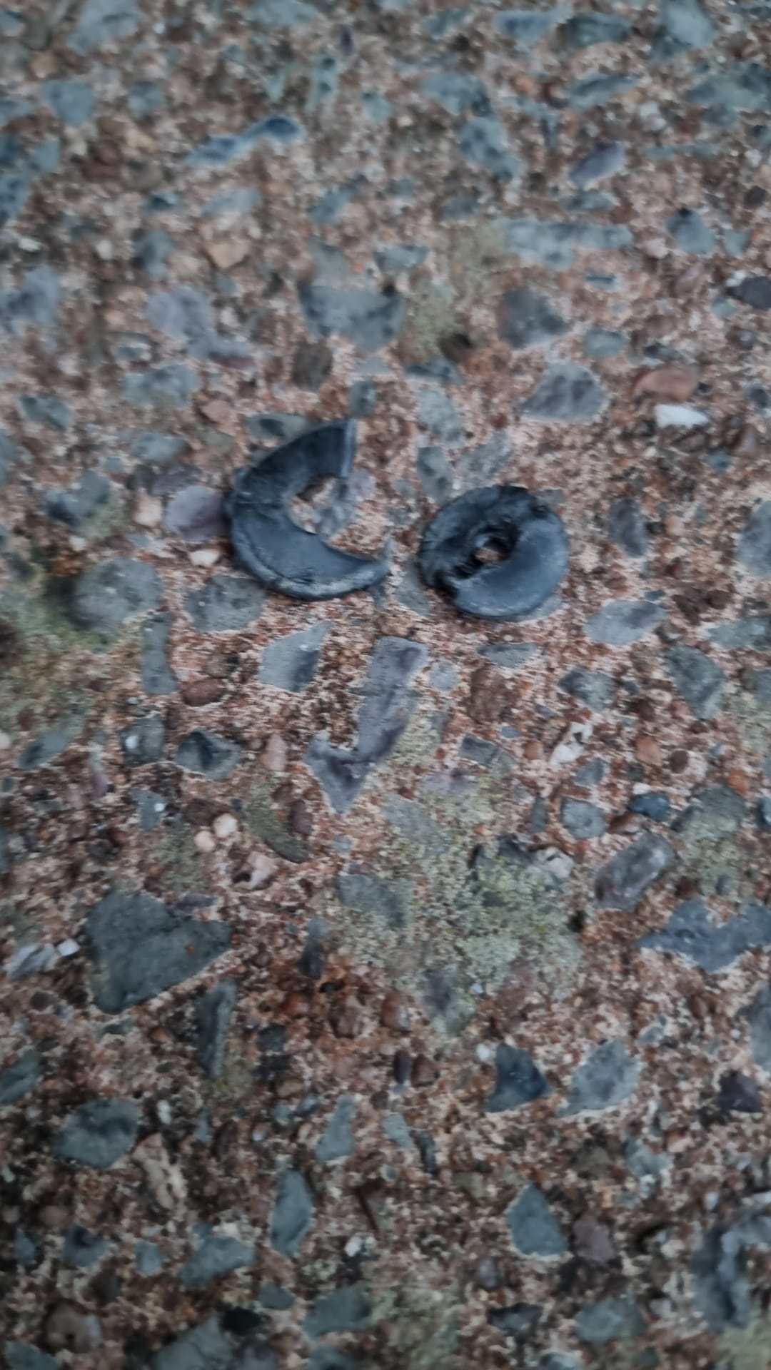

  • The green are these 2 fixing that caused me so much grief

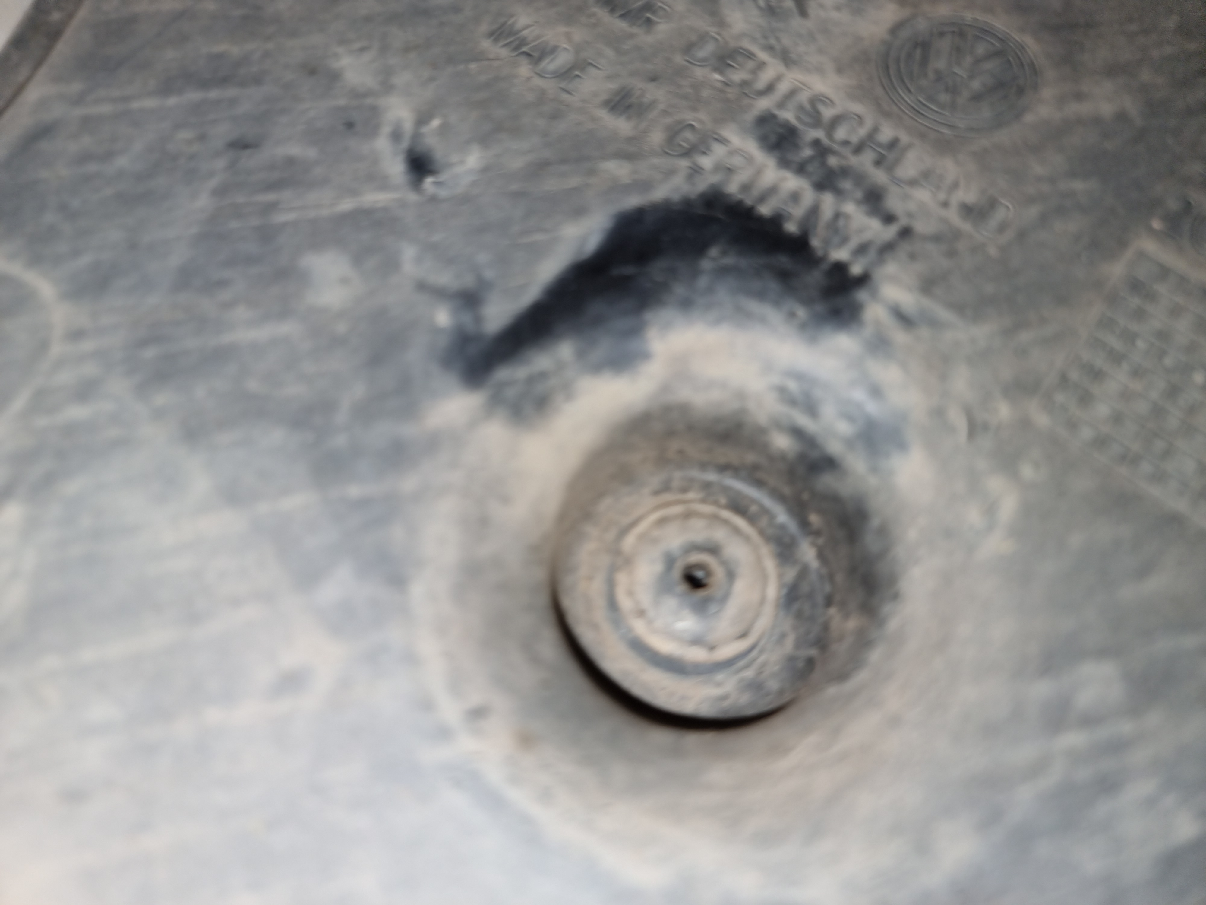

Second picture
This is what the fixing looked like before I massacred it with pliers

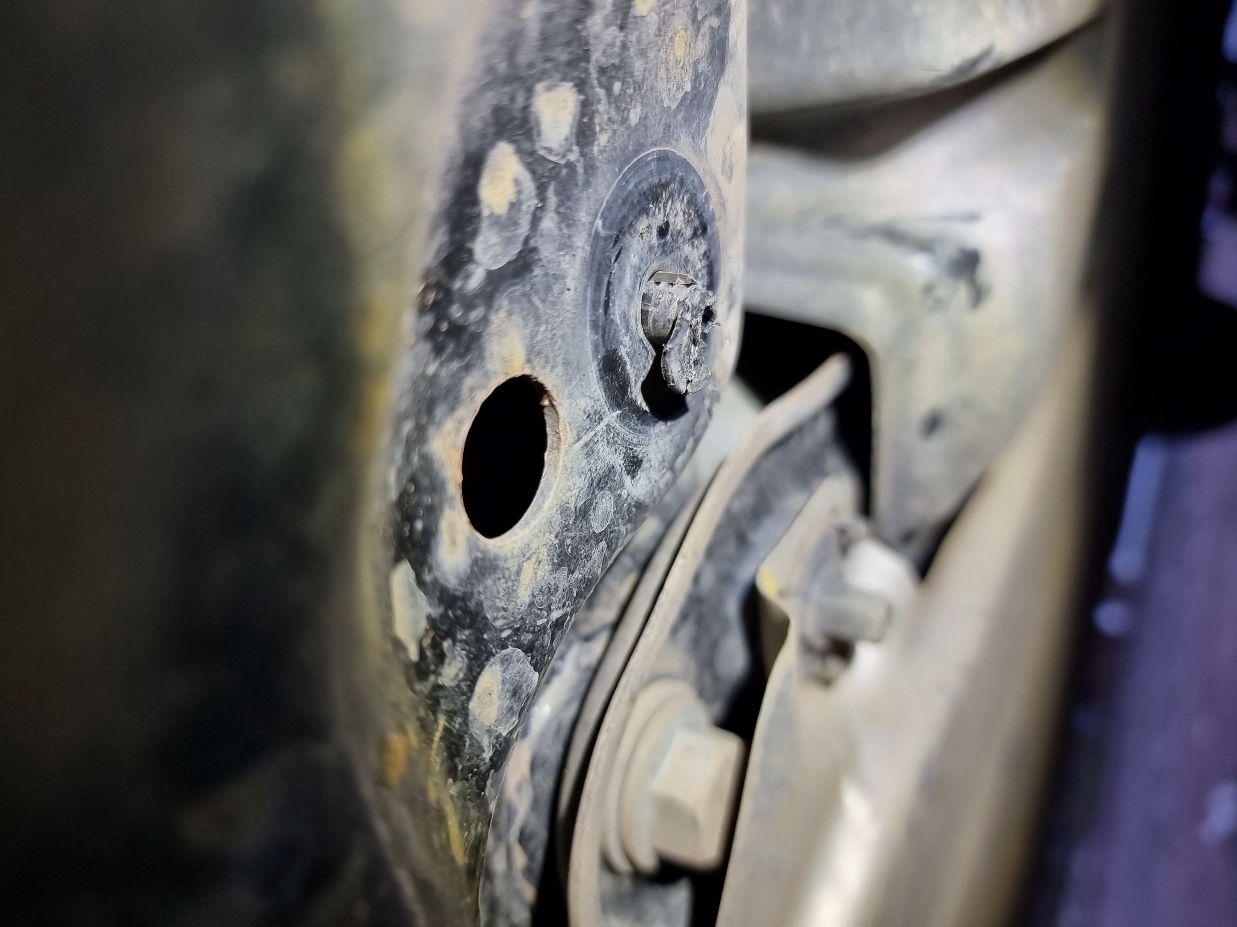

Third picture

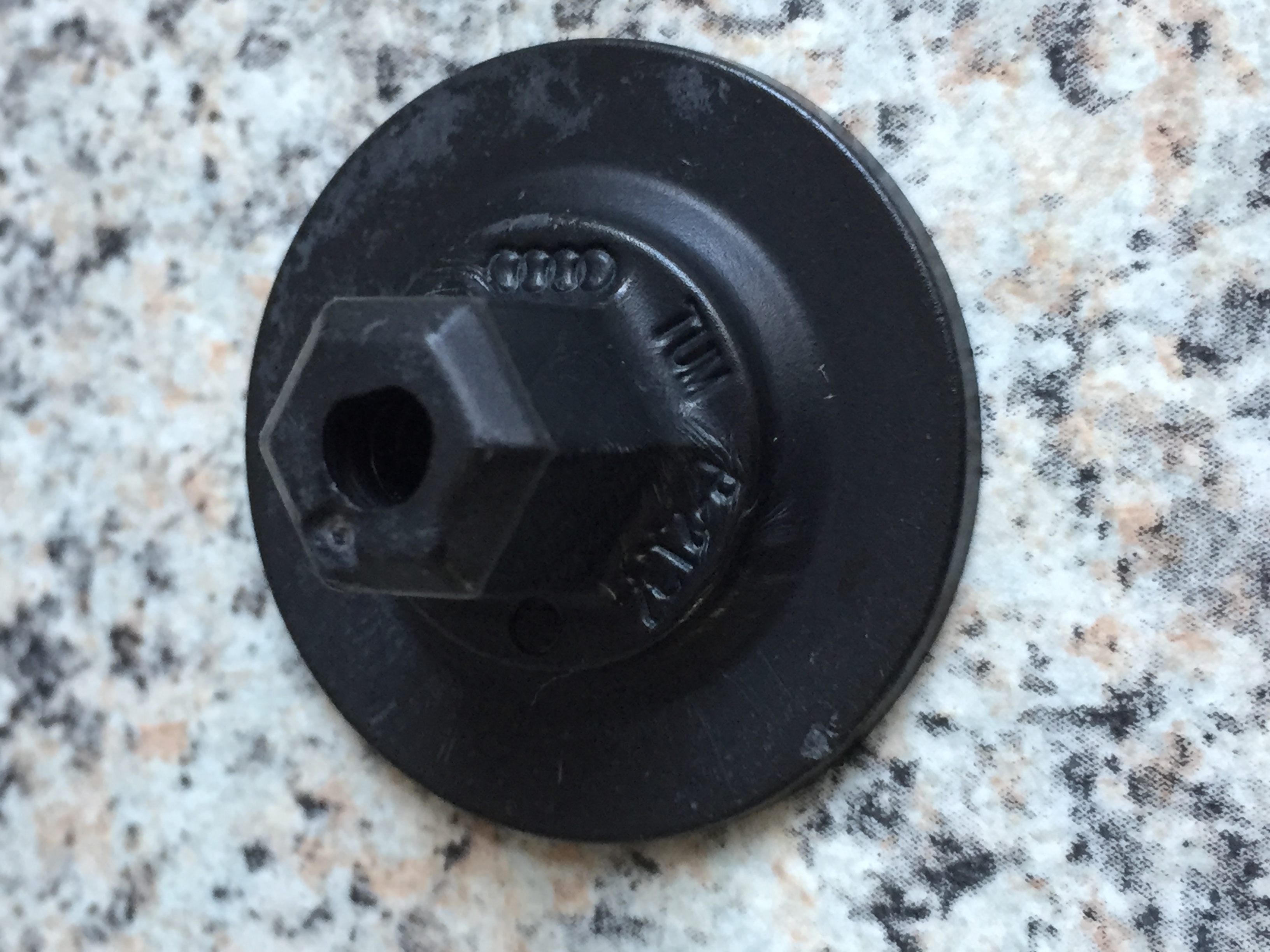

This is what I had to pull off the clips to get the undertray off - each one seem to have 2 layers like this (the fourth photo shows what was left on the car)

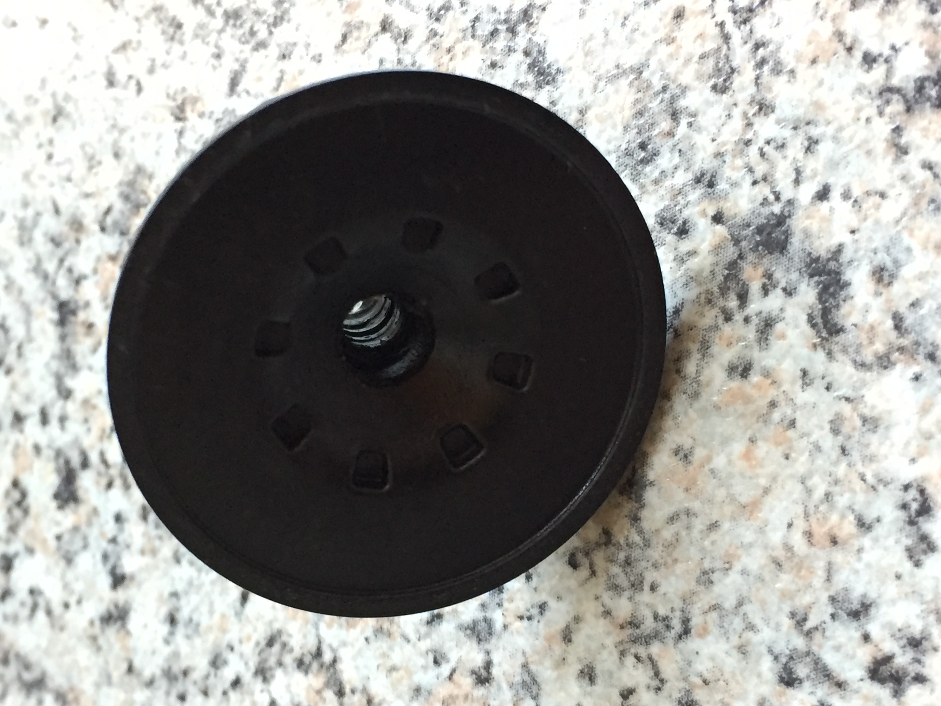

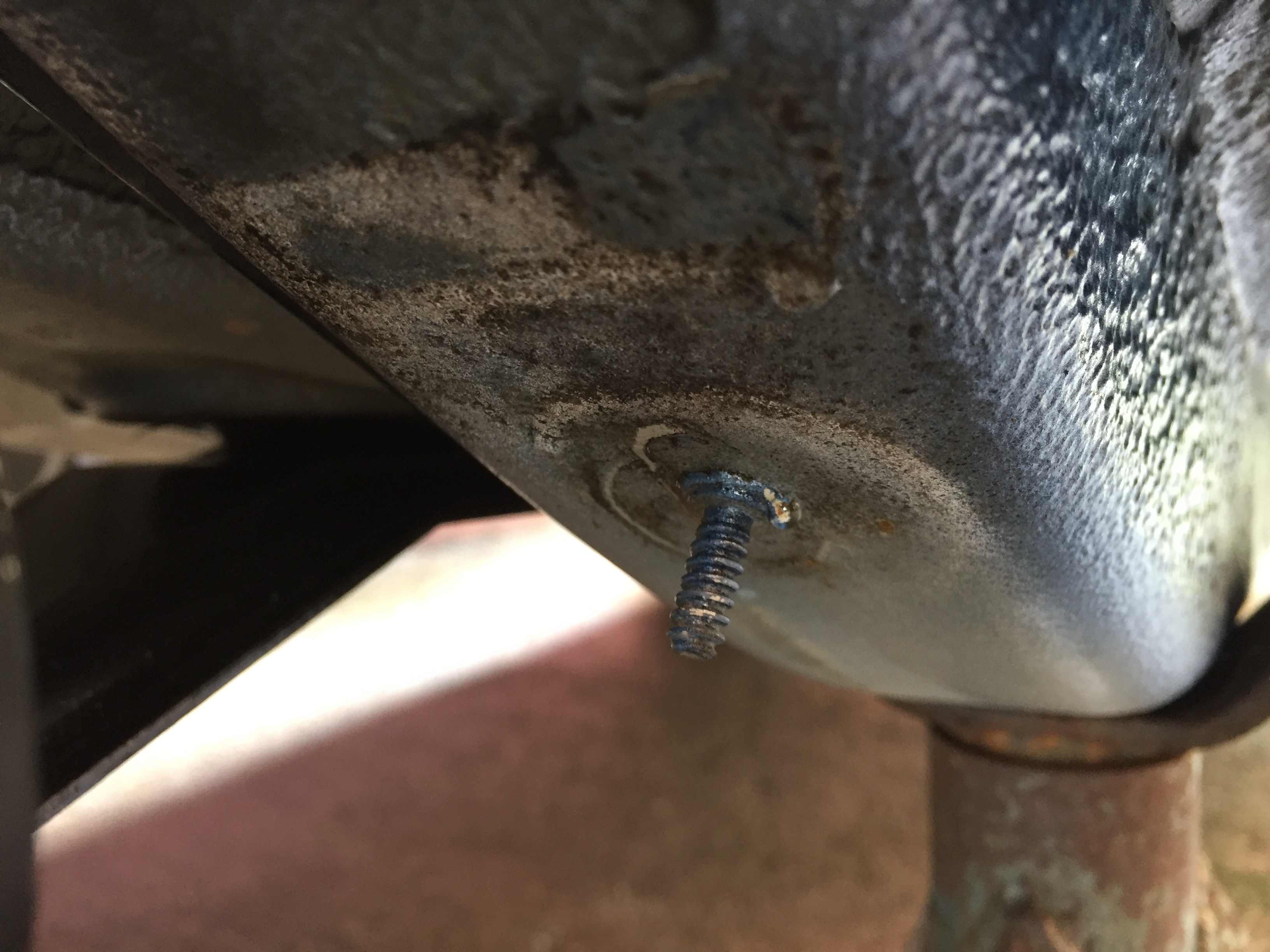

Fourth picture

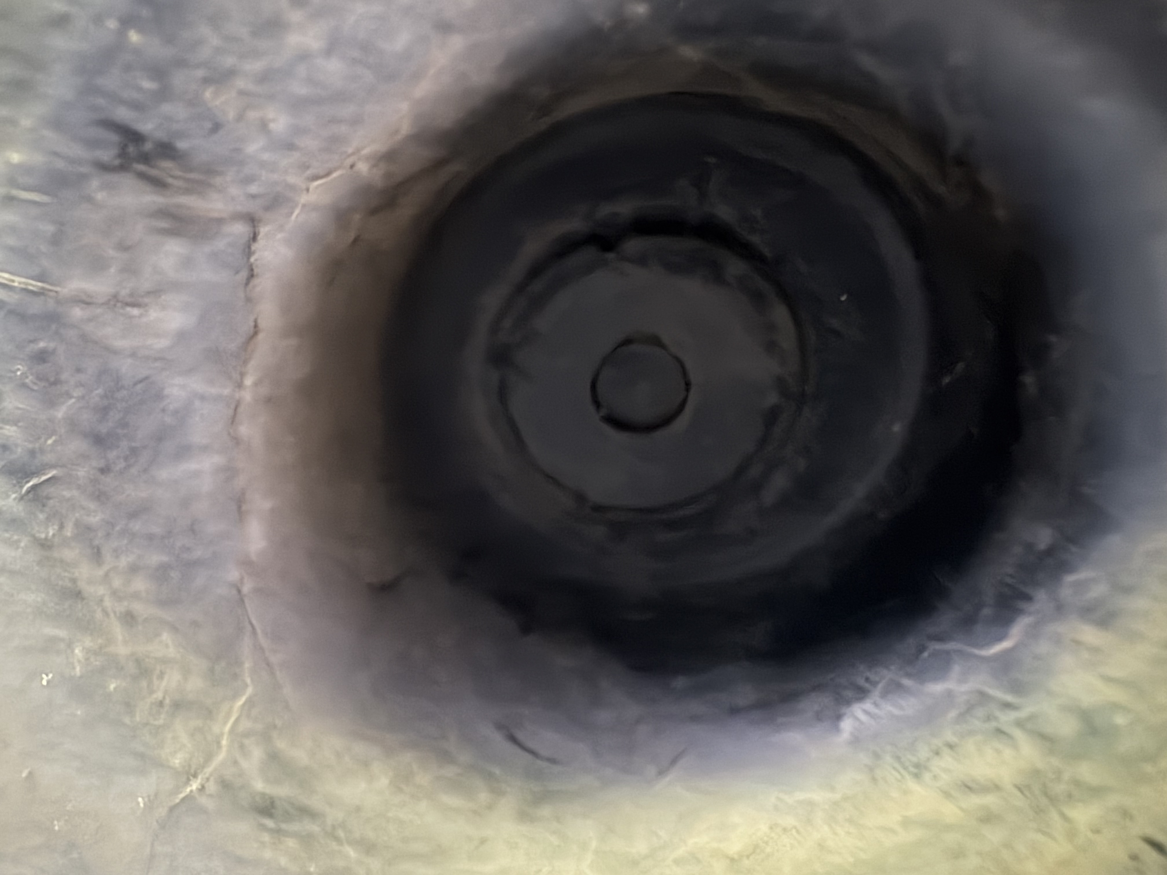

This is after I massacred the fixing, you can see the thread poking through (the bit of plastic attached to the thread is the remains of what I removed in the third picture)

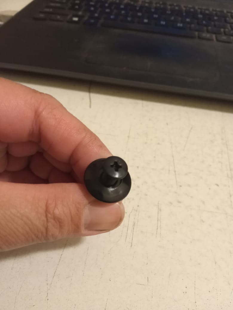

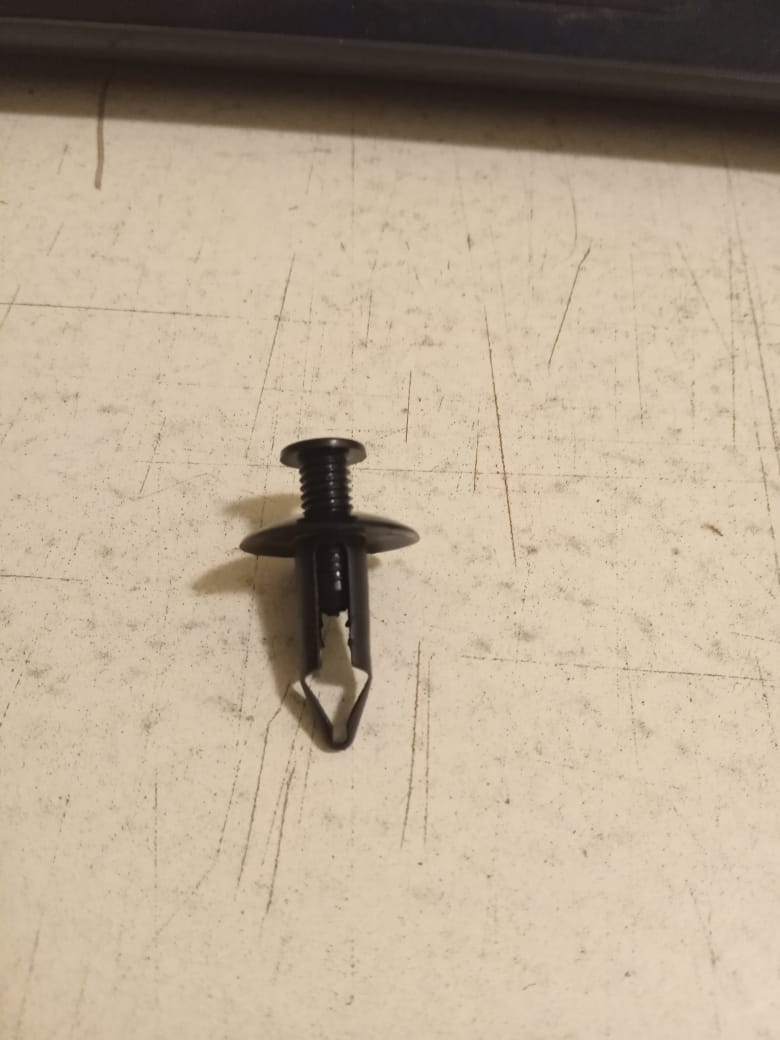

It looks like standard interior car clips you find everywhere on car and bike. Where you either push or screw the plug in so the back expand.
like theese

You’re best way forward in my opinion would be to use the 10mm type nuts commonly used on VAG cars to fix the underbody protection panels
These use a course threaded stud which from your picture looks like you already have

Ping wrote: Sun Oct 23, 2022 10:40 am It looks like standard interior car clips you find everywhere on car and bike. Where you either push or screw the plug in so the back expand.
Thanks for the reply, but it's definitely not these - I'm very familiar with these types of panel clips (screw and push type) and it wasn't these.

CarbonChaos wrote: Sun Oct 23, 2022 12:56 pm You’re best way forward in my opinion would be to use the 10mm type nuts commonly used on VAG cars to fix the underbody protection panels
Oh thank you very much, that's a great solution - I'll order some now and see how I get on.

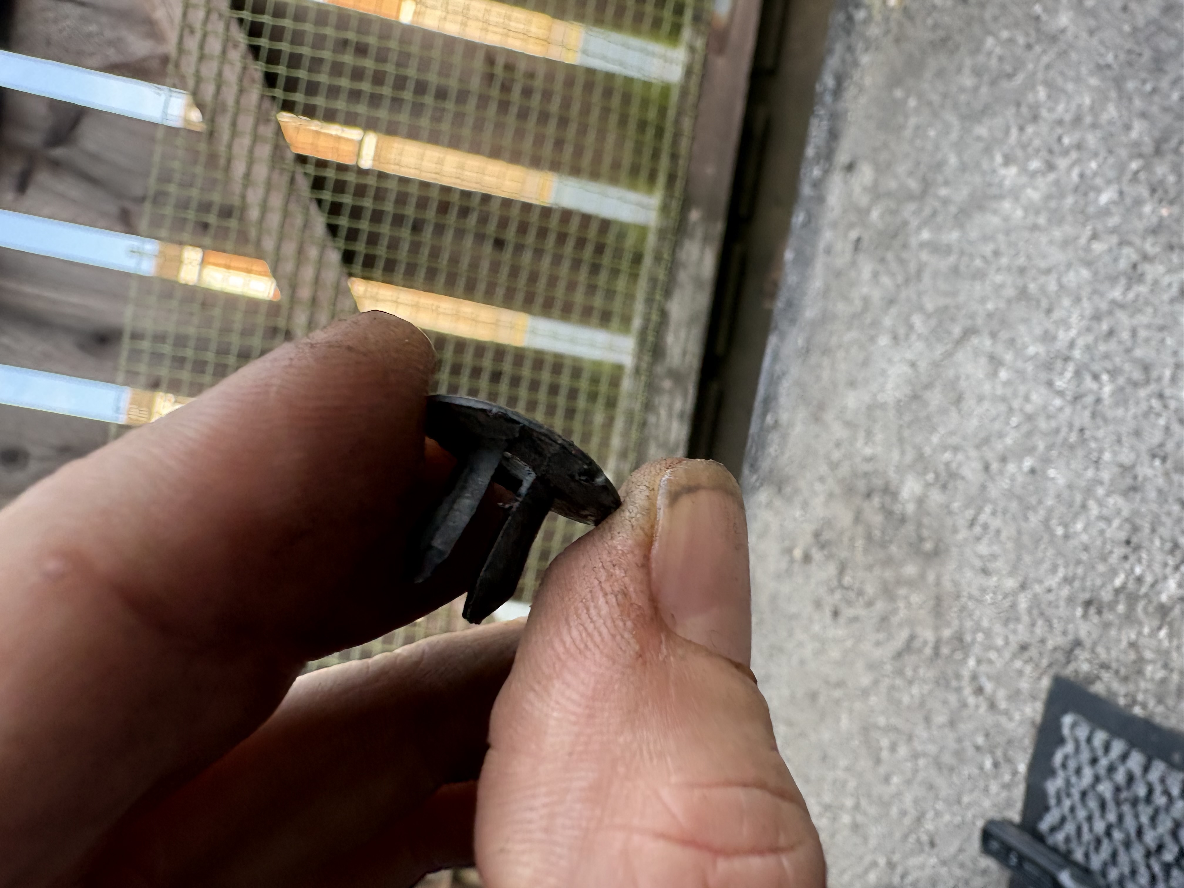

The original allen head clip's plastic is very soft and breaks easy, I replace it with these harder plastic clips.

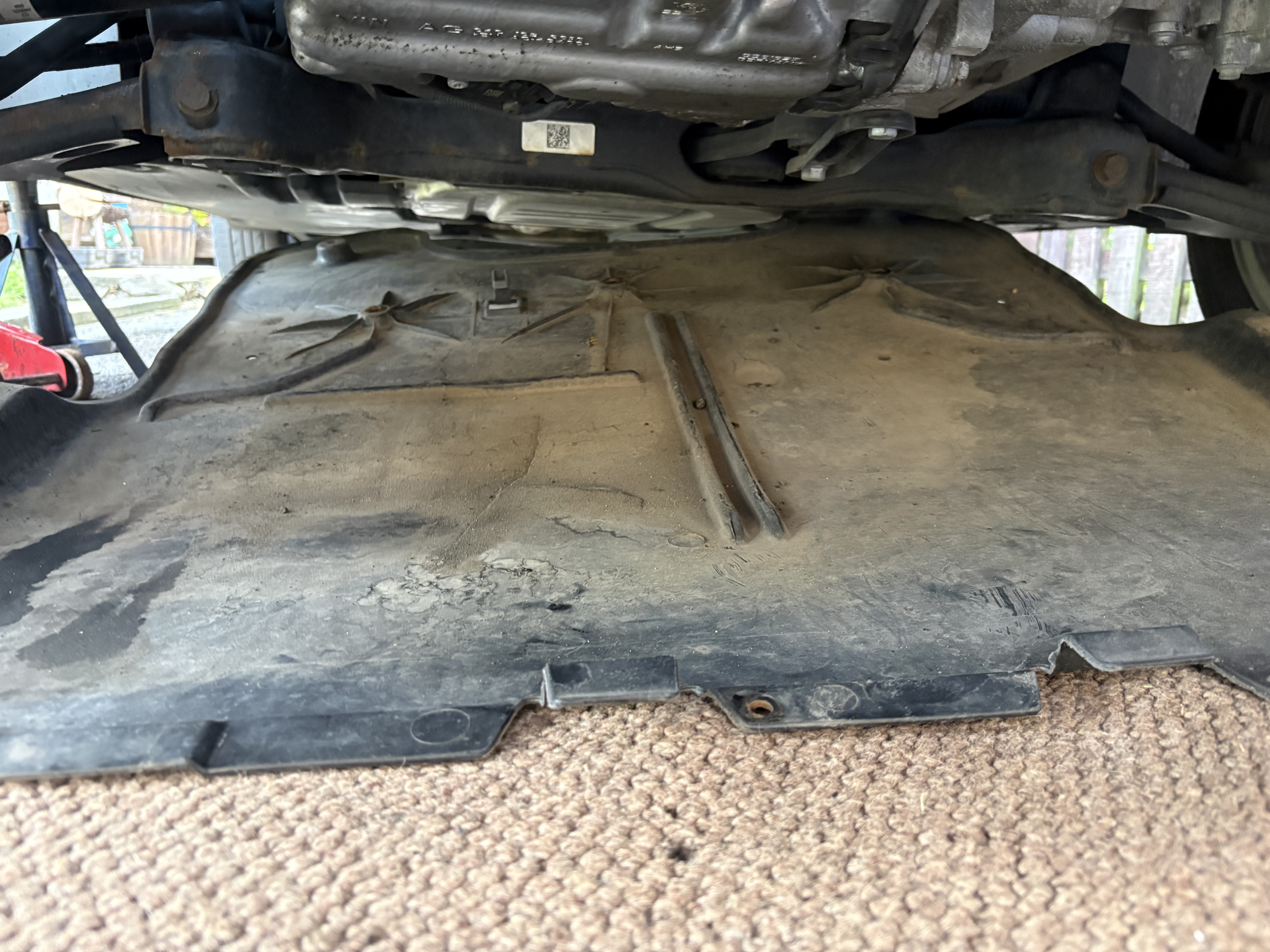

Hi
Very interested in your post re undertray. Especially as mine has been serviced by VW while under warranty but is now outside of the warranty period i decided to do it myself.
I found no plastic clips there at all. Just left loose. I assumed that was ok as the other screws seem to hold it securley.
Did you manger to find the correct fixings (i think i should get some).
Also, how did you get yours on axel stands? i jacked the back untill it was high enough to get a stand under the front jack point. Not the best solution. Any help / advice much appricated.

Just need to use a small screwdriver and knock the centre out, then replace with new clip.
Oil can be serviced with only one rear clip removed.
