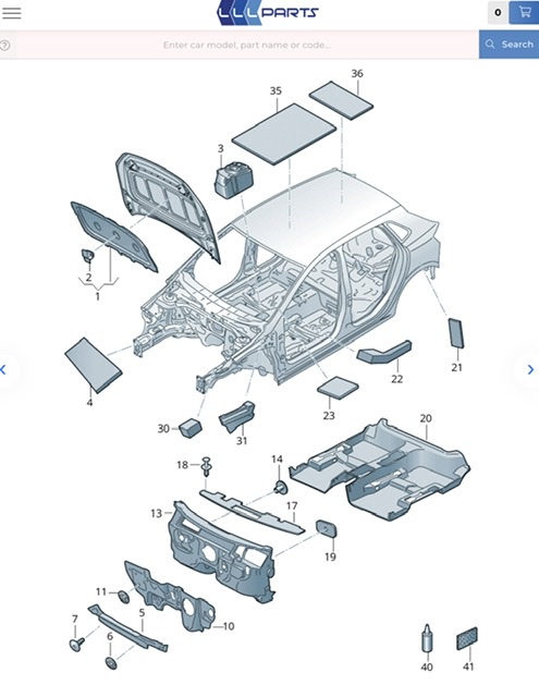

This one’s a bit of a stab in the dark; the diagram below shows the location of the insulation fitted to the AW model Polo and from the diagram it doesn’t look as if there are any specific sound absorption parts fitted in the suspected area of your unwanted noise source. However noise does travel, so if item 31 on the diagram has either become dislodged or has been removed, I’m wondering if it would be possible for unwanted noise to travel up around the base of the A pillar and into your car’s interior? Not sure how likely this would be or how you’d check this out though; as said, a bit of a stab in the dark.
Link to parts listing on the diagram; https://www.lllparts.co.uk/product/volk ... /2g4868759

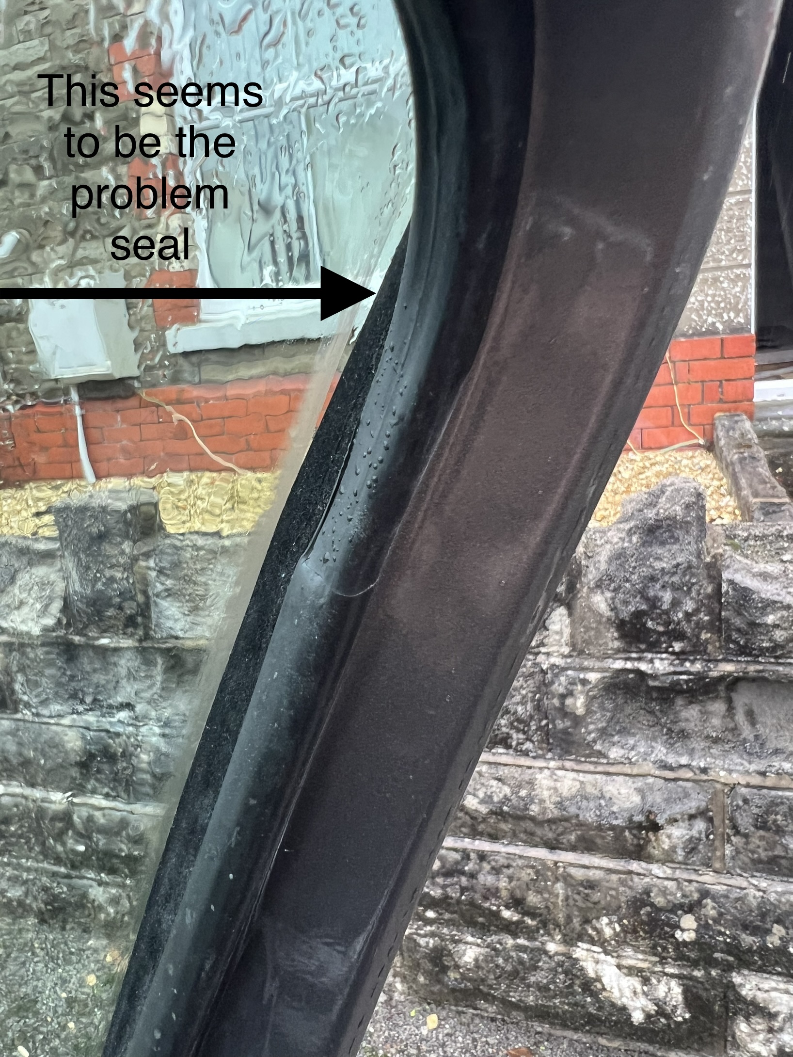

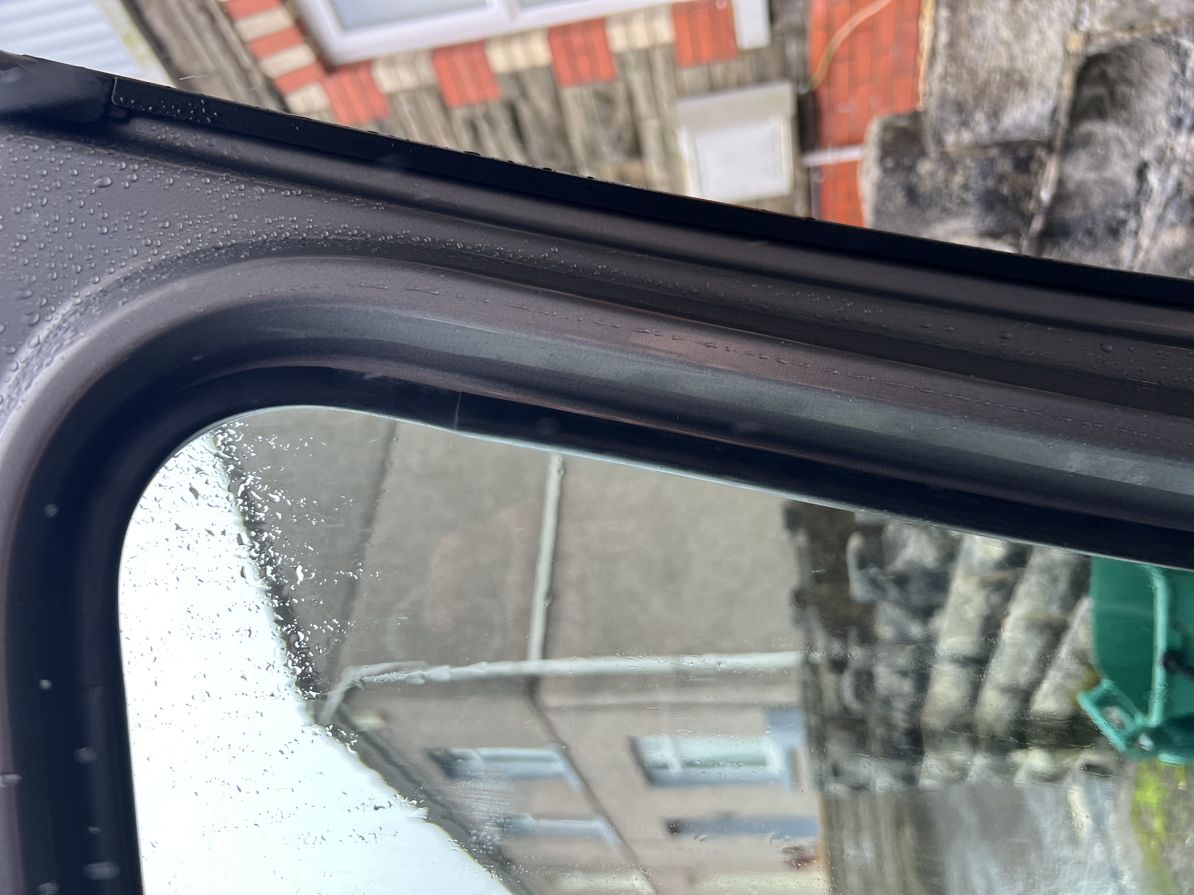

Ok I went out and checked all the things mentioned and could Not find anything wrong or missing. Anyway on the way back from a test drive out of sheer frustration I pushed the seal on the inside by the window out of its grove and would you believe it the noise completely stopped, so anyway I put the seal back on the correct way on the grove and back came the noise ha so done it one more time and and noise goes again so it has to be that seal needs replacing even tho it looks fine, Manet a bit loose like not seating probably anymore on the grove. Only problem is I have no idea what part number this seal would be.
- EC57561D-DBED-4B2A-A384-27E6C65A249C.jpeg (940.37 KiB) Viewed 2629 times
- Posts: 3847
Re: Help please, unacceptable cabin noise
Good that you’ve found the cause of the problem. If you can’t find the part number from various Google searches, then a VW dealership parts department should be able to tell you what it is.mattevs wrote: Sat Nov 05, 2022 11:43 am Ok I went out and checked all the things mentioned and could Not find anything wrong or missing. Anyway on the way back from a test drive out of sheer frustration I pushed the seal on the inside by the window out of its grove and would you believe it the noise completely stopped, so anyway I put the seal back on the correct way on the grove and back came the noise ha so done it one more time and and noise goes again so it has to be that seal needs replacing even tho it looks fine, Manet a bit loose like not seating probably anymore on the grove. Only problem is I have no idea what part number this seal would be.
