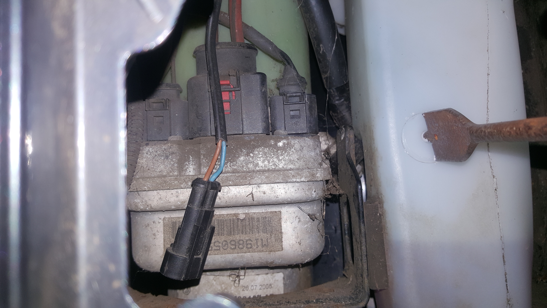

- Standard portable power drill (ie not a large heavy drill as there's not a lot of space to play with)
- A 25mm diameter flat hole cutter (see photos below) - the reason for using this tool and not a hole saw is the flat hole cutters are on a long shaft which you'll need when poking it through the space in the bumper front; hole saws tend to be shorter stubbier things unless you can extend one.

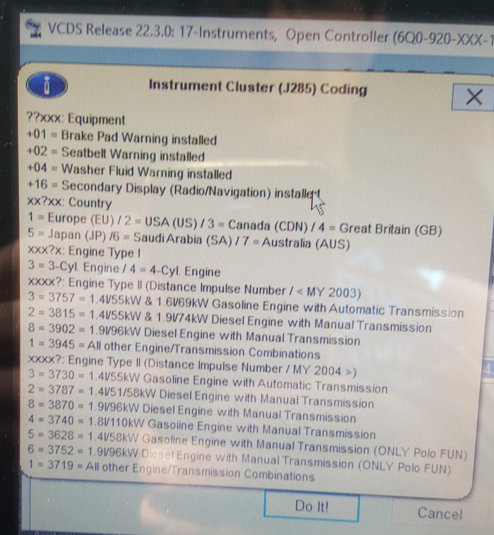

- Licensed version of VCDS and a laptop which you'll need to code your instrument cluster to read the sensor and display the caution lamp.

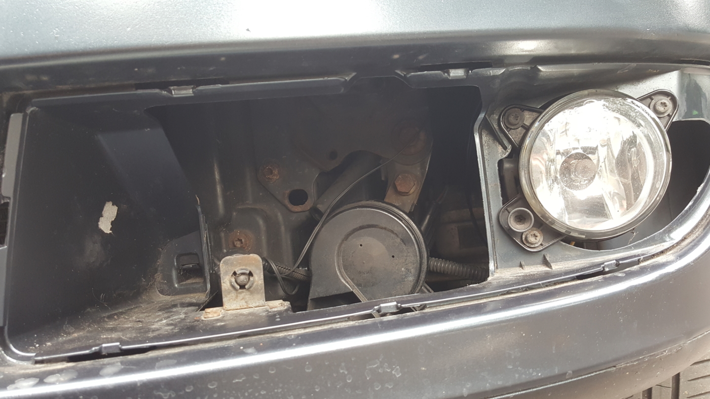

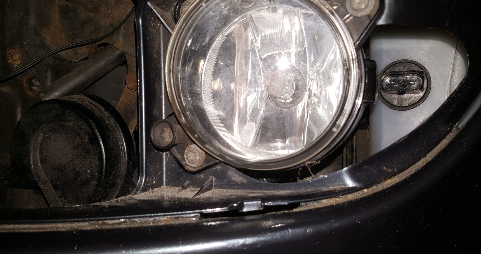

Pull out the nearside fog light grille (there is no fixing screw - that's only the offside grille). See Photo 1. Remove the 3 Torx screws (they have a washer on them) from the fog light surround). Don't stick your screwdriver into the funnel shaped hole as that one adjusts the aim of the lights. Reach around the rear of the fog light and unplug the connector, note there is very little spare play in this cabling. Take a moment now to thank The Good Lord that VW did not use the standard VAG wiring connector for the fog light and instead used a very easy-to-remove pinch plug. Phew! Remove fog light (photo 2) and place where it's not going to get smashed. That's it. No need to remove any undertray, engine sound plate or the wheel arch liner.

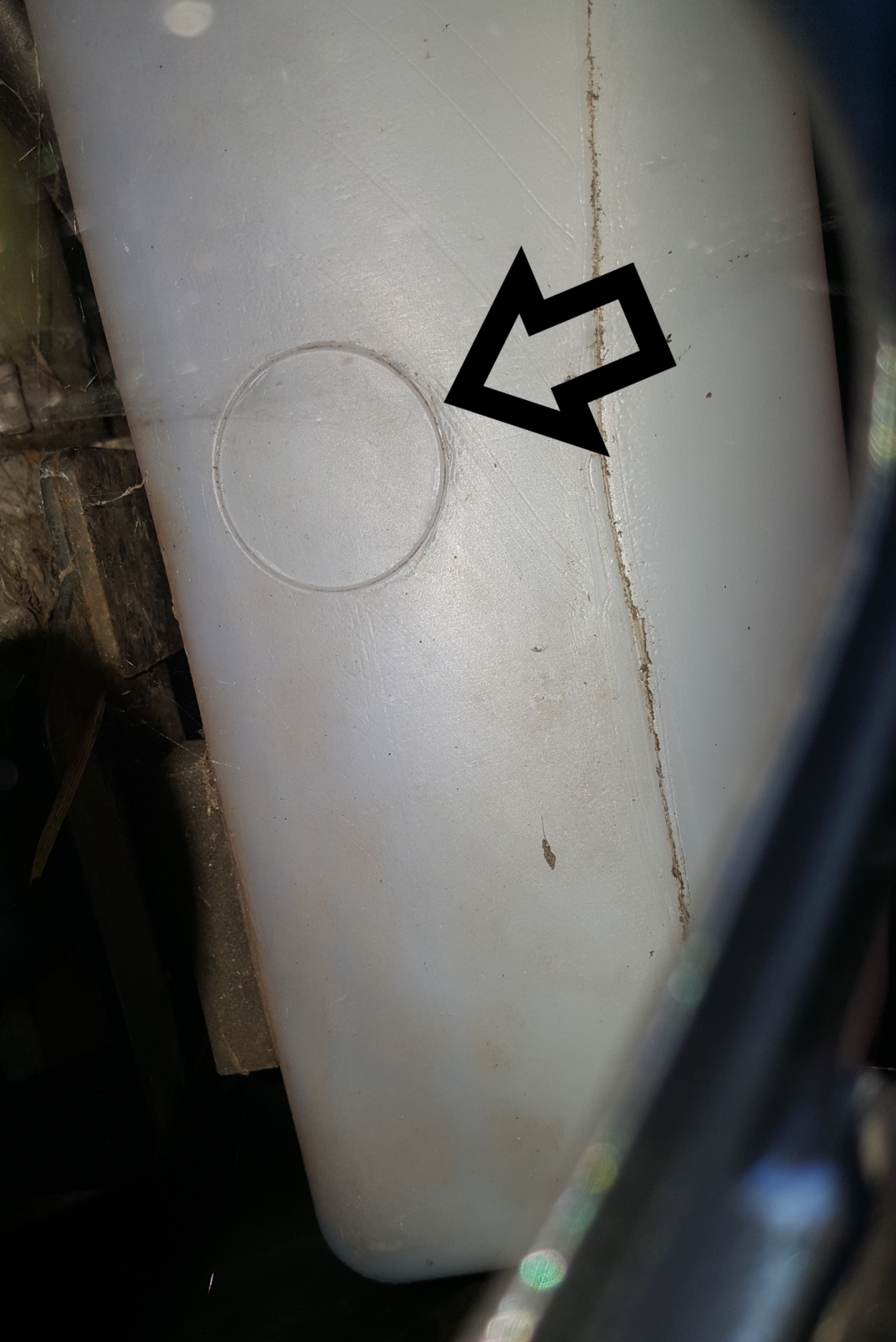

Decide where you want the sensor. In one guide I saw online, the bloke had drilled the hole so low down the bottle that it was barely higher than the pump intake - this is far from ideal since the whole point of the sensor is to tell you in good time when you start to run low, not when you are down to 2 or 3 squirts left..! Now, as shown in photo 3, although those nice people at VAG couldn't be arsed to spend $15 putting a washer fluid sensor in your car, they did kindly go to the trouble of imprinting a 25mm circular panel guide about 10-12cm up the front of the bottle which is what you will be using. But, if you want it lower or higher than this then that is entirely up to you – if you do, then stay clear of the existing imprint to avoid grommet fitting issues later. Wipe clean the front of the bottle to locate this guide clearly, and also to minimise ingress of dirt during the drilling. If your bottle didn't have this guide, then it's about 10-12 cm up from the bottom. Don't go too far to the right (offside) as the bumper will be in the way when you try to drill straight.

Using a screw, hole starter or other sharp point, make a starter indent in the dead centre of that circle guide. This can be done by eye if you're feeling lucky, or using a card template prepared earlier with compasses or other such method. Place a small bit of masking tape on the centre of the hole to stop the drill bit dancing, but don't obscure the hole marker indent as you want to monitor drilling progress. Place masking tape around the fog light edge surround to protect paintwork from the drill chuck as it spins, as there won't be much clearance.

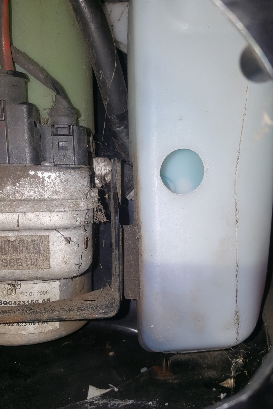

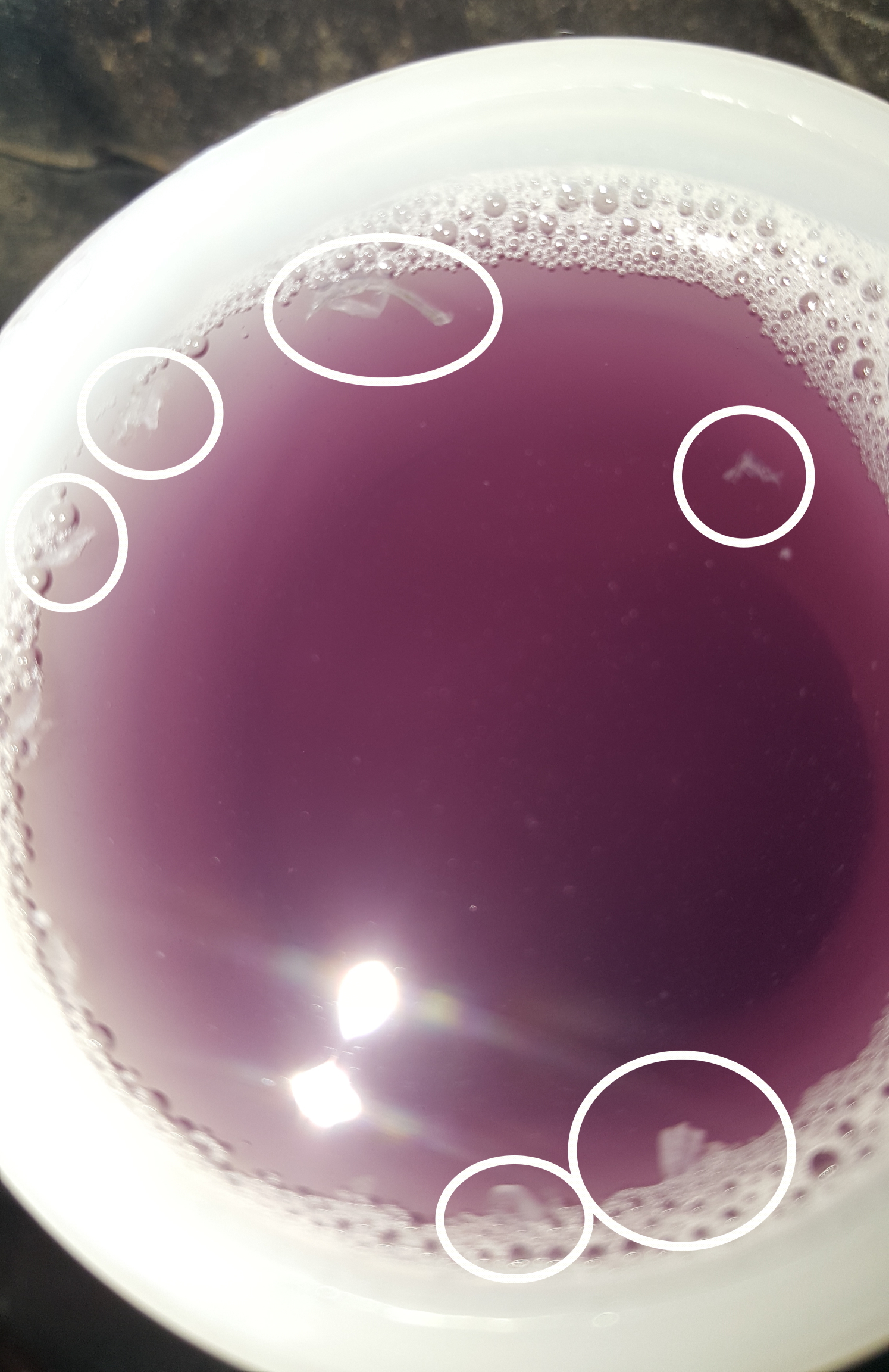

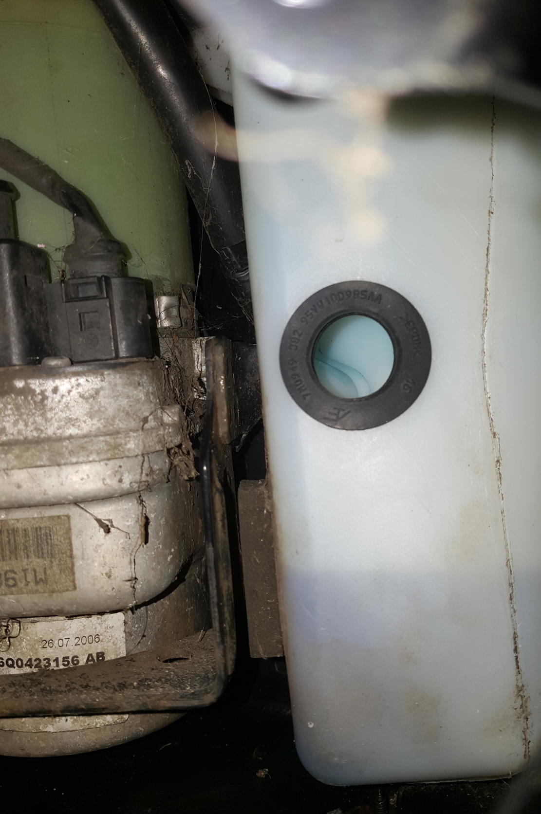

Then just carefully and slowly drill as straight as you can (photo 4). Don't worry about any plastic swarf debris from drilling entering the hole, even small pieces (see final step).
Once you have drilled your 25mm hole (photo 5), you can fish out larger plastic debris through the hole with your finger as it will be floating on the surface of the fluid (if you filled it 3-4 cm from the bottom of the hole as in step 1 but is not essential right now. Sand evenly around the hole to get the edge as smooth as possible so the rubber grommet gets a tight seal. The grommet fits into a 26mm hole so you can afford to sand a tiny bit away – use the guide imprinted on the bottle to keep to a good circle. Keep trying the grommet frequently between sanding until it just fits. Cut or sand any swarf attached to the hole edge inside the bottle (it can fall into the fluid -see final step). See photo 6.

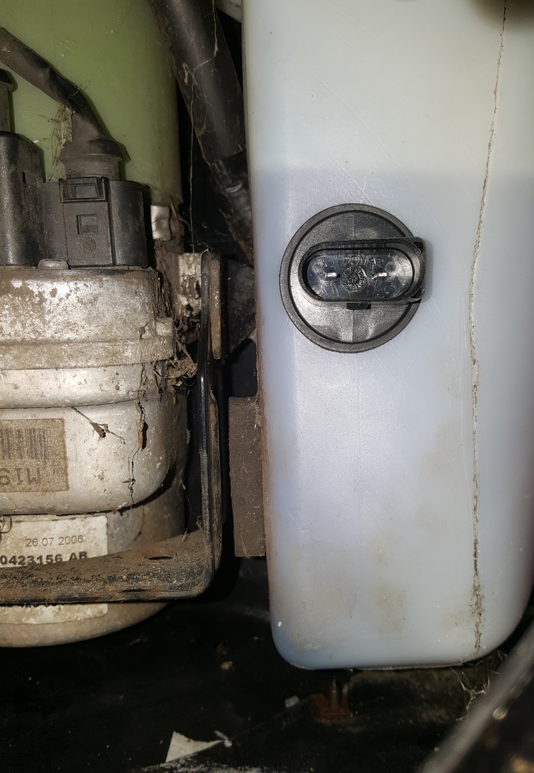

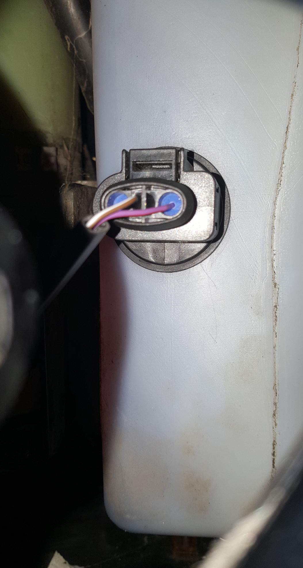

The sensor will (should) be a very tight fit inside the grommet (photos 7-8). Use a smear of dish washing liquid to help ease it in if needed. If it really won’t go, remove the grommet and sand a tiny bit more. Repeat until you get a very tight fit. You want to get the sensor rotated so that the pins lie in the horizontal plane (lower the car down flat first if you had it jacked up for drilling). Also consider whether you want the push clip on the VAG connector facing up or down, for easier future removal. I prefer to have it facing up, which means the curved side of D-connector needed to point left (towards the engine).

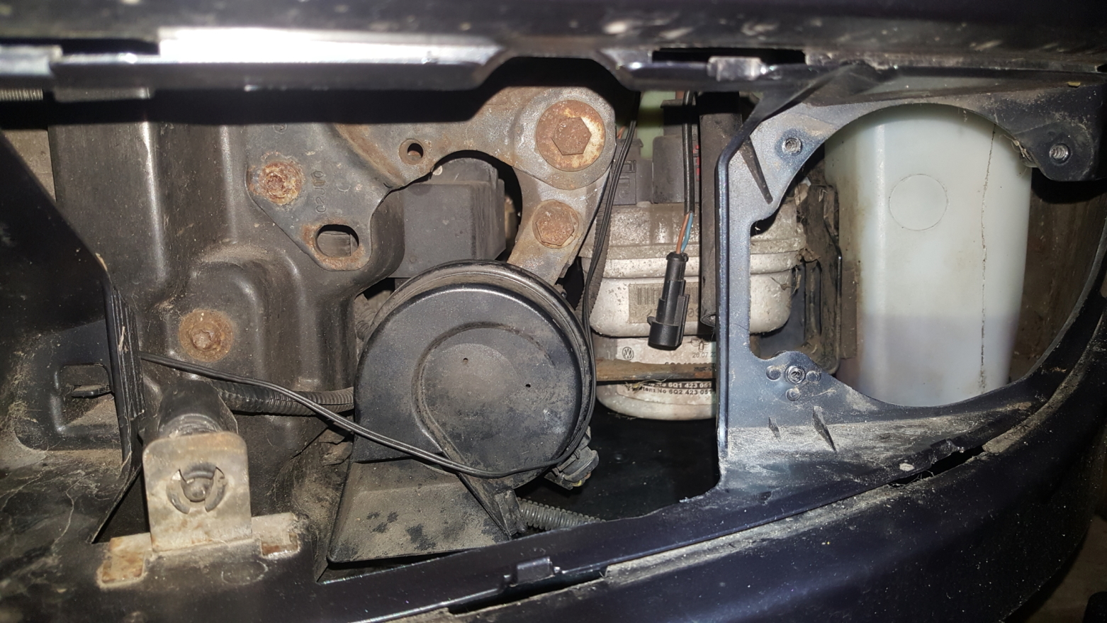

Push the wired plug onto the sensor until it clicks home (photo 9). Use cable ties to keep the hanging loop of sensor wiring clear from interfering with fog light wiring to prevent snagging when removing them. Make sure there’s enough free play to remove the sensor plug but not so much that the cable rests on the undertray where grime and water accumulate.

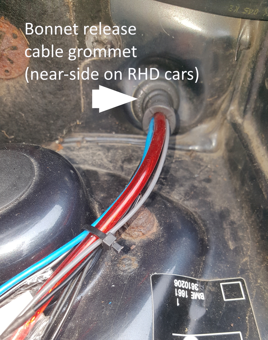

Push the wires from the sensor up through the space under the headlight and tie to existing harness or chassis. I then ran the wires up and inside the plastic harness protector which runs up parallel to the fluid bottle neck.

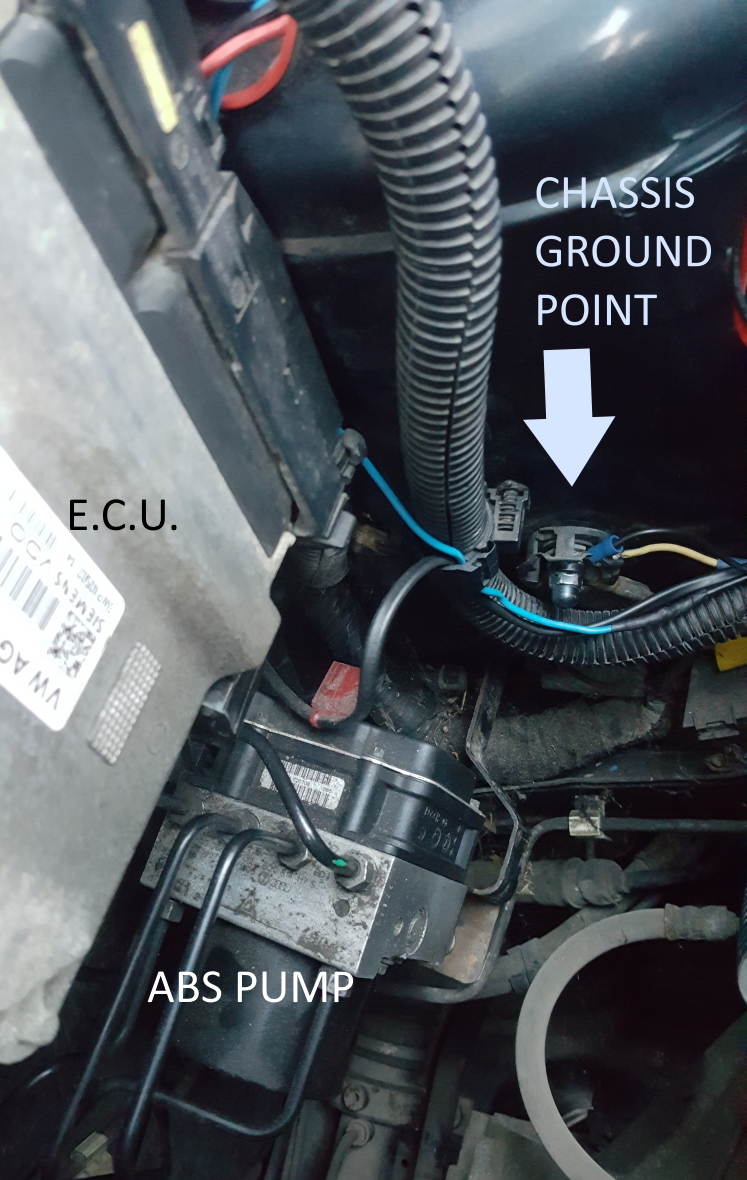

The ground wire from pin 1 of the sensor plug can be fixed to any chassis earthing point, it does not matter which one, just make sure the contact is a good one. (The OEM connection is via an earth connection #329 in the engine wiring harness). I used the one behind the battery on the nearside suspension tower not far from the ECU (Earth point #29 – see photo 10), simply because of its easy access and also I did not want to interfere with the very tight (and harder to access) bolts for some of the larger grounding cables used for critical engine and steering components nearer the washer bottle.
The wire from pin 2 of the sensor plug runs to the dash through the vacant bonnet release (photo 11). It’s easiest to remove this grommet, make a small hole in the tip and thread the grommet onto the wire. Now for the hardest part – wiring into the cabin. Remove the glovebox (search other guides online) and side panel facing the door, and open the passenger door fully. You are permitted (and encouraged) to swear and curse aloud during this process: Reach around the HVAC fan assembly and fumble around behind the sound insulation mat until you find the grommet used for the LHD bonnet release cable and pull it out. From the cabin side, push a straightened length of wire (eg coathanger) through the hole and then another 10cm or so. Go around to the front and from the space under the windscreen pull it through with pliers (you can pull up the plastic and rubber trim here for access), pulling the metal wire through the grommet hole. Securely tape the end of the sensor wire to the coathanger wire and carefully pull it into the cabin from inside the car. You can thread it through the grommet and reattach both grommets. Ensure you have the wiring routing sorted in the engine bay then you can take up the slack and route the sensor wire behind the dash through to the instrument cluster. I use the route along the existing harness below the passenger airbag, then behind the radio unit, then under the dash cluster - take care to route and cable tie away from the airbag, steering and adjustment lever.

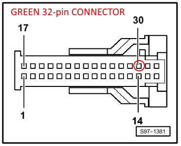

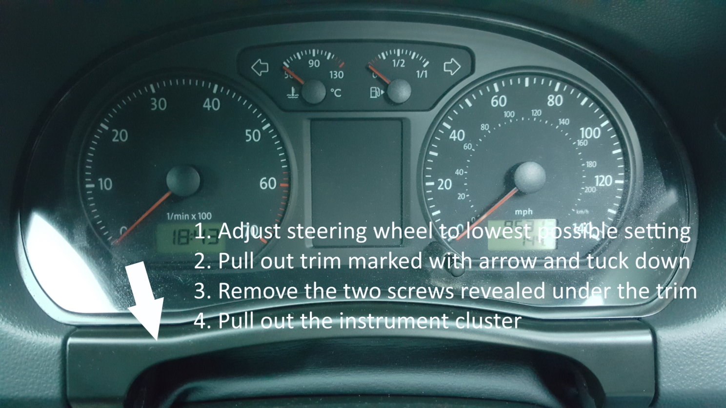

Pull out the dash instrument cluster (see photo 12). Behind it there are 2 connectors, an 8 pin and 32 pin. Release the locking clip of the green 32-pin connector and disconnect it. Remove the outer casing of the plug and slide away to reveal the terminals. You need to connect the sensor wire to pin 30 - tiny numbers are printed on the plug (photo 12b). The plug is easy enough to open up, but just be careful not to pull out any of the existing contact terminals. Several allocated pin slots won’t have wired contacts, so if pin 30 is vacant, obtain a suitable terminal and crimp or solder the sensor wire onto it. Despite not having the G33 sensor, my car already had a wire connected to pin 30 (it only went to the bulkhead coupling station), so I just lightly soldered my sensor wire to that, keeping the original wire in place.
Reassemble the plug, reattach to the rear of the instrument cluster, secure the locking clip, reinstall the dash cluster with the 2 screws, and replace the black trim piece.

This step cannot be done using an unregistered (shareware) version of VCDS or VCDS-lite. I am assuming you know the very basics of VCDS. Anyway, turn the ignition on without starting the engine. Navigate to gateway 17-Instruments, then click on Coding. Make a note of the code shown in case you balls it up. You need to change the first two digits of the code which corresponds to Equipment installed, adding the numbers shown in the ‘helper balloon’ (see photo 13). The first 2 digits in your code should tell you what you already have. So if you already have brake pad wear sensor (+01) and we want windshield wash level sensor (+04), then you just need to change the first 2 digits to 05, then click ‘Do it’. Close the controller and VCDS and turn off ignition.

Now, remove the filter cup from the top of the washer bottle, fill the washer bottle to the brim and you should be able to fish out any drilling debris and swarf with a spoon or tweezers (photo 14).

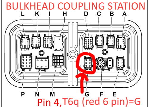

Final Note: If you decide you want to connect the sensor signal wire (from pin 2 of the sensor) via the bulkhead coupling station to replicate the OEM installation (photo 15), the 6-pin connector (code T6q) is red and you want pin 4 (pin 1 is front fog lights, 2 is for heated washer jets, 3 is the horn and 5 is brake pad wear sensor). But be warned – this can be tricky to access in the engine bay, and even trickier in the cabin as it is a dash out job if you don’t already have a wire installed to the dash cluster.
