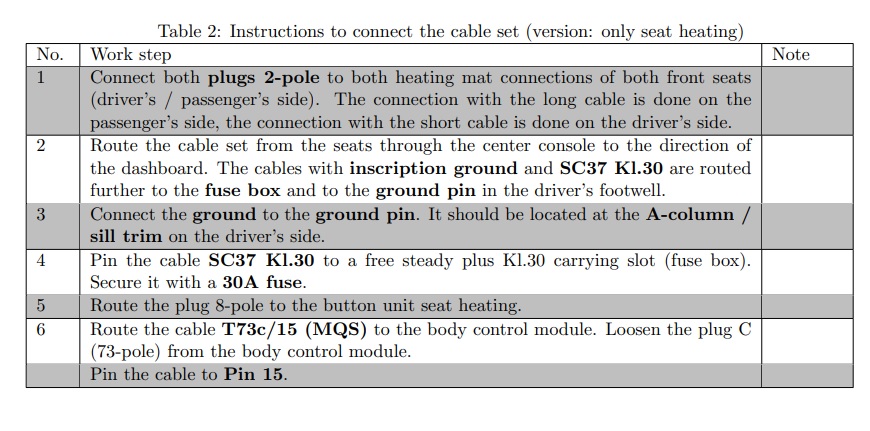

I retrofitted heated seats on AW1 Polo of a friend of mine using wiring loom from Kufatek.
Wiring is pretty simple:
And coding as weel:
Under adaptation in 09 change Sitzheitzung_CAN from not avalable to Seat heater on_LIN.
Despite that seats do not warm up. Cheking with a multimeter current does not arrive to heated elements connectors under seats.
My biggest concern about the wiring loom installation is the location of t73c/15. I connected it to BCM C connector (where pin 15 was empty) but according to elsawin there's no t73c/15 in heated seats wiring diagram but there's t73b/15 instead. Well I've asked Kufatek about and replied that t73c/15 correspond to t73b/15 which is located on C connector. This does not have much sense to me but I'm not familiar with AW1. On the other hand I expeced to find a cable already present on pin 15 of C connector but there was not. Can anyone help me to solve the mystery?
Re: Heated Seats Retrofit Issue
There are three connectors on the MQB BCM. T73a will be a black one, T46 will be brown and T73b will be black.
This is how elsawin will describe the connectors.
There are three connectors on the MQB BCM. The one closest to the driver door (LHD) is A, the center one will be B and the one closest to the centre console will be C.
So T73a is A
T46 is B
T73b is C
and to make it more complicated, T73b is sometimes indeed referred to as T73c, i.e. in Polo 6C. Polo 6C doesn't have the T73b.

According to this my wirings are correct.
Would you expect to already find a wire on pin 15 according to diagram above? Or I shouldn't care about.

Thank you Michael I'll check wiring diagrams once more. :wink
EDIT: Just checked wiring diagrams. You were right: this LIN is connected to anti theft sensor and rain/light sensor.
That explain why wire is missing.
