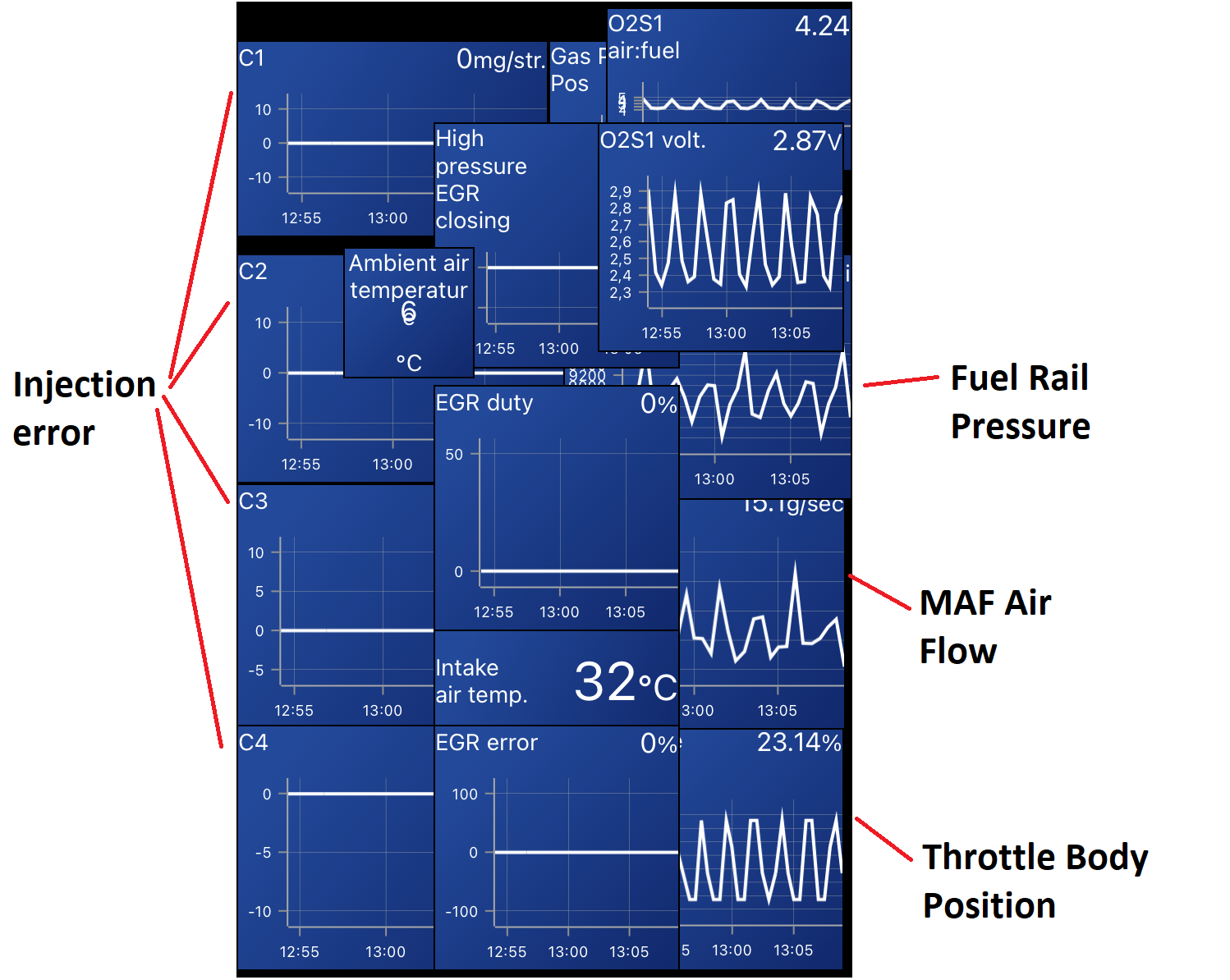

The bigger issue is during the regeneration. When in regen, when I give a constant throttle at stand still to keep the RPM between 1-2k, engine speed sweeps periodically by 200-300 rpm. Car is shaking while crusing in regen at engine RPM between 1-2k. Above 2k RPM, there is no problem, car is running smooth. It also stalled twice when I pushed clutch while crusing in regeneration. Engine shut off immediately when I pushed the clutch without any shaking.
Here is the video of the RPM sweep:

And here is the ECU data I recorded:
https://youtu.be/godL8XhzuEU
Some plots were overlapping because of the limited space. Below is the explanation of the plots in the video. When giving constant throttle, injection error is 0. EGR is closed and throttle body is around 20%. O2 sensor output, MAF flow and throttle body follows the RPM sweep.

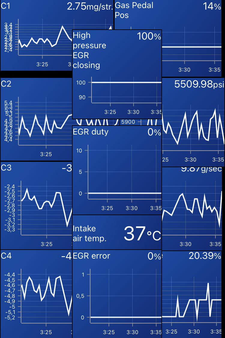

Here is the data for idle in regen. At idle, RPM is at 1k, no sweeping no shaking. EGR is closed and injection errors increase.

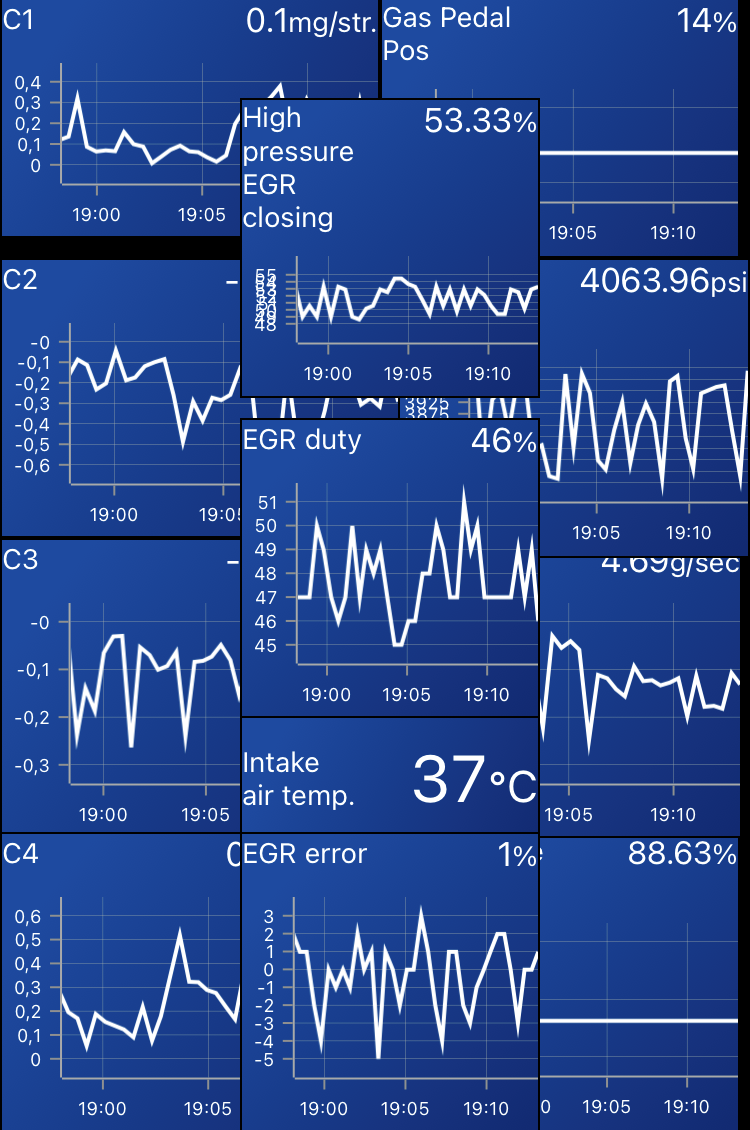

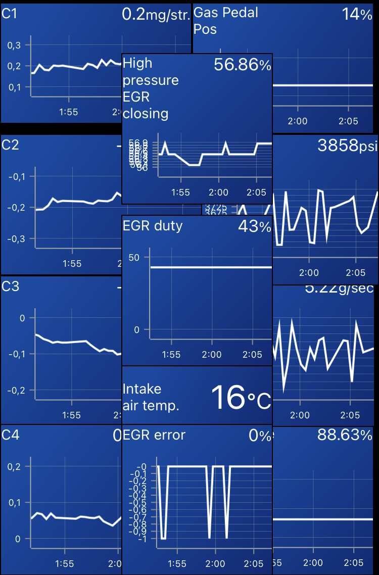

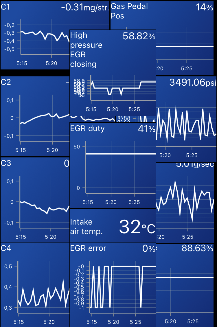

Here is the data for idle in normal operation as well. There is no shaking in this data. EGR is active. Throttle body goes back to normal opening. Injection error is very close to 0.

Bad injectors, look at the deviations in regen. 5 mg deviation is a lot.
Re: 2011 Polo 6R1 1.6 TDI Engine RPM Sweep in Regen and Rough Idle
True, injection deviation is a lot at idle during regen. But it is almost 0 when given some throttle in the regen and it is always close to 0 outside regen operation. Do you think it is stemming from the injectors? I couldn't explain why the deviation is high only at regeneration idling.

yes but idle compensation will only occur at idle. even if you feather the throttle, it will become zero. what are your values when you are at idle without regen?
I thought ECU was continuously monitoring the injection rate and adjusting accordingly. Reading with throttle is not valid in that case.
Injection error readings without regen are around 0.1-0.3mg/str. I attached 2 examples.

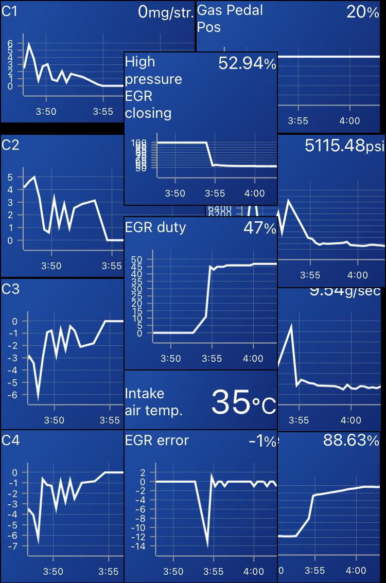

I also caught the moment when regen mode ended and car returned to normal. Here is the data of this moment:
