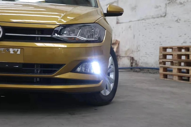

Sorry, no experience of removing the Polo’s front bumper or wiring. However, the front fog lamp units on the AW model Polo’s also house the LED DRL’s (illuminated in the picture below), and the fog lamp also doubles up as a static cornering light. So may be the ‘spare’ wire is for the DRL or the cornering light function.
