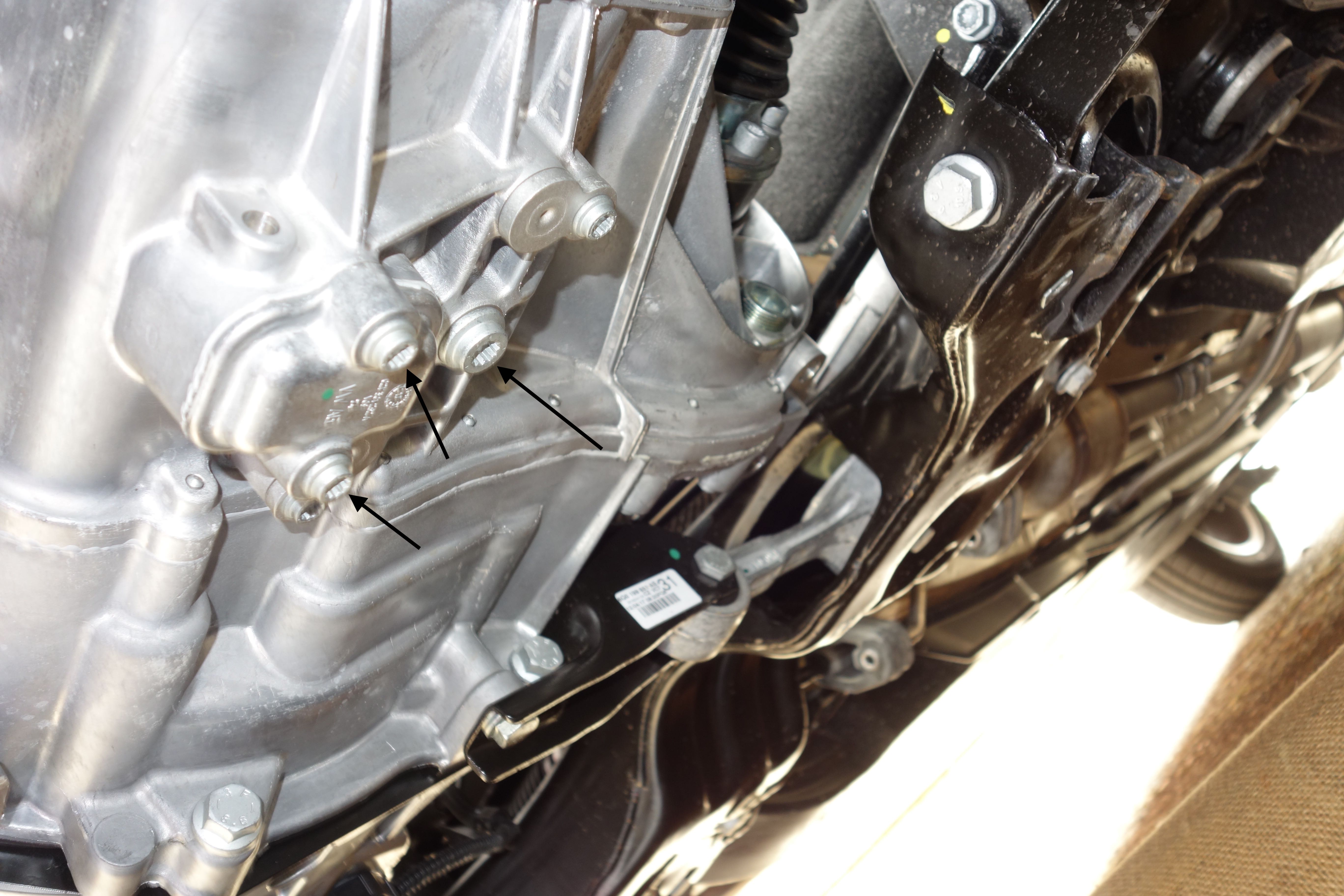

"To remove the maximum quantity, it's possible to unscrew one of the three screw at the bottom to creat a open and drain the rest of the oil".
Just out of interest, to which three screws are you referring? (Can you show a picture of them?).

The big screw behind the little cover with two screws side to side

Thanks. Here's my gearbox, viewed from a different angle (from my nearside, bearing in mind that mine's a righthand-drive vehicle), and I've annotated with arrows what I now presume to be the three screws, having viewed your pic and read your comment. Have I understood correctly?
When doing the full drain, did you have to just loosen all three of those screws, or did you have to completely remove the screws? Indeed, did you have to take that small rectangular cover off?
I'm asking about this because, on my vehicle, for a long time I've been trying to track down an annoying oil leak that has been manifesting itself vaguely in that area of the gearbox casing. At one point I contemplated undoing these screws (bolts) and slightly repositioning the rectangular cover. I didn't go ahead because (a) the screws each had what looked like hardened sealant underneath their heads, and (b) I suspected gearoil might pour out. I thought I might then also have some trouble re-sealing the screws.

veteran wrote: Thu Dec 22, 2022 11:12 am Thanks. Here's my gearbox, viewed from a different angle (from my nearside, bearing in mind that mine's a righthand-drive vehicle), and I've annotated with arrows what I now presume to be the three screws, having viewed your pic and read your comment. Have I understood correctly?
You are right on your picture.
I tried to remove the little cap on the first oil servicing but with no luck.
By removing the screw just behind, I catch a little quantity of oil, but I was after the main draining. So I can't confirm.
I you have torque wrench, check is they are well torqued.
I have a small leak, but it's barely noticable on the drain plug.

It was about 4 - 5 years ago when I was doing that. I remember that I checked with my torque wrench and the appropriate bit that none of the bolts/screws in that concentrated area were loose. I couldn't check, however, for a specific torque setting because I couldn't find any of them quoted for these particular bolts in my otherwise very comprehensive VW workshop manual, most likely because VW never expects anyone other than themselves or an approved VW gearbox specialist to ever meddle with the gearbox. But from what I could see anyway, these bolts were 'locked' in place by some sort of hardened sealant, presumably added when the gearbox was assembled in the factory (in my case, in Spain). The same hardened sealant had also been used on the rim of the rectangular cover. Clearly, right there you need a very good and virtually permanent seal, as otherwise you could continually lose oil out of the gearbox. This explains why neither you nor I were able to remove the cover. I'm glad I didn't, anyway, because had I done so I'd have had an almost impossible job then of adequately resealing it.
The designed-in drainplug, further up the casing and which is just visible in my pic, has a tapered thread and should, in theory, not allow any gearoil to leak from that orifice - at least, if the plug's thread and the mating thread in the casing were properly formed at manufacture and the plug was originally torqued to the correct value. But it might be that, in my case, there was something wrong with one or other of the threads. At the time, I did remove the drainplug several times to check that there was no cross-threading taking place, for example, and there didn't appear to be. I torqued it to the recommended value, plus a tad more but left it at that because I didn't want to risk cracking the casing. Surprisingly, most of the drainplug's threads still show on the outside, so the drainplug doesn't screw in very far at all, at least it doesn't on mine. Like on yours, I do get some seepage from that drainplug, despite all my efforts to prevent it. However, the amount of oil that annually ends up dripping on to my Polo's plastic undercover suggests that maybe the leaked oil is coming from somewhere different. The trouble is that if it is coming from that drainplug, or indeed anywhere else further up the gearbox casing, it no matter what eventually ends up as collective drips on the very bottom edges of the gearbox casing, ie, right by that rectangular cover. So, you can never really tell where it's coming from.
