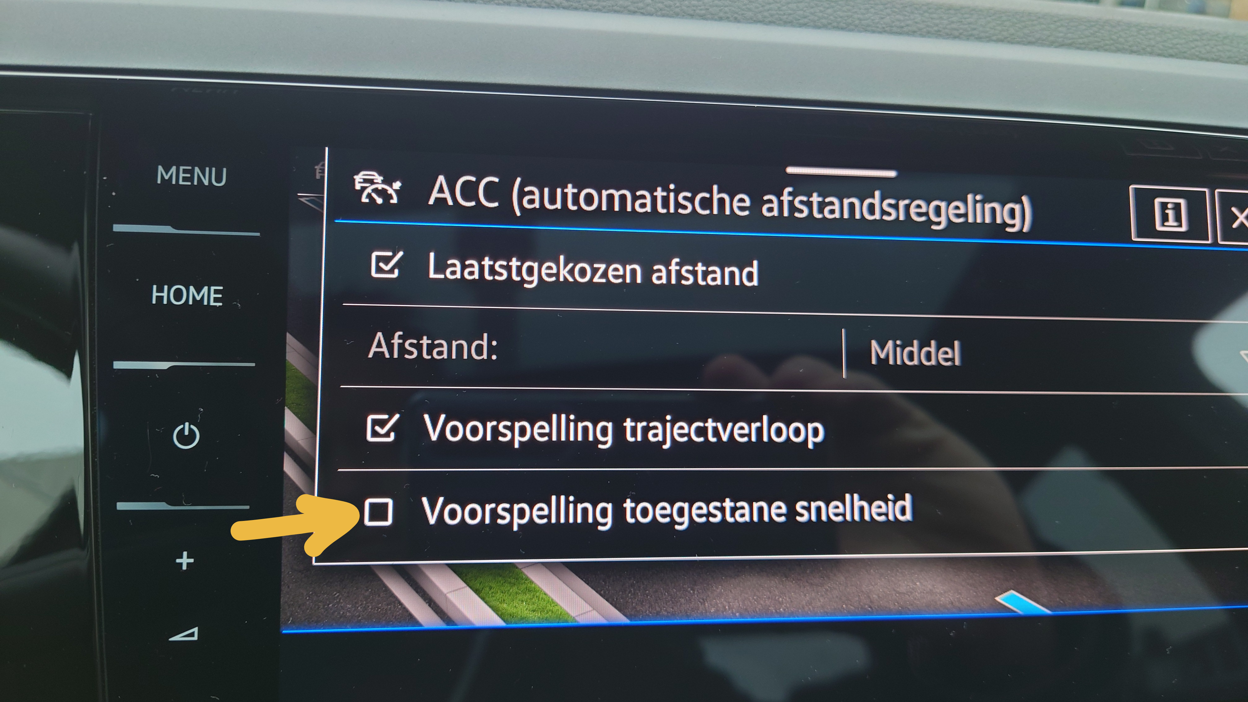

Maarten wrote: Wed Dec 28, 2022 8:21 am In the MIB menu, click on IQ drive, then the roadsign.
De-select the predict option.
Correction,
In MIB menu-> IQ Drive-> click on the car in front of your own (ACC)-> de-select predicted allowed speed
