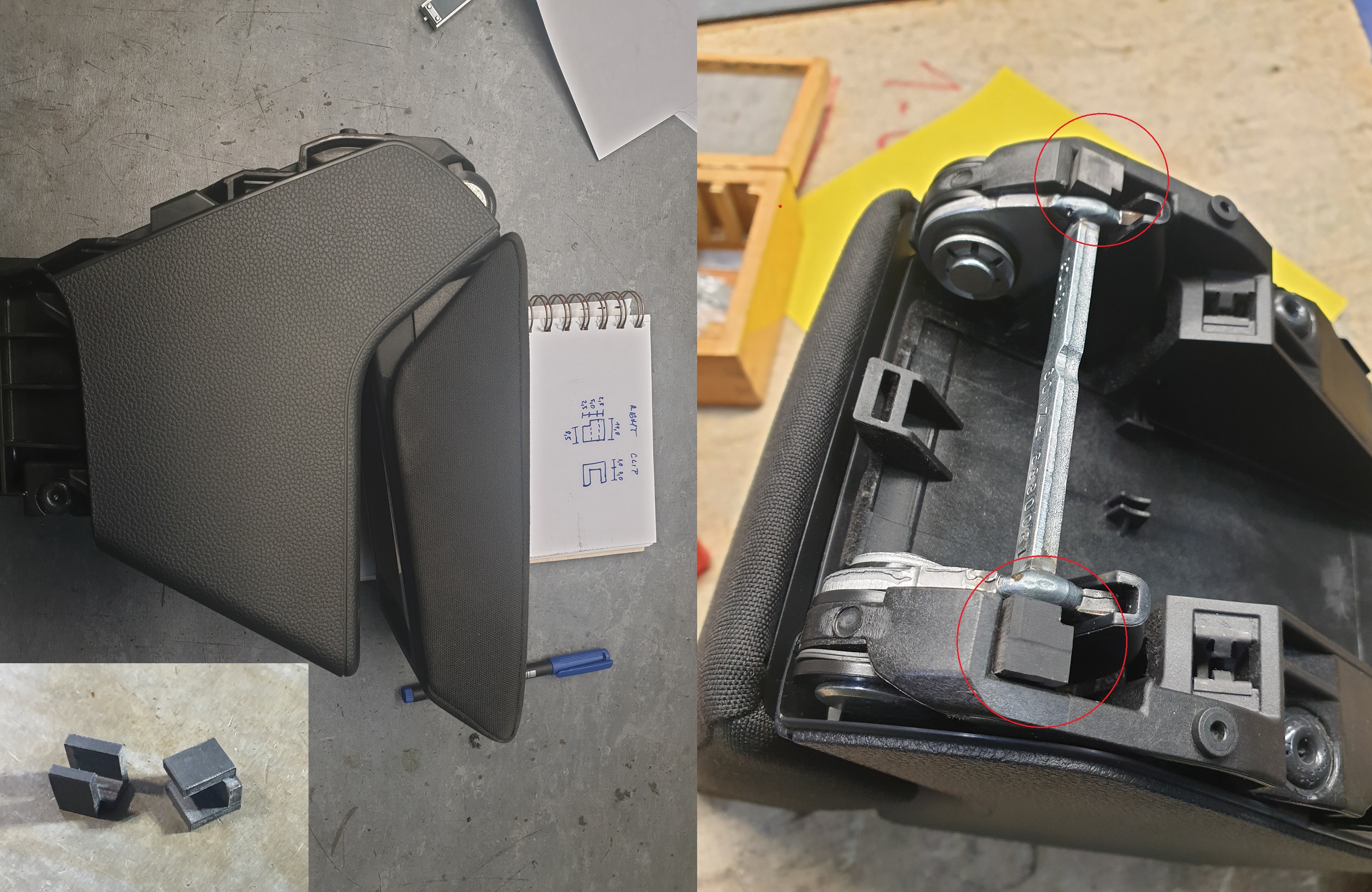

BTW there is also invisible solution. I don't think anyone else make those so you would need to make them on your own (3d printed should work too). There is no need to take arm rest from vehicle but the back panel have to go out to glue clips onto the metal bar.
