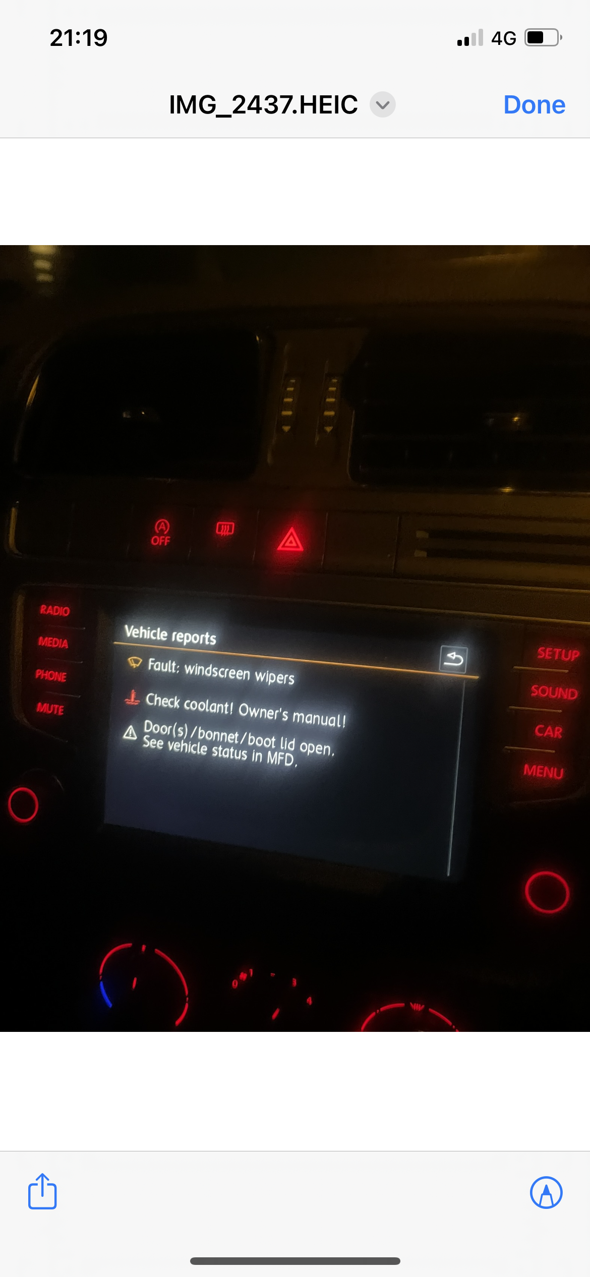

Hiya! I’m in desperate need of some advice.
So I have a 2015, polo 1.2L.
Basically, when I turn the vehicle on it works fine, but when I turn my lights on, it comes up with a cluster of faults like bonnet, open window, wiper fault, check coolant, and stop start not working. The lights cut out for a few seconds the indicators stopped working, The horn and emergency lights nd Bluetooth turns off.
Went to the mechanics they plugged it into the machine. Came up with every problem. They then referred me to electrical Mechanic, He said he doesn’t understand and that it could be water damage but i don’t understand how it “be water damage “ They change the battery and body module still not working. The car runs completely fine even with these problems coming on. it just seems to happen when I turn the lights on.

I don’t know much the light have to do with it, my guess. But iv just noticed that when I’m driving to work in the dark they will turn off for a second. Come back on and then the cluster of warnings start. But when am driving home from work and I turn the lights off nothing happens and the drive drives fine. So that’s what makes me believe it’s the lights starting this problem. I have got videos but I don’t know how to post it on here . Thanks for getting back to me

CharlieRR wrote: Fri Dec 30, 2022 8:43 am https://youtube.com/shorts/-kjVaeNBuko?feature=share [youtube] here is a video to show you what’s happening
Exactly as video shows I have same problem.
Turn on light with engine running / stationary or driving
Faults start with warnings in this order:
Rev counter flicks
VW logo appears as it does when ignition is switch on initially (This can happen a few times withing few seconds) then comes:
Wiper Fault
Engine bonnet open
Engine over heating
If whilst I have lights on and go over a ramp on road or bumpy road then the central locking on hatch back clicks open / closed
Garage had it for a week, initially I found similar case on internet, only happening with 2014 / 2015 Polos - This was said to be bad earth on left rear lamp cluster plug/socket
That has been checked, on both rear light clusters with no fault found, they sent me pics of both clusters and totally clean, now sign of corrosion.
They also checked and cleaned (using their words) earth wires on rear chassis. They thought it was solved.
When fault occurs it knocks out turn/indicators lights, stop/start function, wipers will only work whilst I hold down stalk otherwise they stop when I release stalks
Other things that don't work is main beam light don't come on even though blue bulb on dash shows on when I flash. Only dip beam is on.
Garage says that car is in 'limp mode' and requires a software update
Only other things to add is I replaced battery when issue started with a Bosch AGM battery
Can run all day without any faults / problems if lights, either side or dip are not activated
Today I need the car until Sunday, so returning it next week on Monday to garage
Thanks in advance for anyone who might have suggestions I can submit to garage.
Kev

Problem solved was the earth prong on rear lamp holder that had collapsed/crushed and was not making a full connection to the associated plug
Garage, fitted a wire directly to the lamp holder earth rail, then connected other end of wire to wire harness. :D
