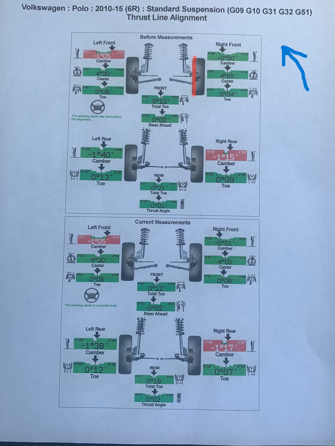

do you have a report for the alignment?
Re: polo 6r goes left
yes, i have the second one, copy below, where he said it was in spec. after this, a few months ago i gave the right wheel half a turn.toe out.
- tracking kwik fit may 2022.jpg (1.03 MiB) Viewed 2025 times
- Posts: 6695
All I can see is you have about half a degree too much camber, that might cause such issues but half a degree is not much. Hard to say.
appreciate your response iichel, the drivers inside tyre wear might point to something being off, when the slight excess camber you mention is on the other sides tyre (passenger), i think i might try swapping over the wheels, see what that does
