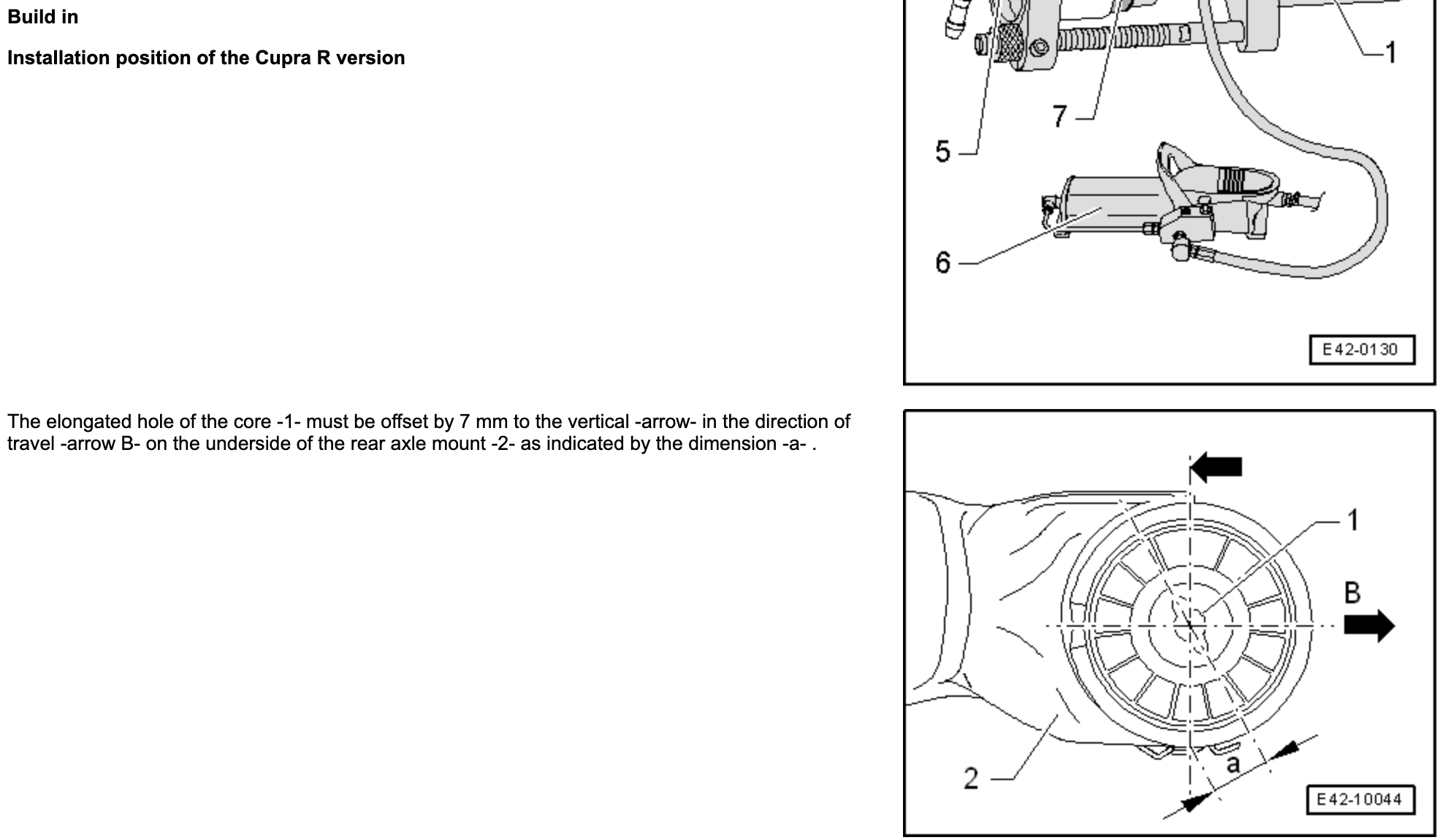

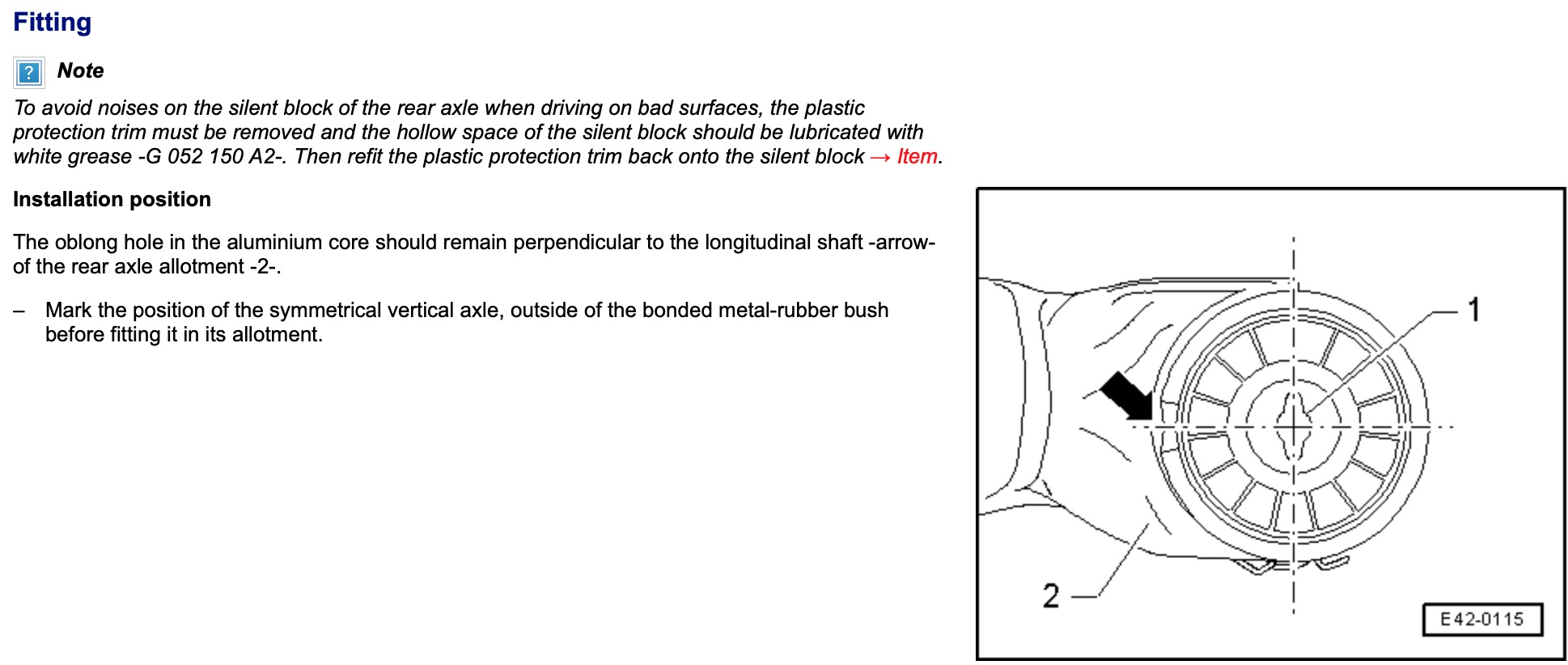

As for fitting, there are 2 somewhat agreed orientations of fitting that I could find. These bushes are NOT solid rubber but rather the voids are smaller and or the rubber itself is stiffer. With the added benefit of the end caps helping prevent the ingress of dirt and salt.
I went for the orientation shown in the first image and haven't had any untoward noises but time will tell.
