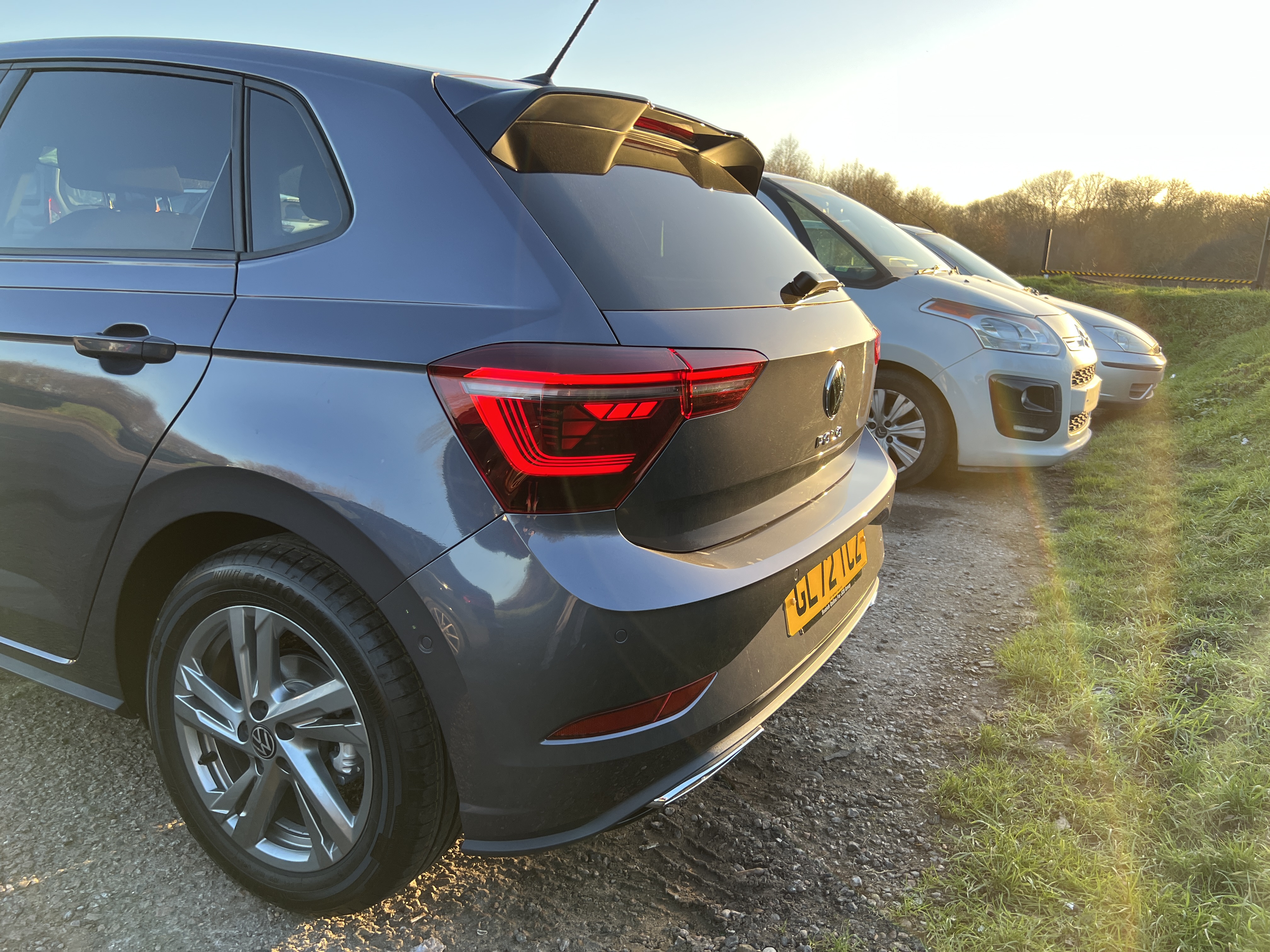

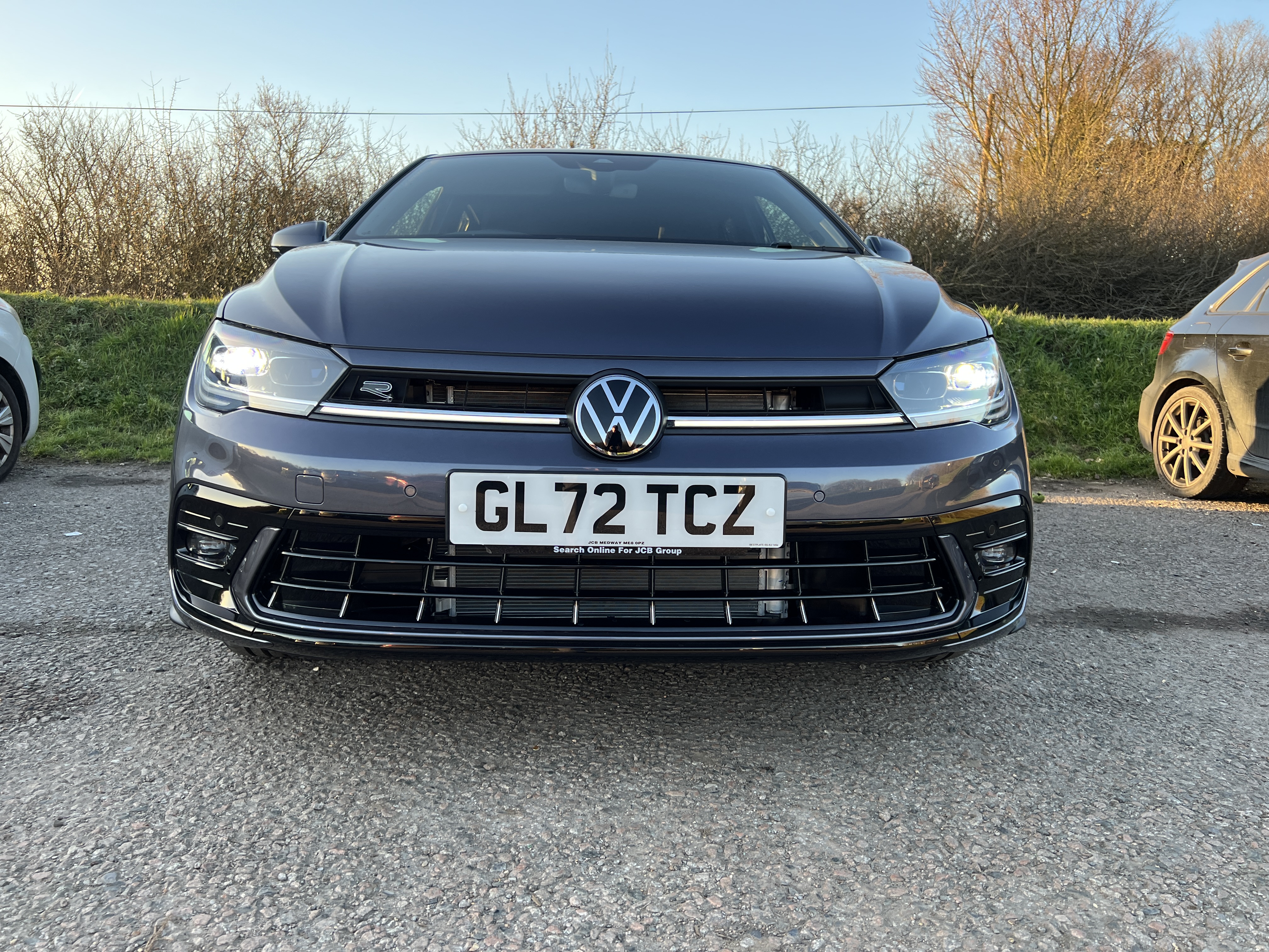

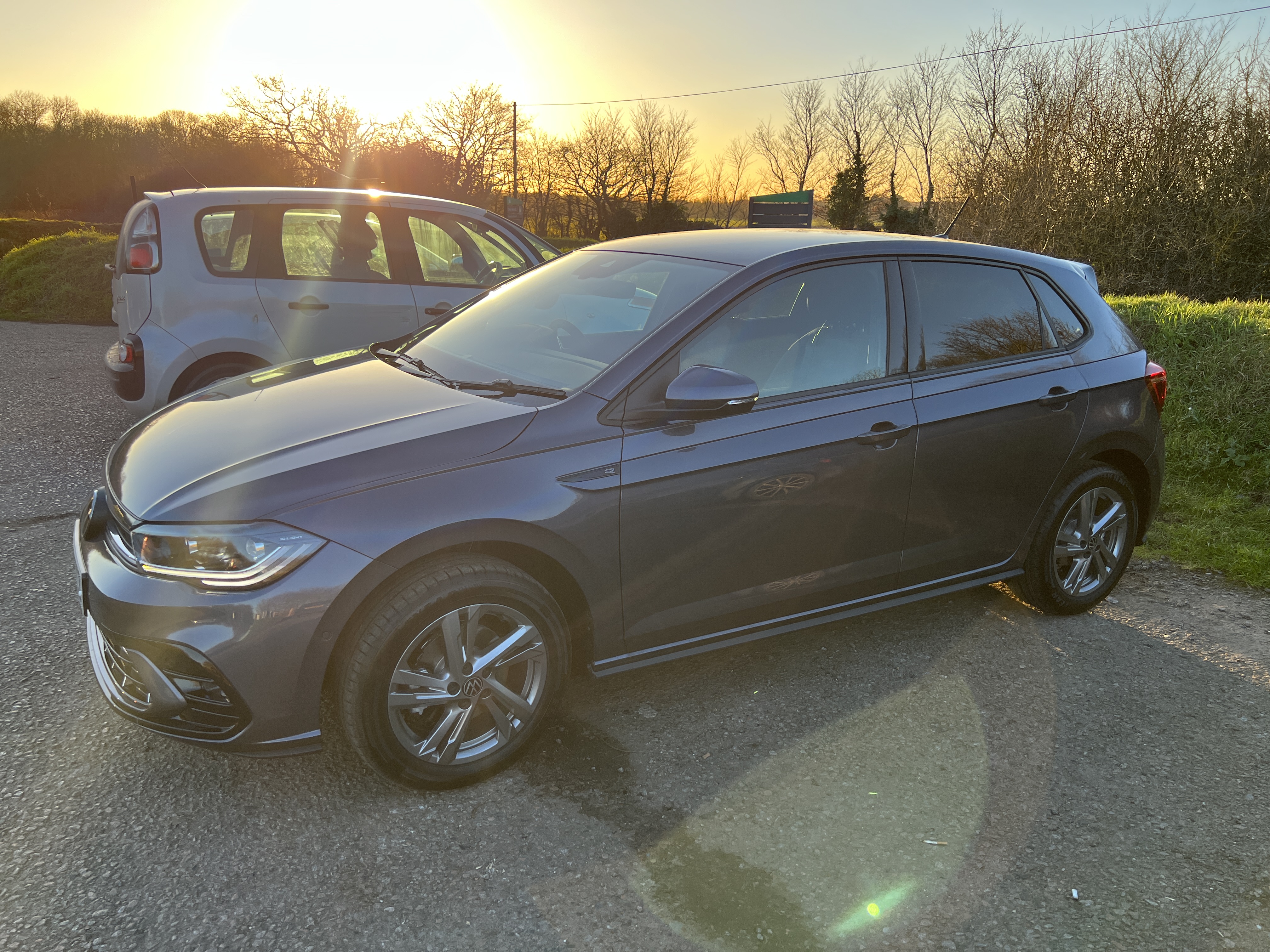

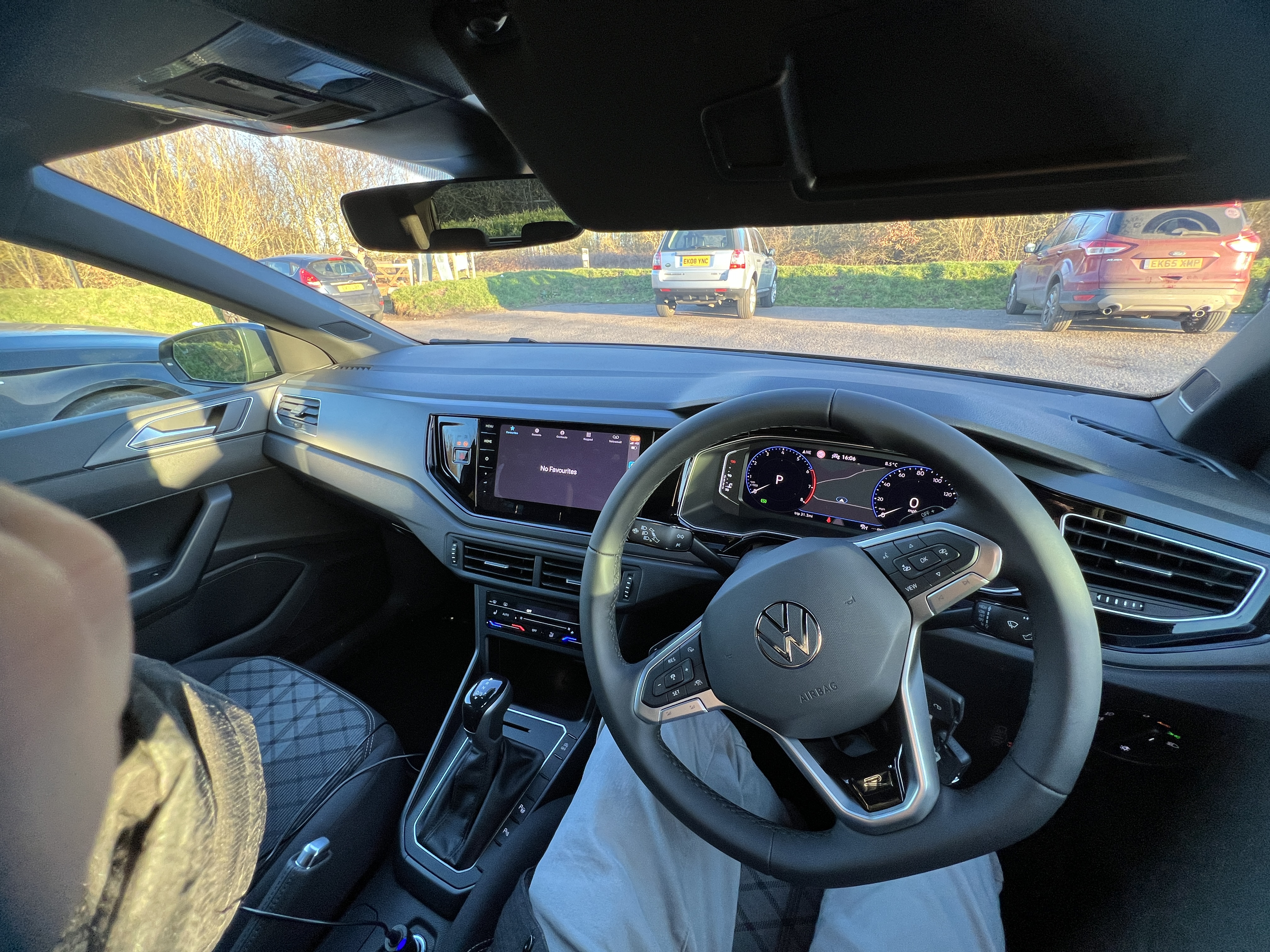

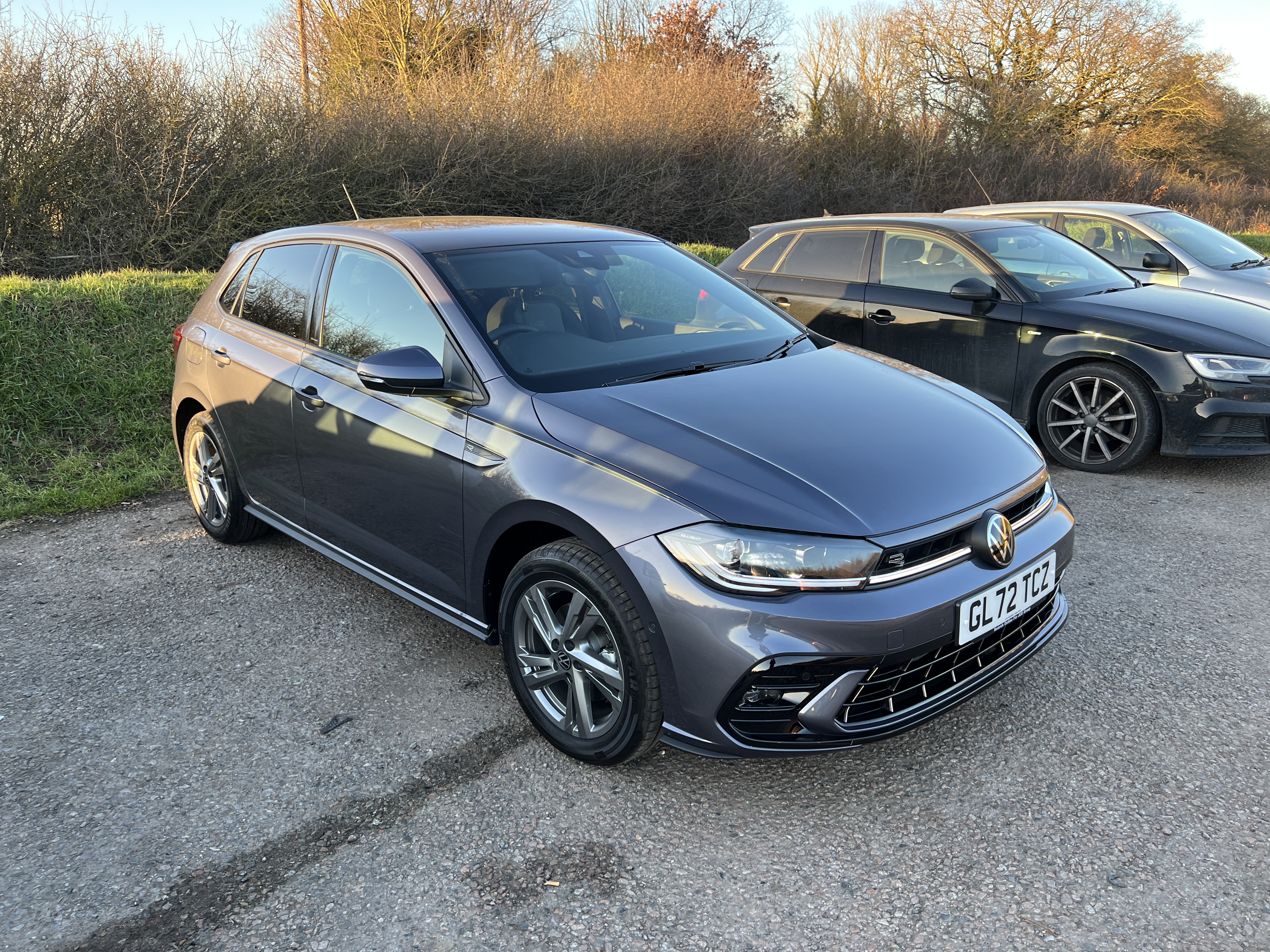

Here are the photos! Going to have lots of happy miles with this new one 😀

Harrihealey02 wrote: Mon Feb 06, 2023 4:33 pm Here are the photos! Going to have lots of happy miles with this new one 😀
Looks great! 😎 Nice colour, and I really like the wheels, especially as they’re not diamond cut!

The colour suits the car :)
Agree with SRGTD's comment about the wheels. I wish that manufacturers would get over their diamond cut fetish.

To be fair the diamond cut alloy wheels is an added cost which isn’t standard so for standard equipment it is a good choice. I prefer the look of these non diamond ones and the tires are thicker so it’s more comfortable driving 😀

Congrats, looks great! The color and the wheels do go perfect together!
Question though, it appears your key is hanging from the side of the steering column and I see no 'start engine' button. Does your polo not have push to start?

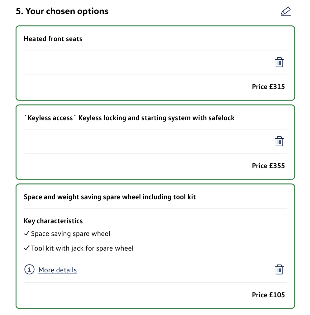

VWPolo1_0 wrote: Thu Feb 09, 2023 1:27 pm Congrats, looks great! The color and the wheels do go perfect together!
Real paint and keyless are extras.
