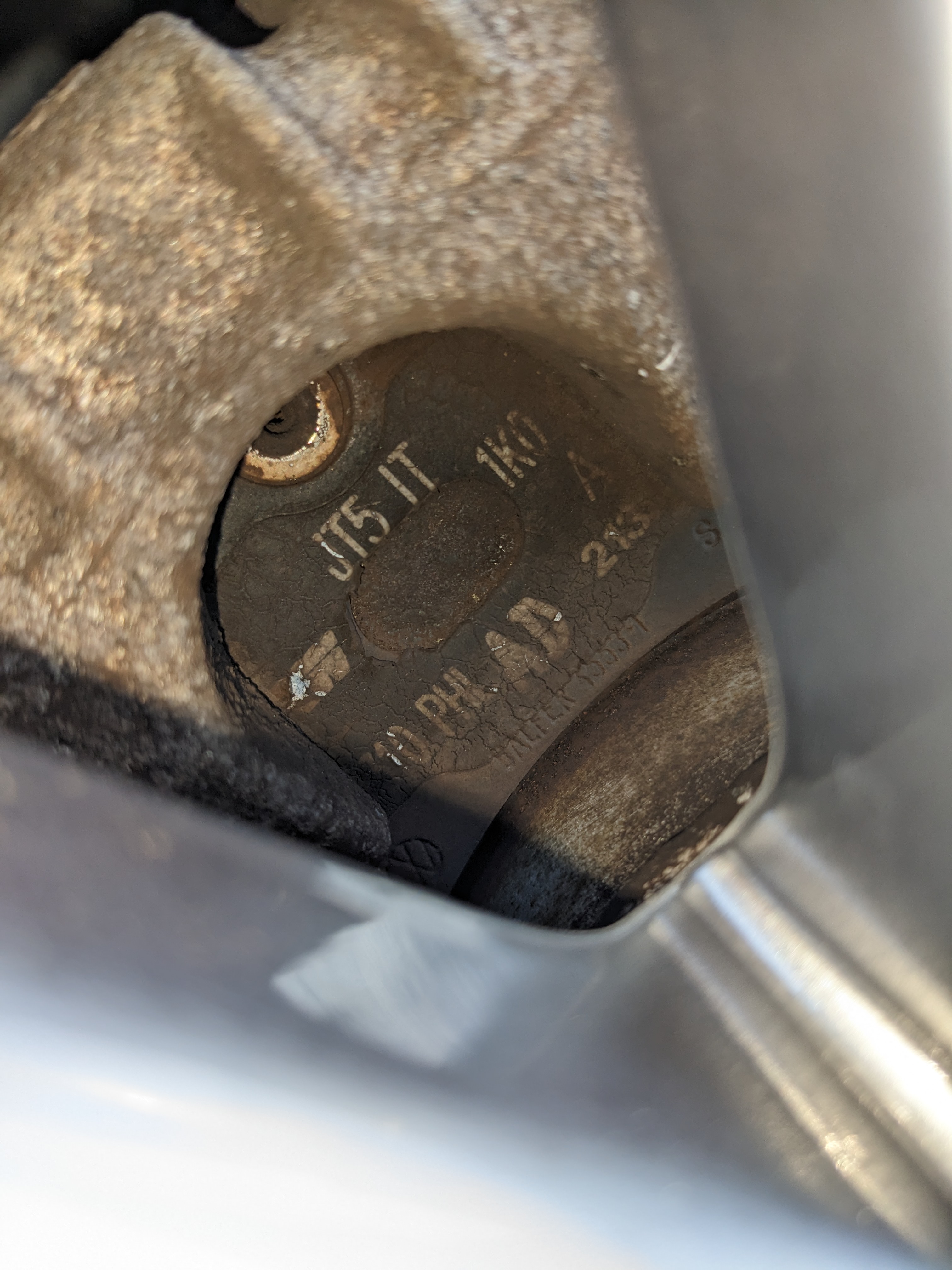

I hhave pictures for the rear brake pads, and yes, they are original ones :roll:
What is the purpose of the metal shims ?
Less friction between the pads and brake caliper ?
Mine doesn't have, but I don't know if it's possible to fit this system on mine.
