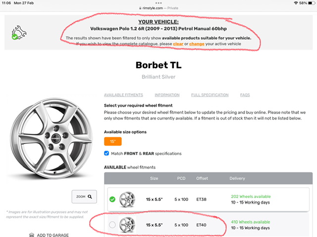

I’ve checked on one of the alloy wheel retailer websites (Rimstyle.com) to see if they confirm 5.5J x15 ET40 alloys are an appropriate size for your car and they do confirm they’ll fit - see screenshot below. However, the design of some alloy wheel’s spokes may mean that not all 5.5J x15” ET40 alloys will fit your car and could give brake callipers clearance issues.
You could fit spacers and longer bolts; if you do this, make certain any replacement bolts are of the correct thread and that they have a radius / ball head so the bolt head profile matches the profile of the bolt hole in the wheels. Also, fitting different sized / spec alloys and / or wheel spacers is a modification for insurance purposes, so you’d need to inform your insurance company and they may increase your premium (some insurance companies are more mod-friendly than others).

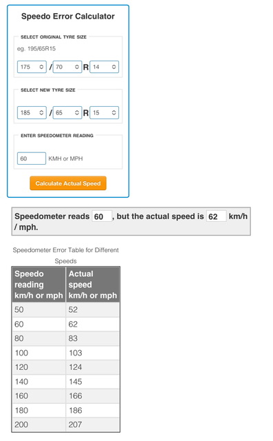

@parkie23; the overall rolling radius of the wheels / tyres you’re planning on fitting to your car should be the same as the rolling radius of your existing wheel / tyre set up, otherwise your speedo reading will be incorrect. I’m assuming that on your 14 steel wheels your tyres are 175/70 R14; if so, then to maintain the same overall rolling radius with 15” alloys, you’ll need 185/60 R15 tyres, which is what VW fitted to the to 15” alloys on the 6R / 6C Polo.
VW fitted 185/65 R15 tyres to the Sassari alloys on the AW model Polo SE. These have a larger rolling radius than your existing wheel / tyre set up so will result in your speedo understating the true speed of your car (see below), which is illegal in the UK. Therefore, you will need to budget for a new set of 185/60 R15 tyres - that’s assuming the Sassari alloys you’re planning on fitting have 185/65 R15 tyres fitted on them (as per factory spec for the AW model Polo SE).
https://www.tyresizecalculator.com/tyre ... calculator
