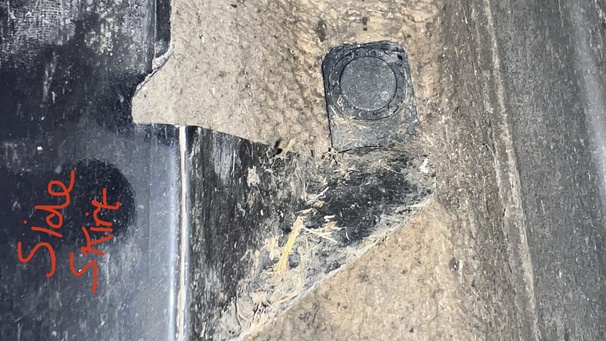

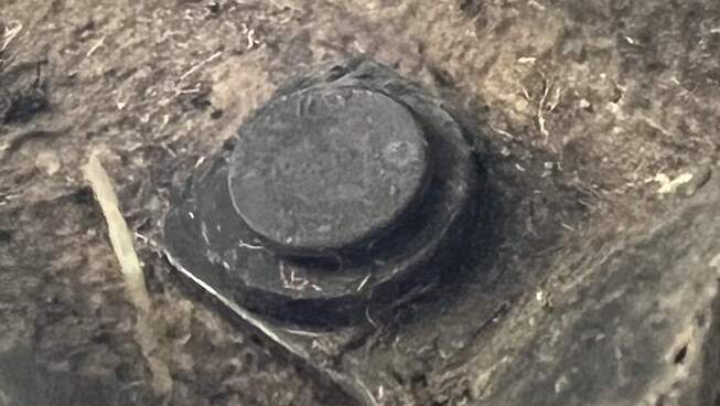

Hi all, I've just got this BlueGT and don't love the extended side skirts that this model has. I'm trying to remove them but am having some problems with the fixings holding the skirts on underneath. I have taken out the three torx screws which has loosened the skirt somewhat although there are still two or three of these other type of fixing that look like pins of some sort (see pics attached). I've tried prying them out with a knife but have had no luck and would appreciate any tips for getting them out. Thanks in advance!

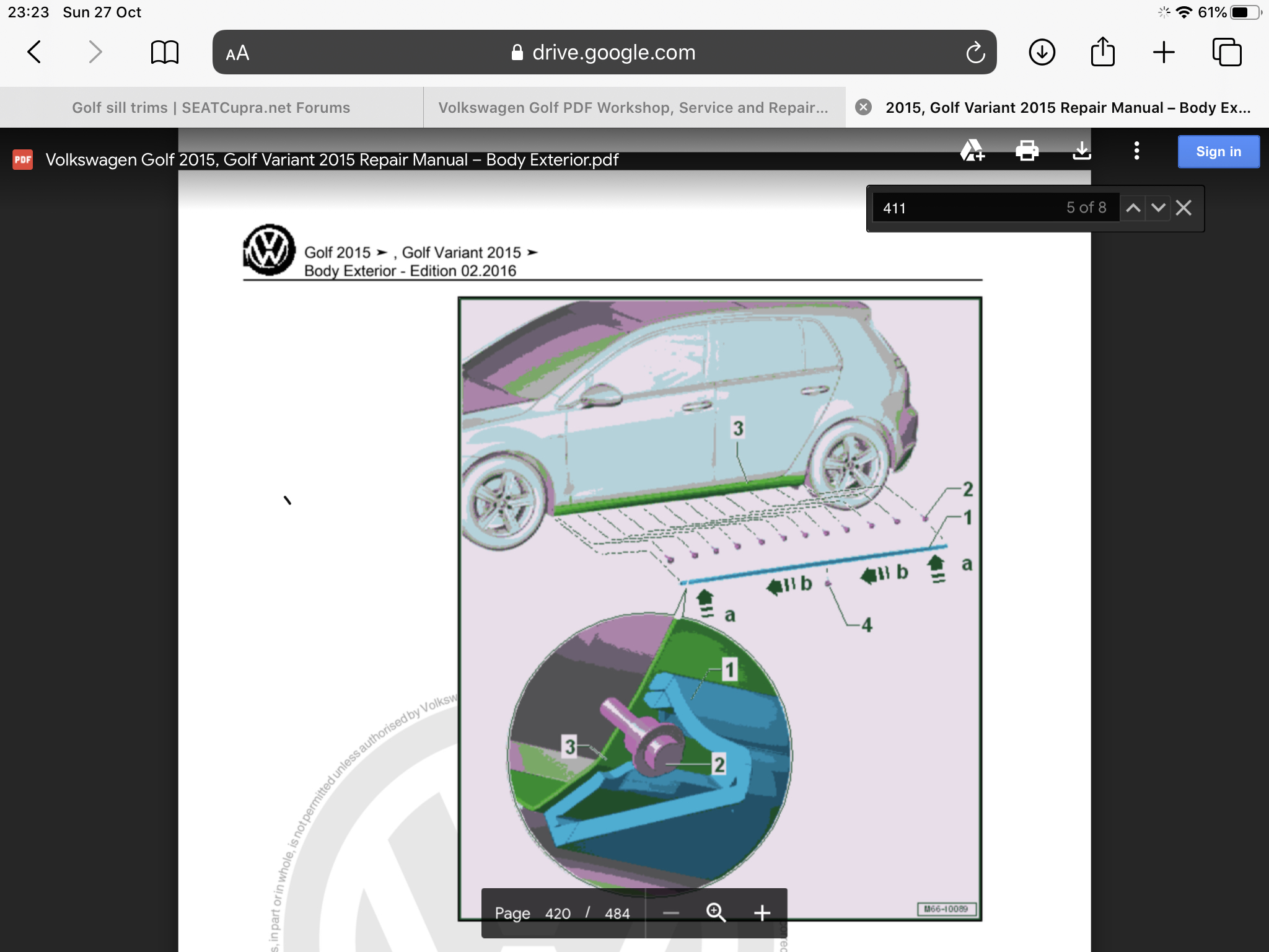

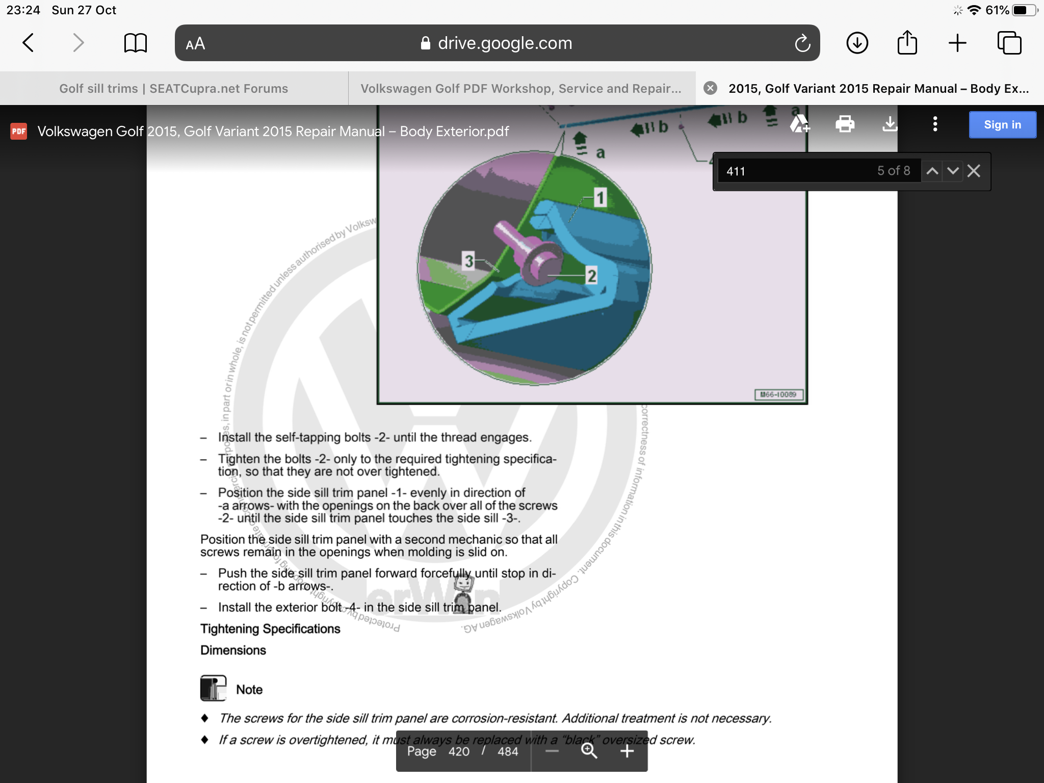

Before you remove the side skirts, it would be worth doing some research to find out precisely how the skirts are attached along the length of the sills as there are likely to be some hidden fixings on the reverse of the side skirts.
Many VW sill side skirts have a number of self tapping bolts screwed directly into the metal sills along it’s entire length and the side skirts slot onto these bolts (the 6c Polo GTI side skirts are attached that way). You can see the method of attaching the side skirts on a mk7 Golf GTI in the pictures below - the 6c Polo GTI side skirts are attached in the same way. If this is the method of attaching the BlueGT side skirts, then removing them and the hidden fixing bolts will leave many exposed screw holes in the sills. IMHO that wouldn’t be a good look, the exposed screw holes in the sills will be susceptible to corrosion, and you may be invalidating your car’s anti corrosion warranty.
