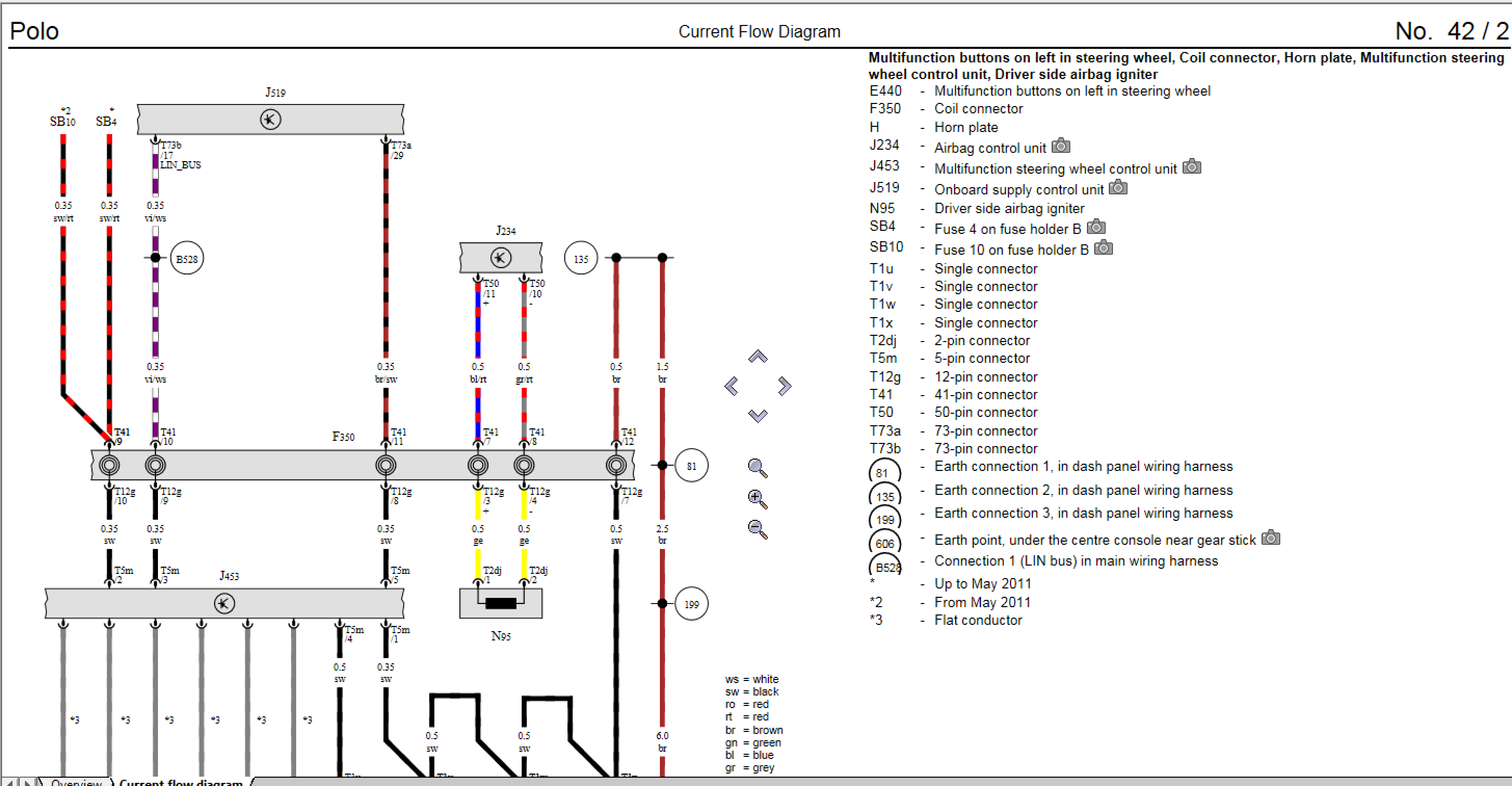

here is the wiring. for the bcm you might need to do a bcm max conversion.

Try to connect it to the bcm 87D first, right?
Re: Polo 6r 2010 Building a small rocket.
yes that's what i would do. 7e0 bcm is no guarantee it will work

ok, i'll try it, i'll get back to you when i'm done. One more question I have, the diagram you sent me supports the entire steering wheel because at the top it says only the left side.
doesn't matter, it's the same for left or left+right

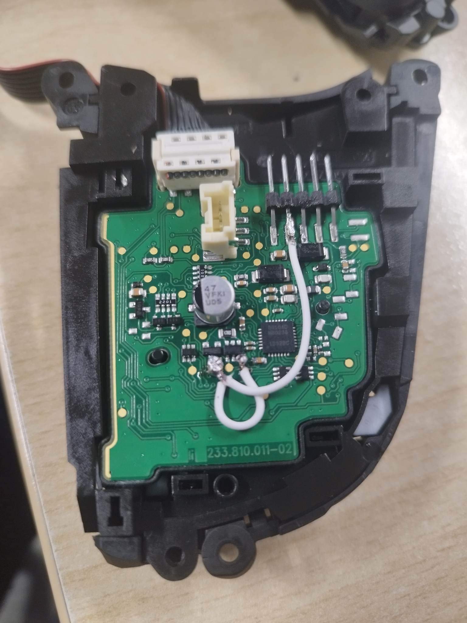

Hi iichel , i connected the steering wheels as you sent me the diagram. Only three Ok buttons work which mutes the radio and buttons from switching screens on the on-board computer that change stations on the radio. Do you have any solution for that?
You probably have an incompatible MFSW, I'd suggest to find another one that is compatible. Like 2H0, 7E0, 1K8 series buttons.

So now it's best to change the buttons yes? I did one more trick with soldering the cables on the board and after the test the backlight worked.

in this way

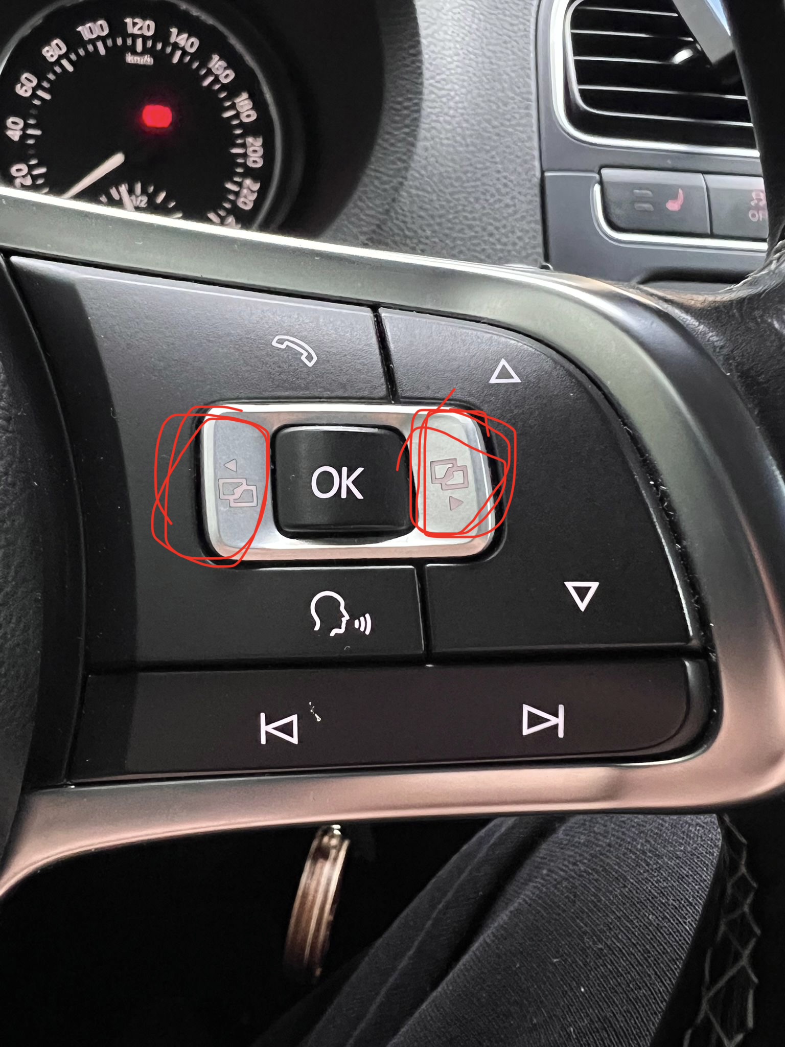

Hi, it's been a while. I bought and installed the Madwarlock emulator, and after a year, I realized that two of the buttons for switching between MFA windows (marked in red) weren't working. Has anyone else experienced a similar issue? You can navigate the menu using the up and down arrow keys, and it works similarly to the Trip lever. Regards
