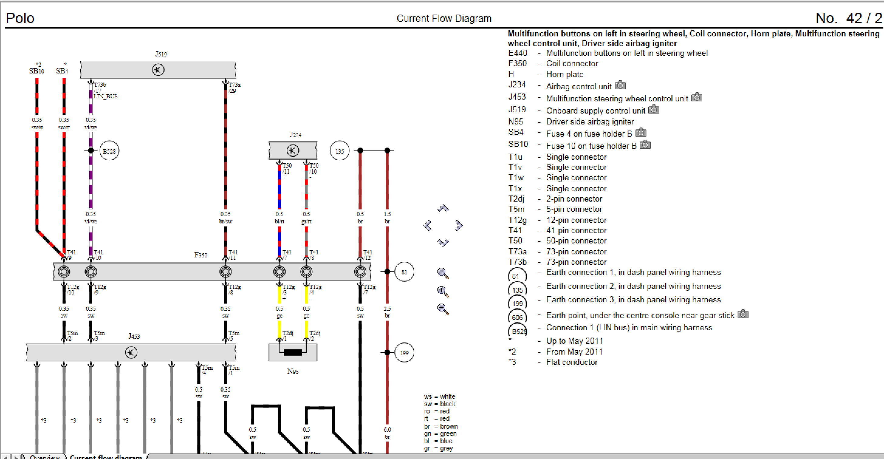

Hi, I have a polo 6r without a multifunctional steering wheel, but I got a multifunctional steering wheel from a friend with a Passat b8 rline 2015. As far as I know, to connect it and make it work, I need to change the bcm. Now the question is for the steering wheel to support mfa and the radio, you only need to connect two wires from the handles to the bcm and I have no idea which cubes to plug them in. I also know that the CCS from the steering wheel needs an emulator. Currently, Bcm 7E0937090C also came to me and I would be very grateful if someone could help me handle it 😅

here is the wiring. for the bcm you might need to do a bcm max conversion.

ok, i'll try it, i'll get back to you when i'm done. One more question I have, the diagram you sent me supports the entire steering wheel because at the top it says only the left side.

doesn't matter, it's the same for left or left+right
