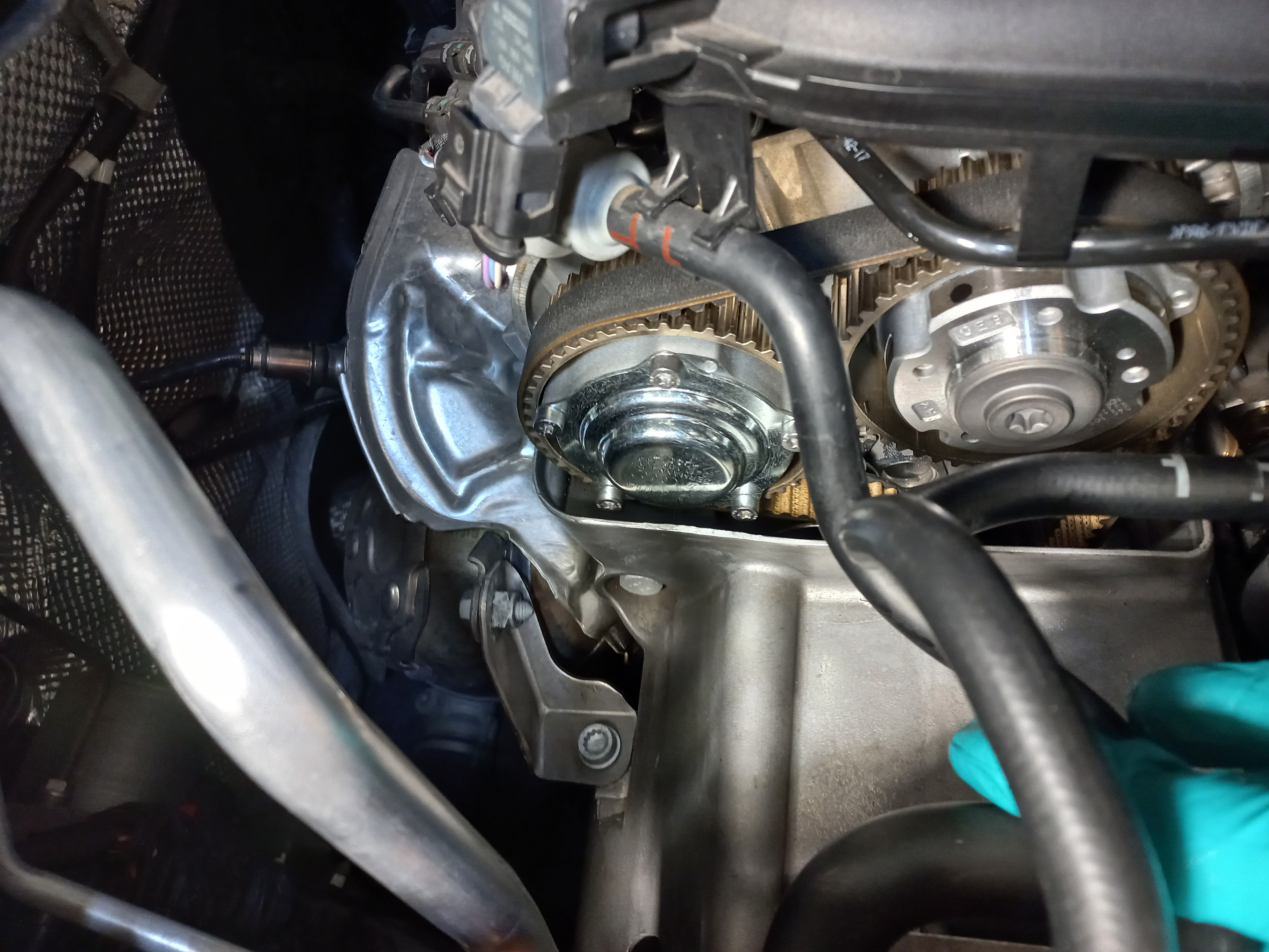

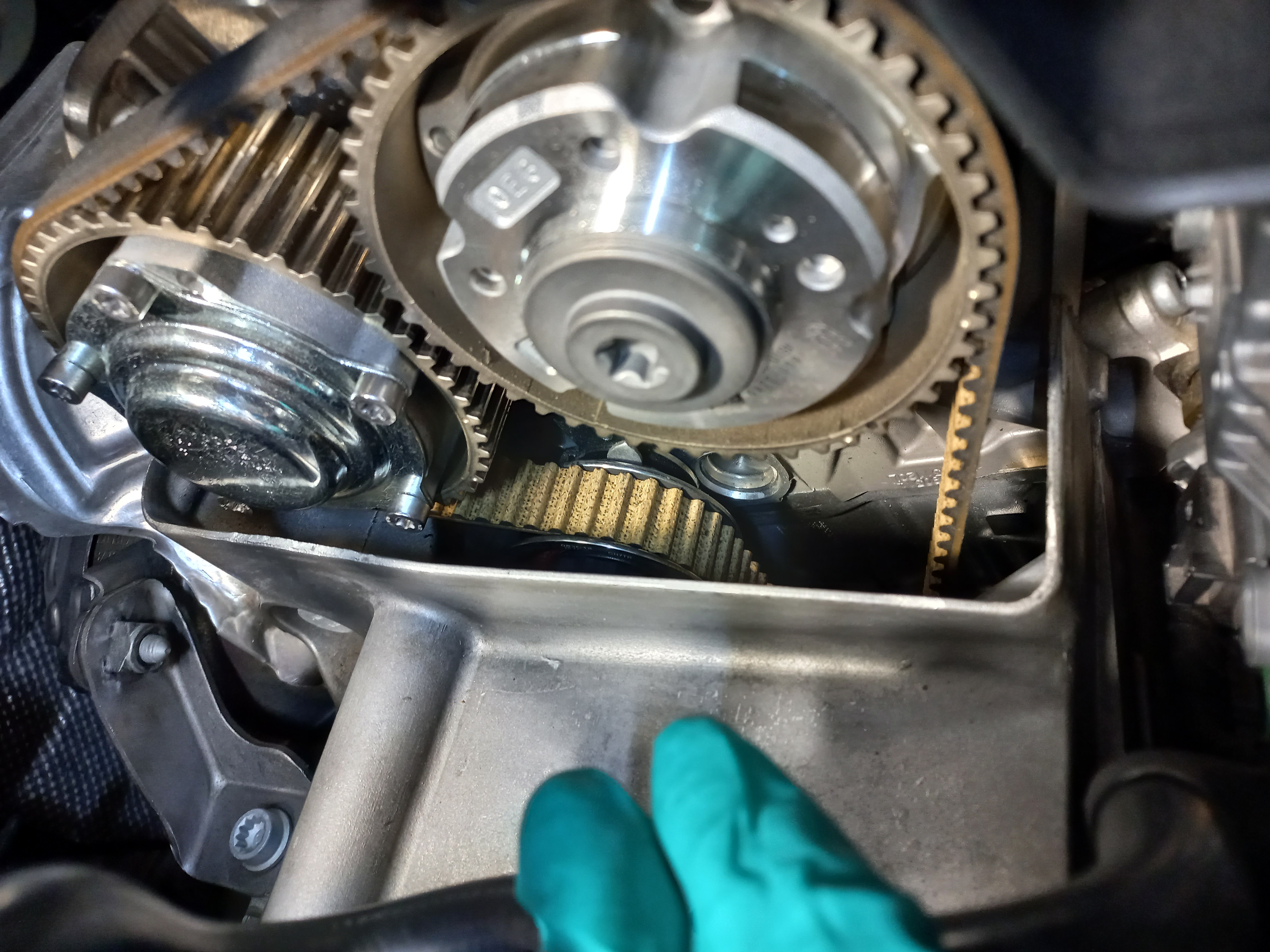

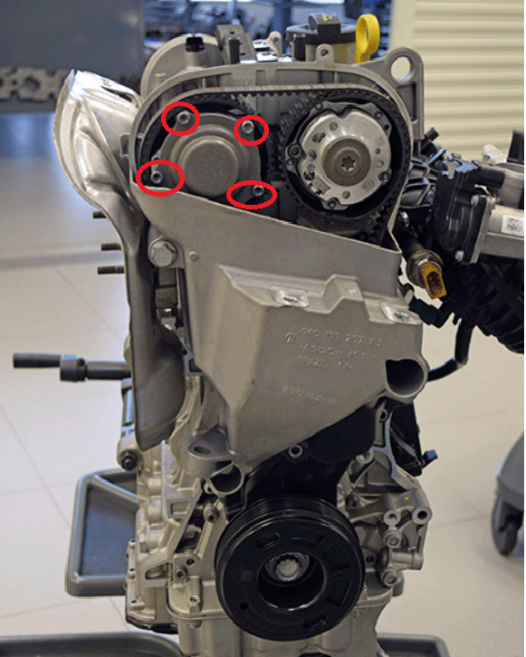

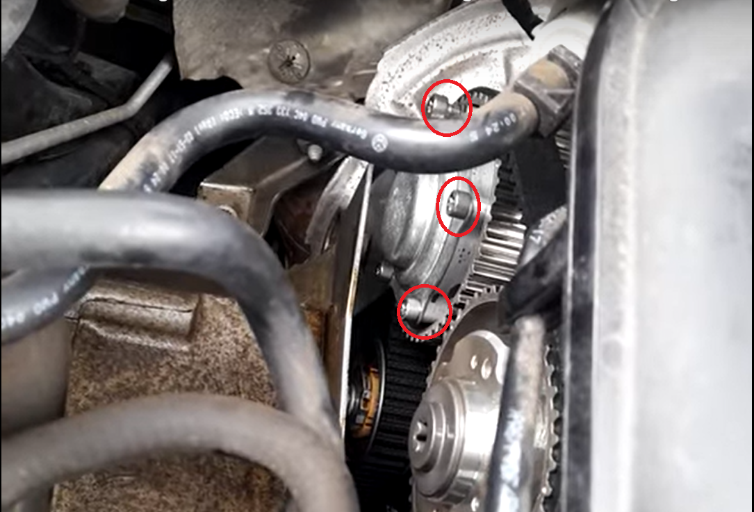

So I went to the mechanic after removing the top cover that covers the timing belt he found the camshaft variator bolts loose. After tightening the oil loss stopped. I post some photos (not mine) to show what I'm talking about. Attention, one of the mechanics told me that this is not the first VW AE211 engine that this has happened in that workshop, mine is the second.

The second image is taken from a footage on youtube where the same problem is reported and the guy cannot identify the problem notice the top screw which is clearly seen to be loose

The 1.2TSI only got variable timing pulley on the inlet cam shaft, and initially some of them also suffered from their screws slackening off - their screws are on the inside face of the inlet cam shaft pulley.
