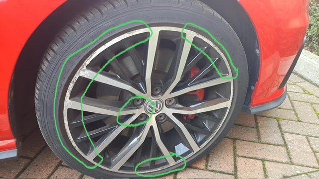

  • Parabolica alloys are diamond cut, and the ‘polished’, diamond cut face of the wheel is susceptible to unsightly white worm corrosion. The bare metal diamond cut face doesn’t provide a good ‘key’ for the protective clear lacquer to bond to, so it only takes a small stone chip to the lacquer, and white worm corrosion can set in under the lacquer. You can see the white worm corrosion on a Parabolica alloy in the picture below.
    When white worm corrosion does happen (it almost always does), the cost of a good quality refurbishment of the alloys to remove it is likely to cost around £90-£100 plus VAT per wheel. Also, as the refurbishment process to remove white worm involves re-cutting the face of the wheel, diamond cut alloys can only be refurbished twice - more than twice and too much metal may be removed from the face of wheel, compromising its structural integrity. Many sets of Parabolica alloys may have already been refurbished once or twice, so always ask a seller how many times they’ve been refurbished as it might not be possible to refurbish them again if they’ve already been done twice. Also ask a seller if any of the alloys have ever suffered structural damage (cracks or buckling) or had any structural repairs that might also adversely affect their structural integrity.
