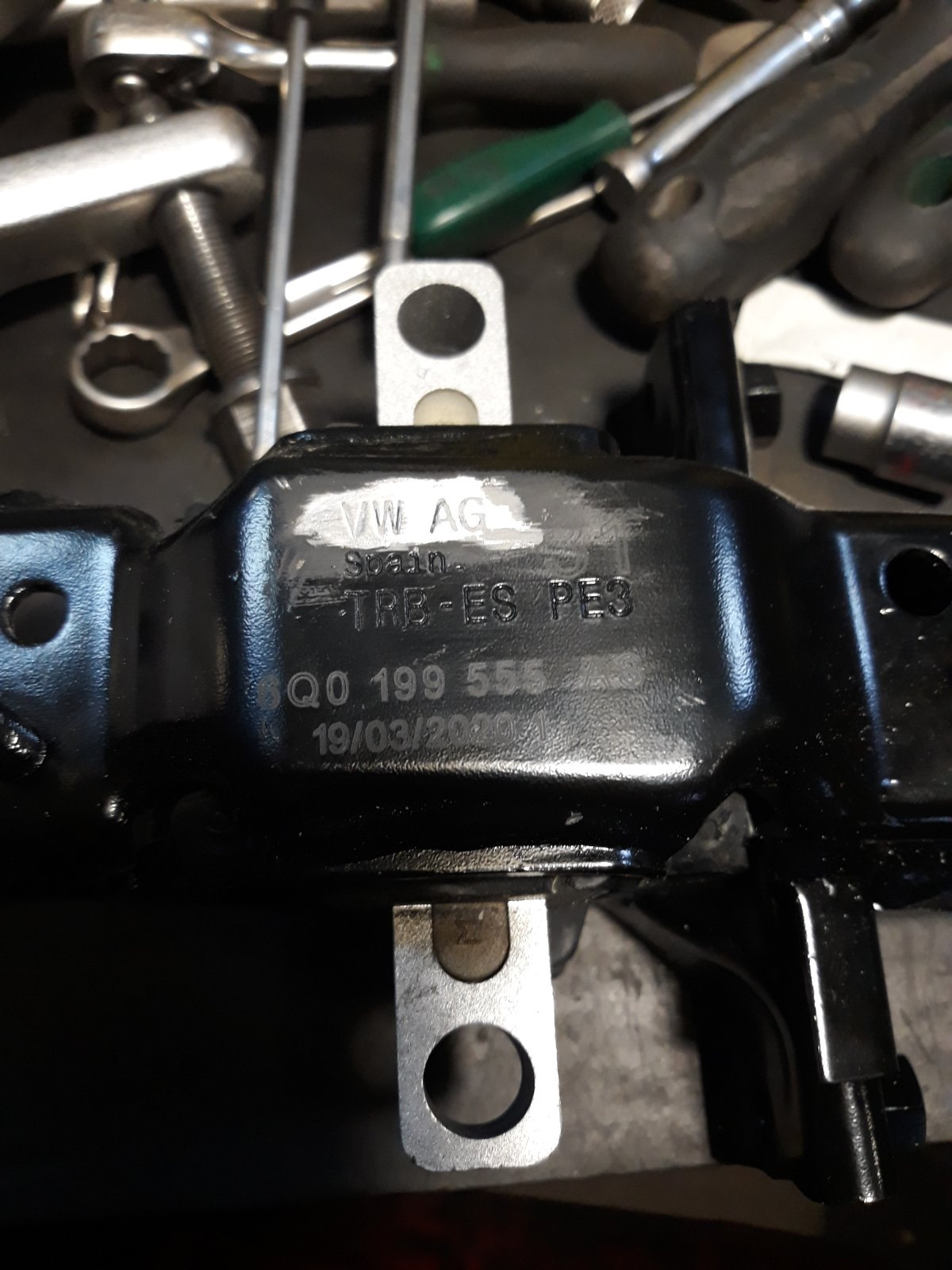

So funny.
Picture found on Drive.ru.
The guy just remove the paste on the part and tadammmm! VW just under.
So yeah, for half the price, you can have the brand new part.
I juste made an order on Autodoc.
Cost me 60 euros.

Brilliant, it must be the raised identifying marks on alloy casting that get just grinded off.

Yes, I don't see why Lemforder will have two expensive tools and machinery just to produce the same part but with and without VW emblem.
Much worth to put past or something over.
