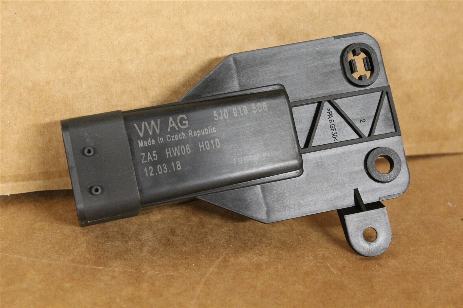

5J0919506 seems to be the J293 module, £30~ on ebay used or £150-£200 from the dealer. Can I use any J293 module that has a matching part number or will it need to be from a car with the same engine?
Is there also anything else which triggers the fans to come on other than coolant temperature, or the air con being switched on?
Am I correct in assuming that the J293 module is what directly controls the fans which is also the relay and that it receives the relevant signals from the ECU to switch on and at what speed?

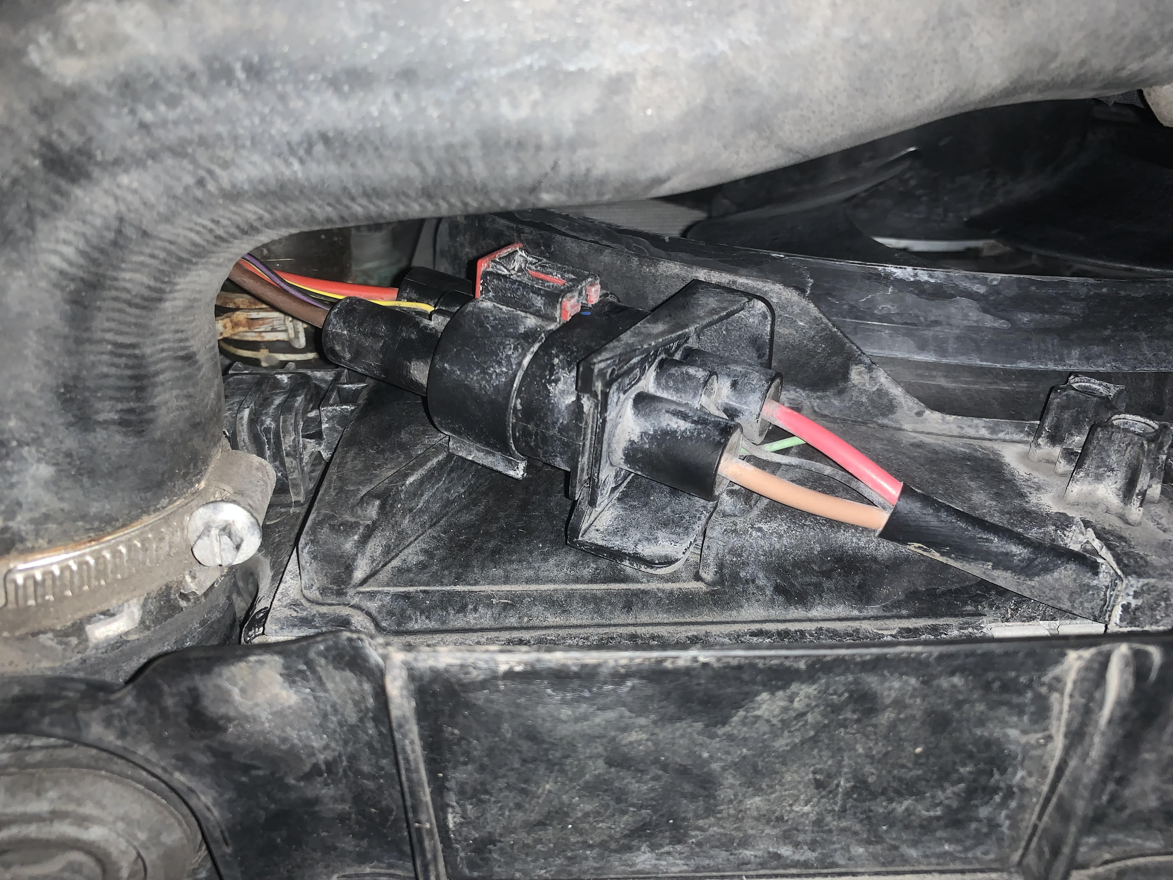

Set out this morning to find the fan control module and I'm fairly certain it's on the radiator fan shroud. However, it's on the other side and sandwiched between the shroud and the radiator.
Fan control module.jpg (2.46 MiB) Viewed 8415 times

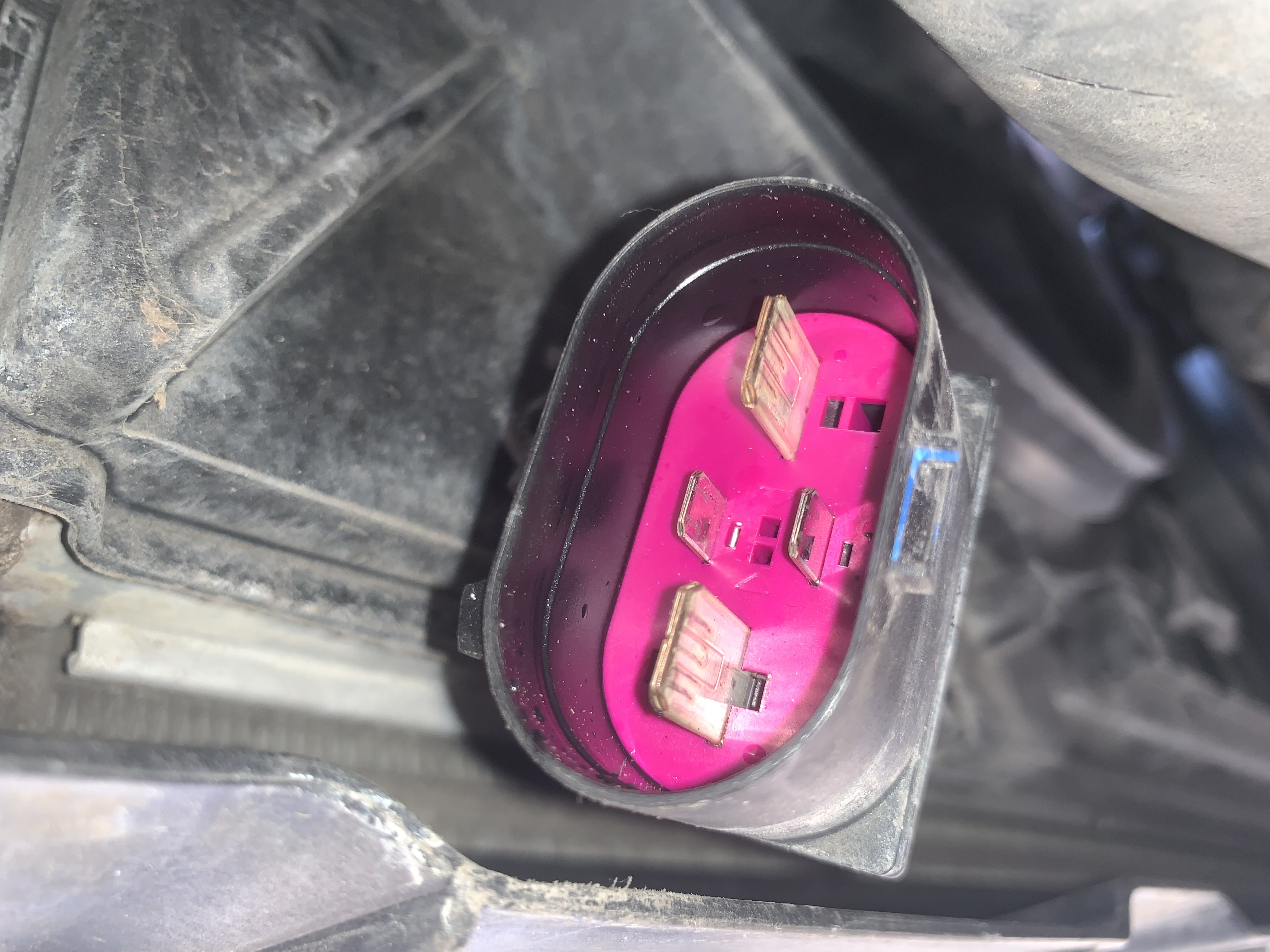

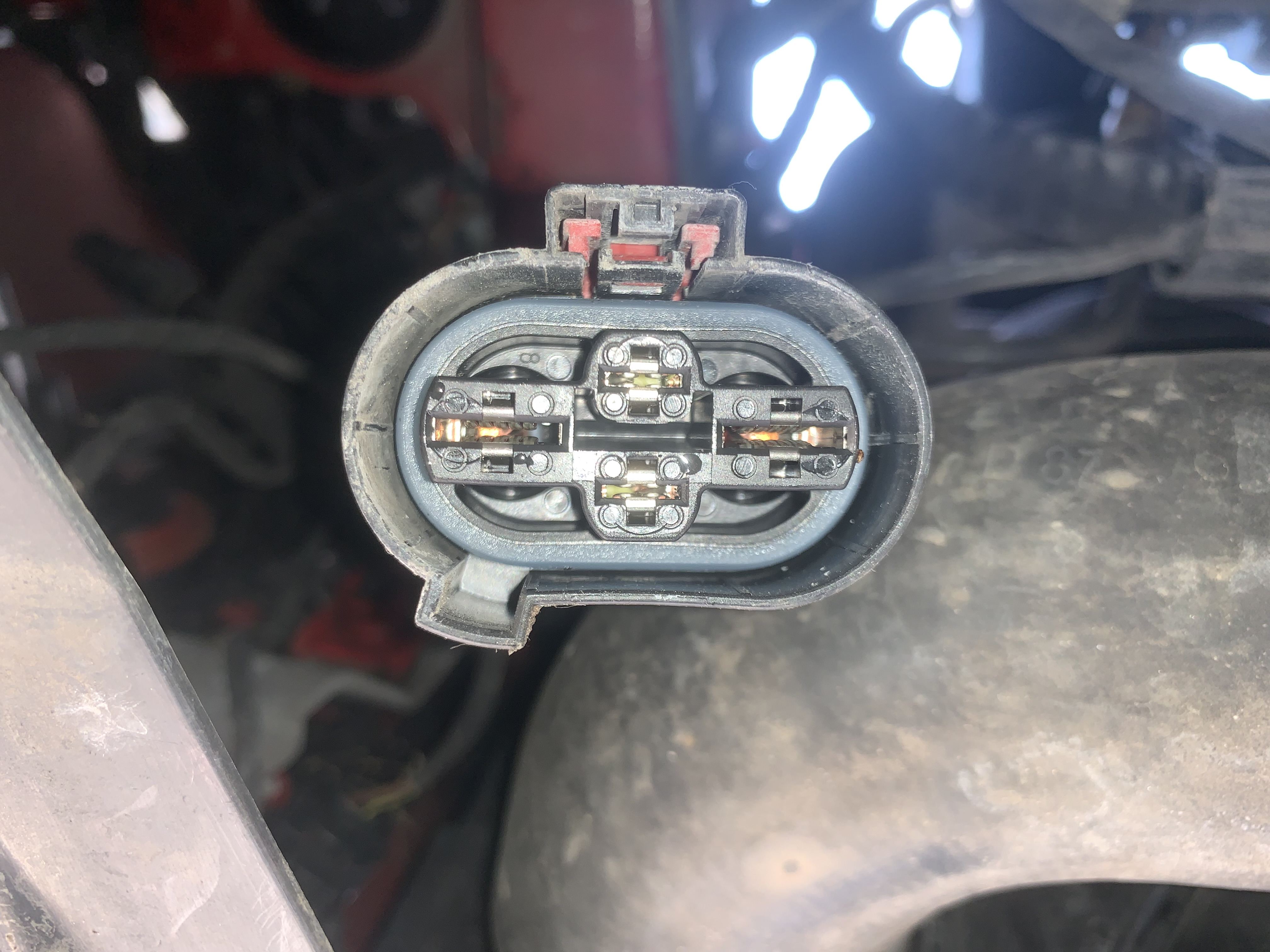

I inspected the plug on the bottom left of the fan shroud and wiring I couldn't see any corrosion or breaks
ECU side fan plug.jpg (2.19 MiB) Viewed 8415 times
Fan pack side plug.jpg (1.95 MiB) Viewed 8415 times

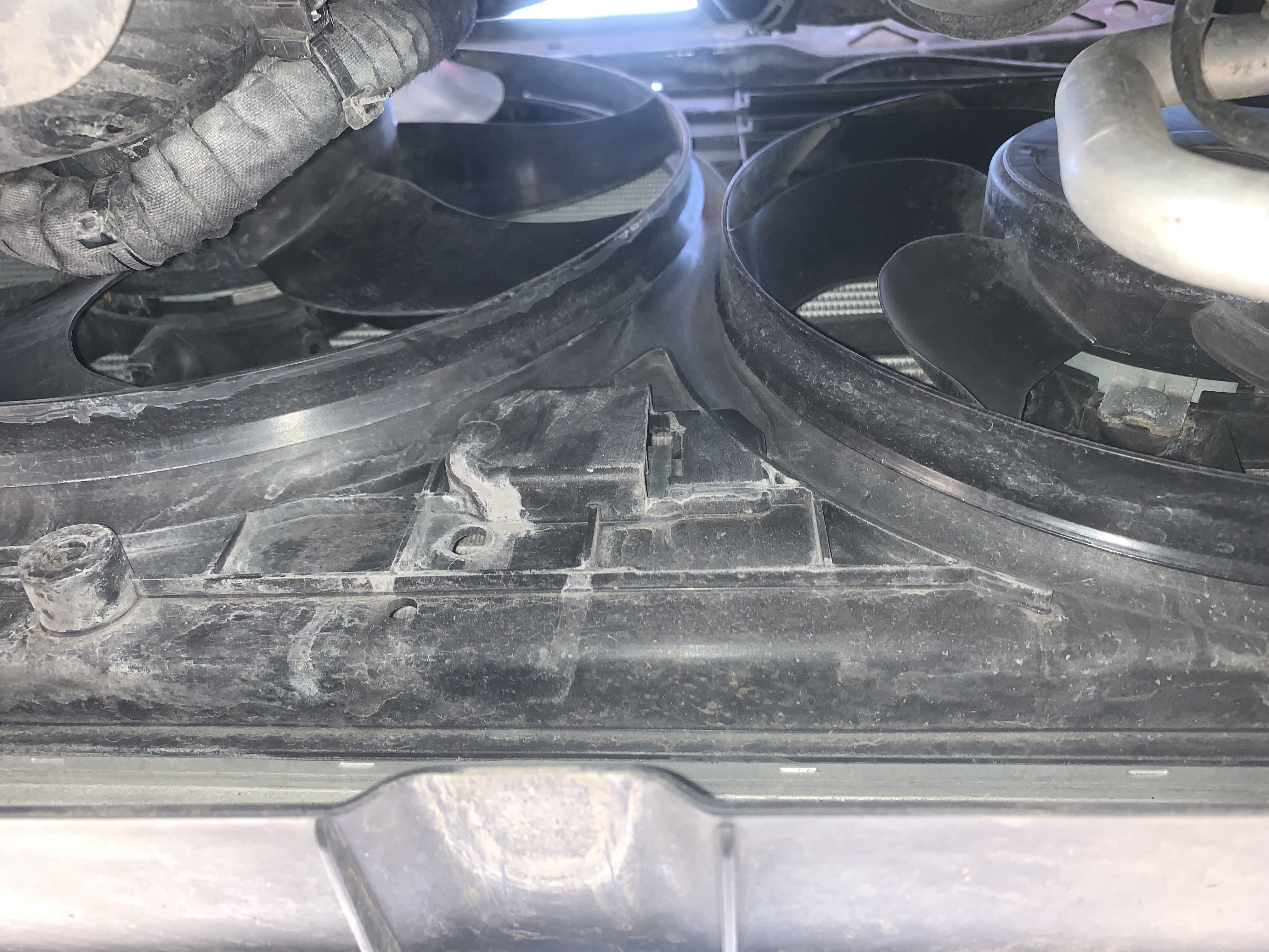

I'm going to look for the fan module again as I don't think it's on the fan shroud but one of the chassis legs instead as I don't think the module (5J0919506) could even fit where I think it is. On top of that pictures of the reverse of these fan shrouds shows nowhere for a module to go, only connectors for fans.
Fan shroud backside.jpeg (245.44 KiB) Viewed 8368 times

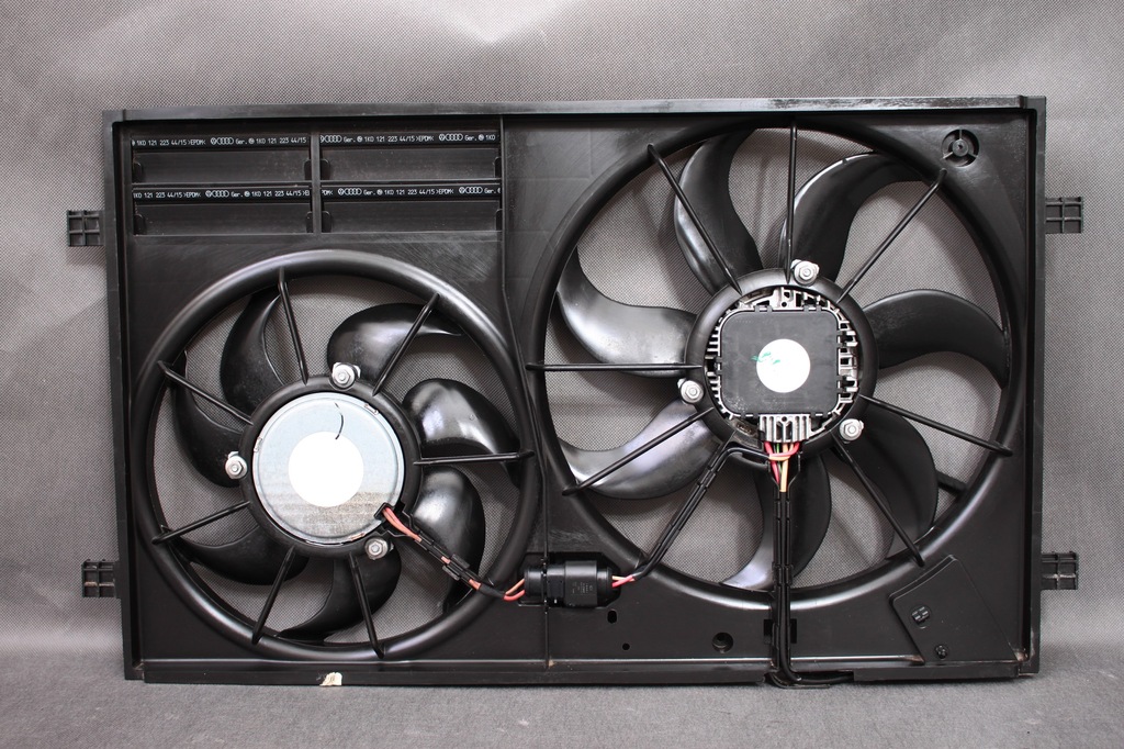

It looks like the radiator fan control unit on the 1.8 is built into the fan itself.
e.g :arrow: https://es.aliexpress.com/item/32940817416.html

Yeah, it seems to be that the module is contained within the primary fan and is starting to fail as I can command it on and off via an output test using VCDS. Fuses 1 (50A) and 18 (10A) in the engine bay have continuity. Fuse 37 in the passenger compartment was also listed as supplying module J293 and it is also fine. So I'm pretty sure power supply isn't an issue.
The behaviour seems to be either the fan gets commanded on then something goes wrong in the module where it doesn't see the off signal from the ECU so keep going until Terminal 15 power is cut when the ECU goes to sleep. Or something goes wrong in the fan control module meaning the ECU can no longer see it so as a failsafe it just signals the fan to come on. I'm just guessing as I can't see any other reason why it would do what it's doing.
However, with the fault code set, I can still output test the fan so the ECU doesn't seem to block the module, and the aircon still works fine. The fans also don't power cycle when I unlock the car or come on as soon as I switch the ignition on.
