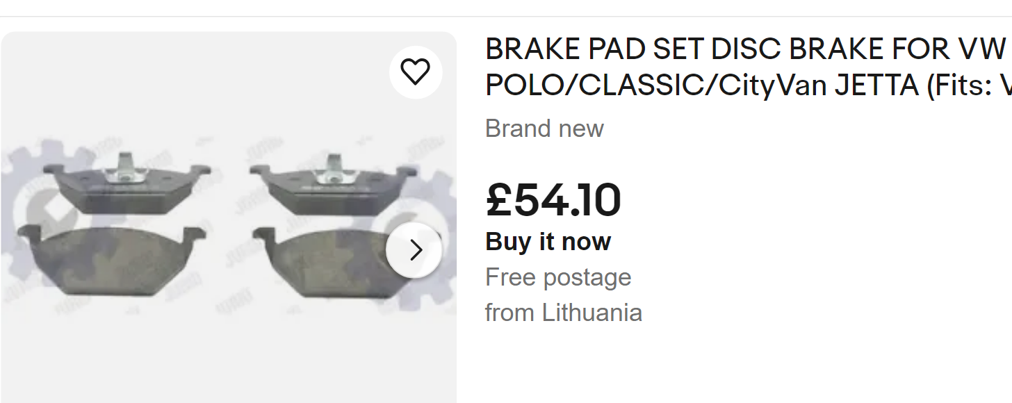

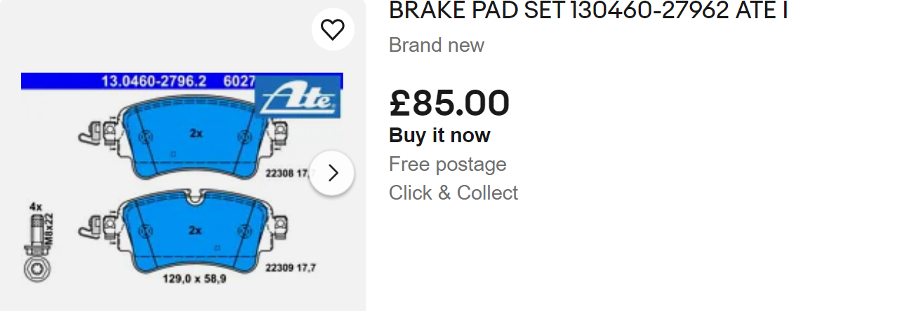

I did some searching recently on what an ATE caliper vs VW caliper looked like.. Some differences ok but not spectacularly so.
however the brake pads are a lot different.. so i have something to go on.
ATE shape
Screenshot 2023-07-16 123900.png (193.92 KiB) Viewed 1294 times
VW
Screenshot 2023-07-16 124158.png (193.79 KiB) Viewed 1294 times
won't need them for a few months till the service but will have a better idea of what type to order.

I think that there is some misinformation going around, as far as I know, VW do not make or brand brake hydraulics, they just used to use ATE - which is just Alfred Teves otherwise known as Teves, or Girling - who were bought over by Lucas and now part of TRW. There is a new source of brake hydraulics for VW Group especially when it comes to their budget range of cars, and that is Mando, they seem to have inherited the ATE part of the supply to VW Group in certain mainly budget end models, it has been said that the pads that fitted the ATE callipers also fit the replacement callipers from Mando.
So from your two pictures, the pads "with wings" are typical of what ATE used to supply into VW Group and the ones with the short but wide stubbier end tags are typical of what Lucas and so TRW supply into VW Group.
Looking in through your wheel spokes should be enough for you to find out which version is fitted to your car, it might boil down to which version of 1.0TSI your car has, ie power output - though that is just a guess as maybe VW Group now have one braking setup that spans all the 1.0TSI power output versions.
