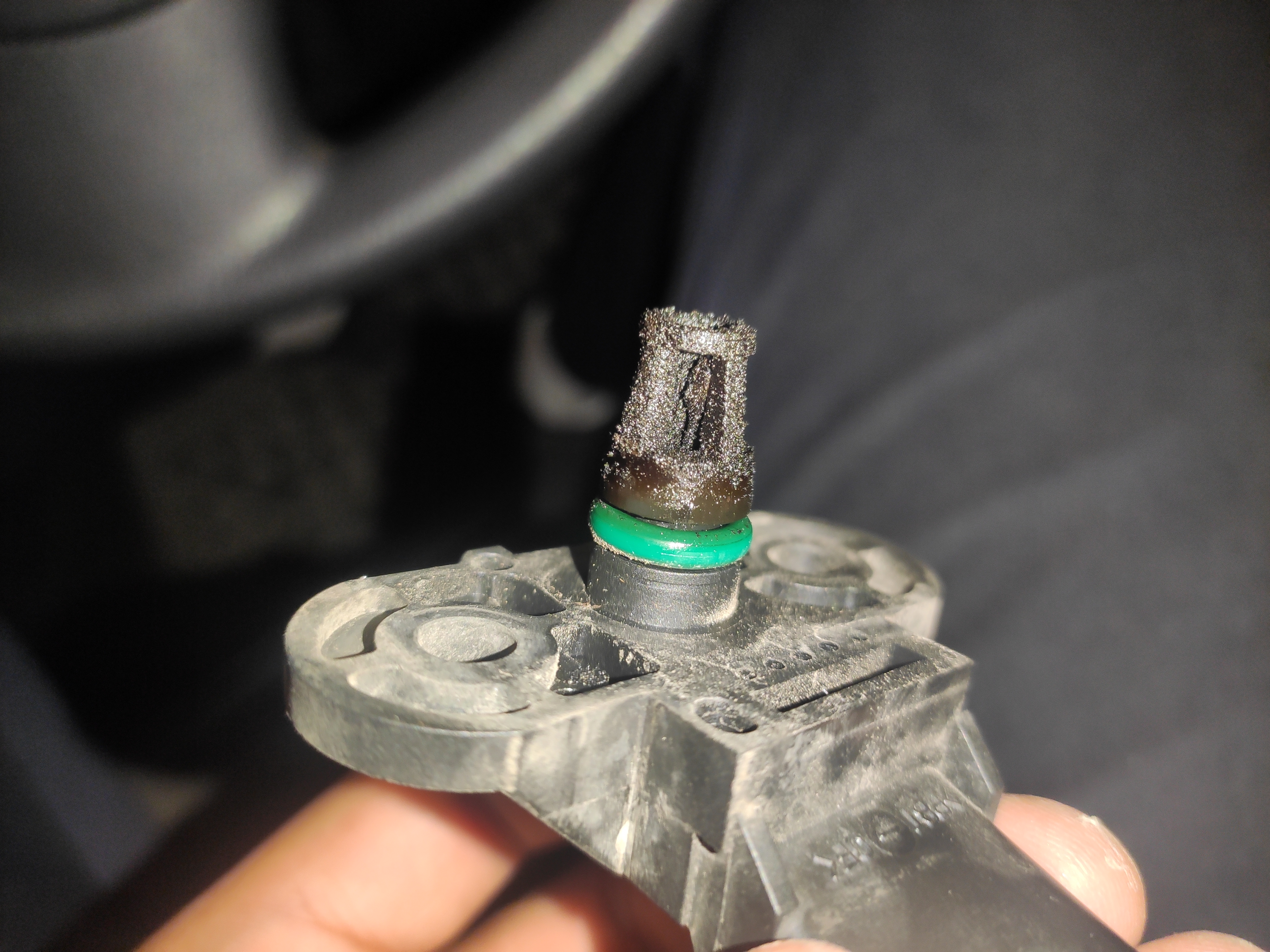

Since I solved the problem I thought I would update the thread in case it might help someone else, turns out the issue was a dirty MAP-sensor.
I initially suspected the throttle body or gas pedal was the cause since it kept throwing up throttle body related codes but I did remove the MAP sensor to take a look and it turns out that the MAP-sensor was completely covered in soot and carbon build up over the years which caused interference. I sprayed it with some electronic parts cleaner and the issue went away almost immediately, it took a few minutes of driving and couple engine restarts for the symptoms to completely disappear and they've not come back since. I did notice a slight improvement when accelerating as the car didn't surge anymore when applying full throttle when joining the highway for instance like it did before and the idle feels a little smoother.
Since the sensor was 20 years old almost I did eventually replace it with a new BOSCH sensor since they only cost roughly 35$ and the new sensor has a different part number compared to the old (new 0 261 230 234 old 0 261 230 095) so likely this is an updated part, didn't notice any performance difference with the new one so I believe the previous one was working fine once cleaned but I replaced it anyways.
